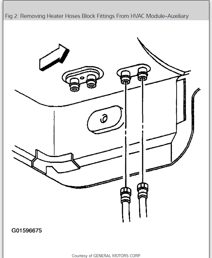

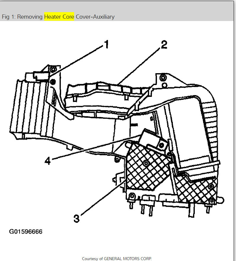

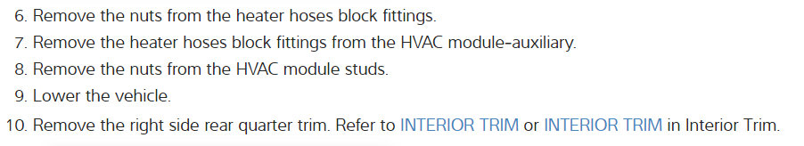

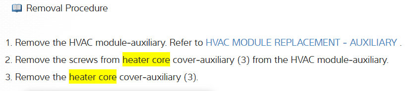

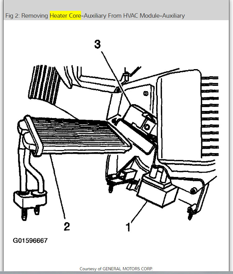

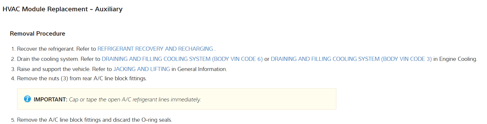

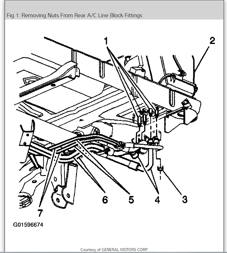

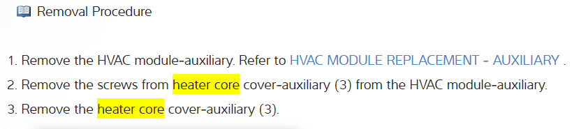

I have included step by step instructions on how to remove your auxiliary heater core. Installation is the reverse of the removal instructions.
Hope this helps and thank you for using 2carpros.
