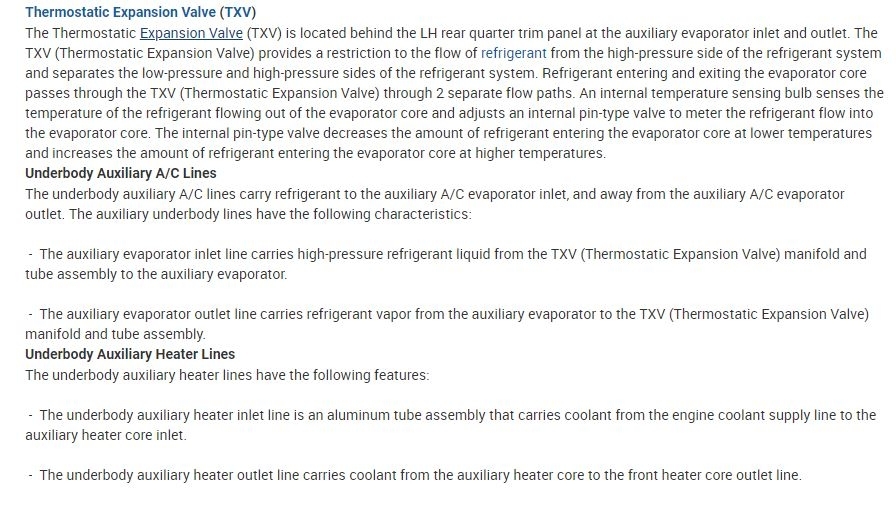

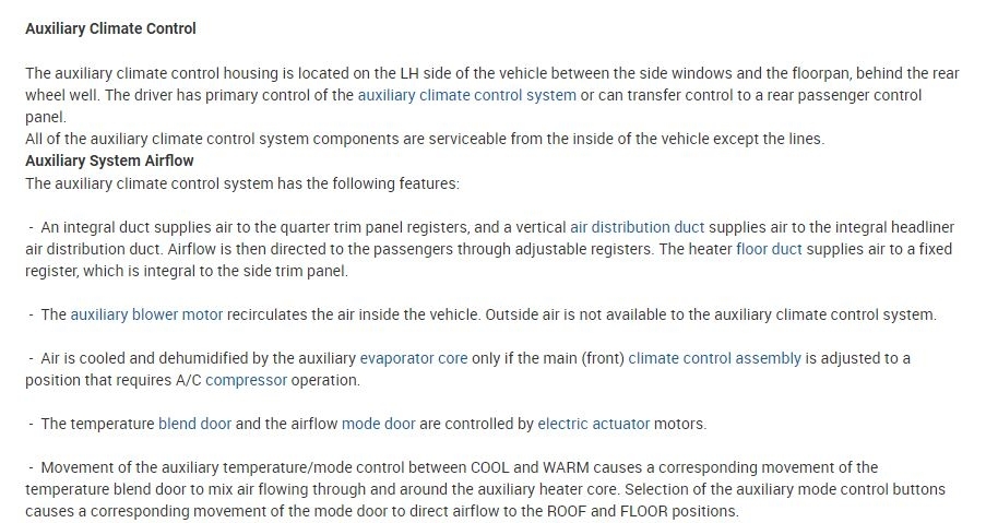

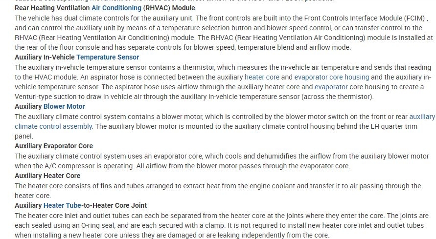

Good morning,
It is that way by design. The heat is sent out the lower vents and the heat rises to warm the back of the truck.
When the A/C is on, the cool air settles once it comes out the top.
You are good to go. I attached the description and operation below for you to view.
