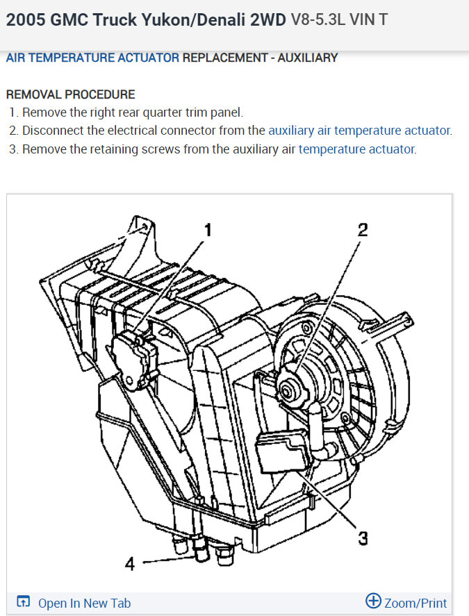

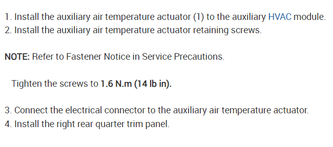

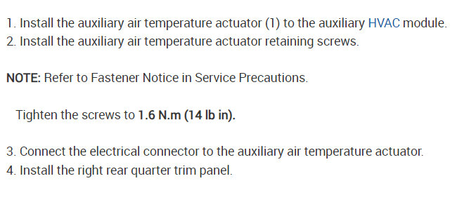

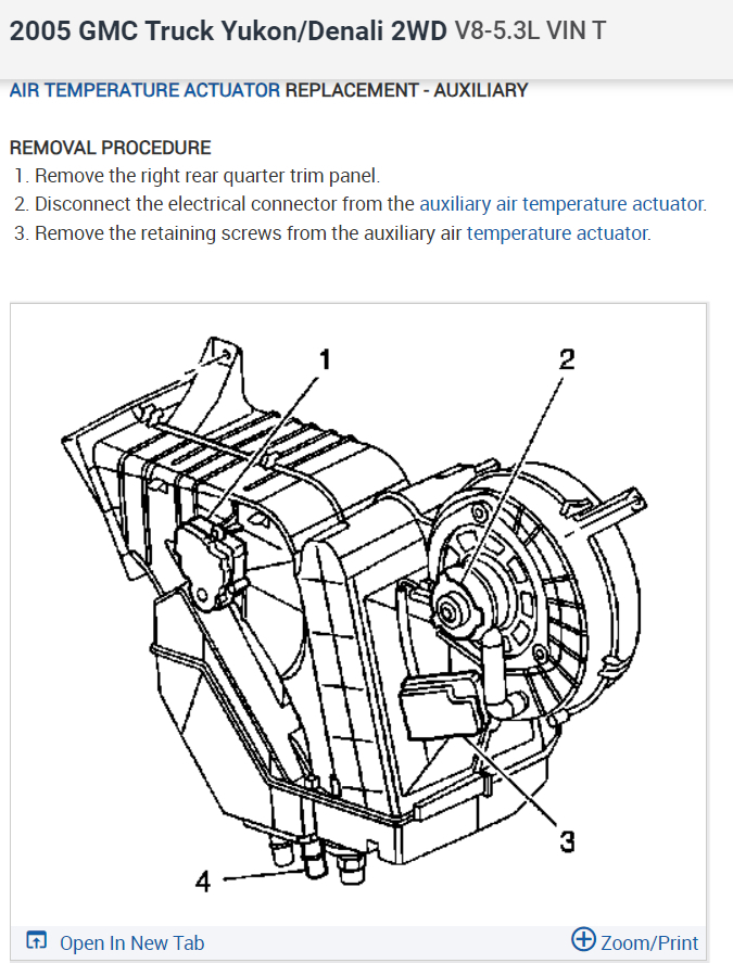

The one you turned with a screwdriver and got heat would be the blend door actuator. Here is the location and how to replace the rear temperature blend door actuator. Check out the images (below). Let us know how it goes
