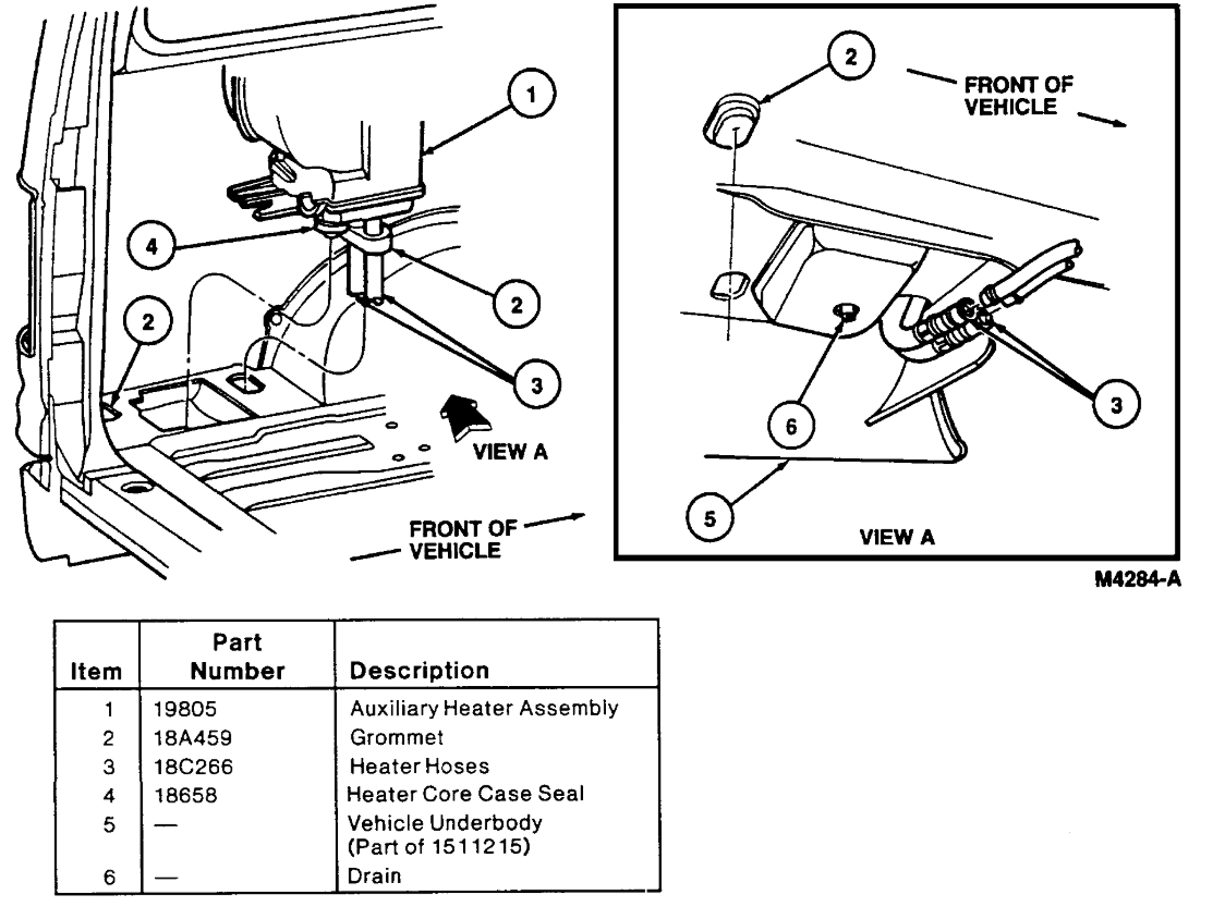

Someone has disconnected the rear heat and AC. Is it hard to fix? Can you just run hose to a good connection spot?
Oct 5, 2018 at 4:55 PM
CERTIFIED EXPERT
53,854 POSTS

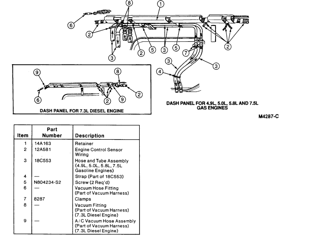

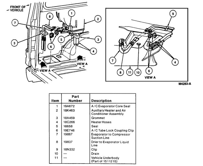

Yep, run new AC and heater hoses and the system should start working just make sure the rear evaporator and heater core are not leaking.
Check out the diagrams (below). Please let us know if you need anything else to get the problem fixed.
