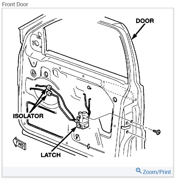

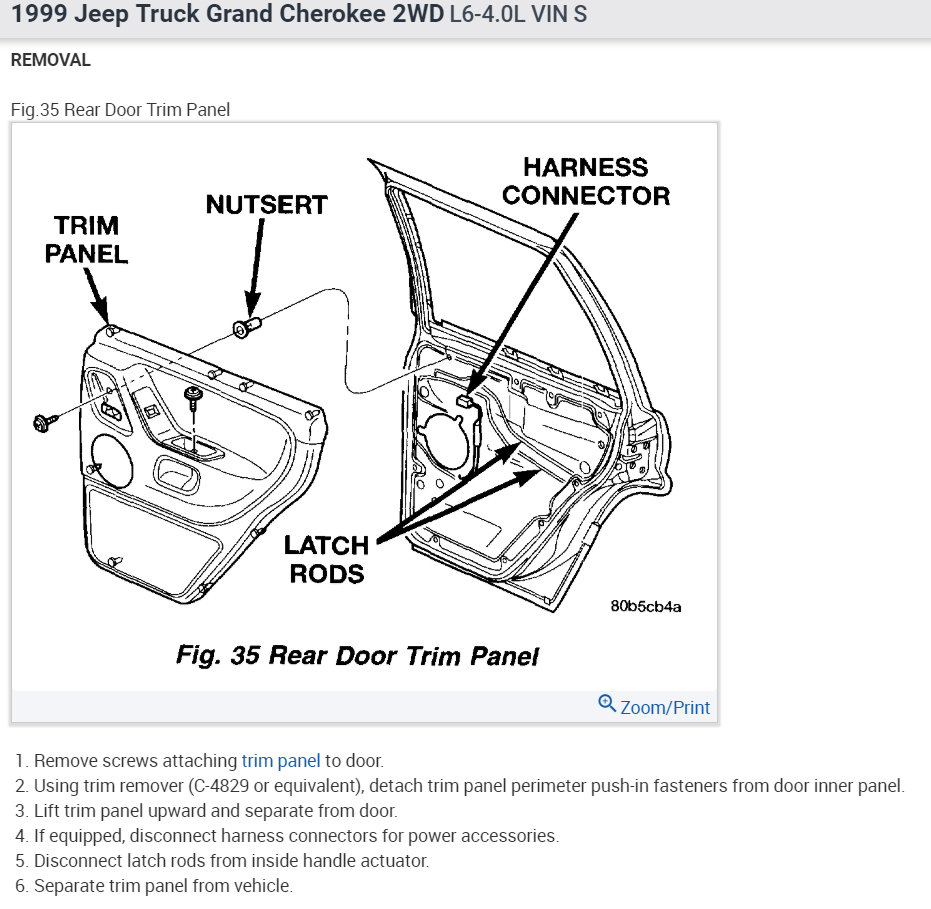

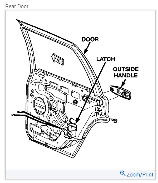

It sounds like the lock actuator is not working but to be sure lets see if it is getting power when you work the locks. Here is a guide to help you see how check both wires:
You must remove the door panel.
https://www.2carpros.com/articles/door-panel-removal
If you have power at the lock actuator replace it with new. Here is how it will be for your car.
