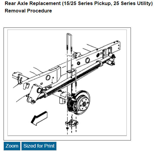

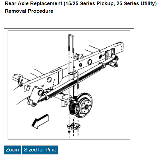

Here are instructions on how to change out the differential with a diagram below.
Raise the vehicle. Refer to Vehicle Lifting.
Place jack or utility stands (such as GMDE 123 B67313) at the front end of the vehicle.
Drain the axle lubricant from the rear axle.
Disconnect the propeller shaft.
Remove the tire and wheel assemblies.
Disconnect the parking brake cable.
Remove the brake line bracket bolts. Suspend the brake lines from the vehicle with heavy mechanics wire.
Remove the brake calipers from the brake caliper mounting brackets. Do not disconnect the brake lines. Suspend the calipers from the vehicle with heavy mechanics wire.
Disconnect the shock absorbers from the axle brackets.
Remove the vent hose from the rear axle vent fitting.
Remove the nuts and the washers from the U-bolts.
Remove the U-bolts, the spring plates and the spacers form the axle assembly.
Lower the axle assembly.
