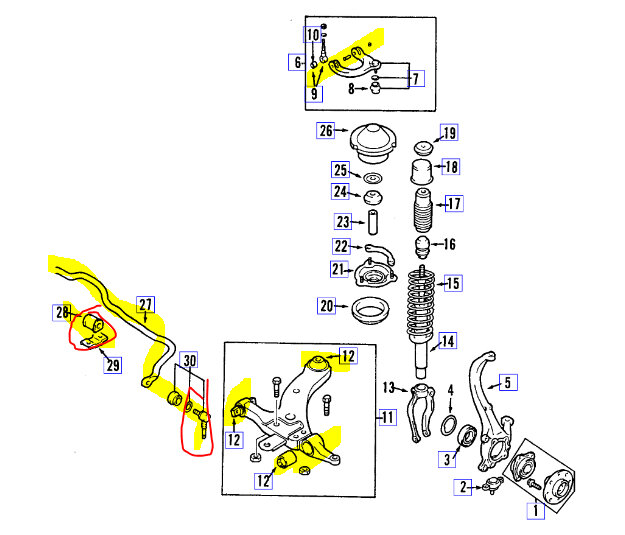

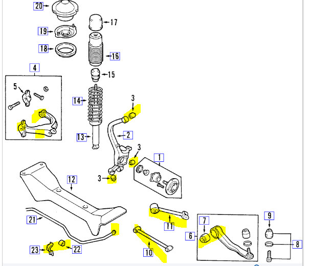

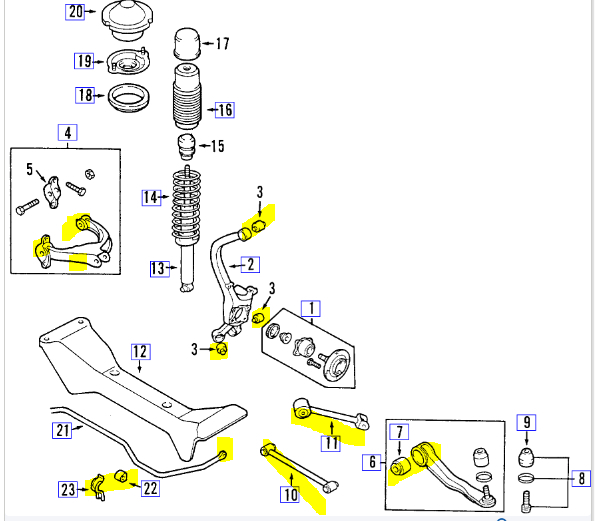

If you look below, I attached two pics. One is an exploded view of the front suspension and the other is the rear. I highlighted things to check that can cause a sway. Keep in mind, weak or faulty shocks can do that as well.
Let me know what you find,
See pics below.
