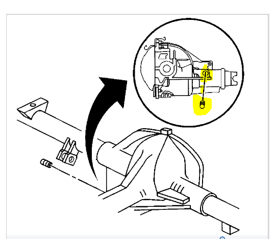

Also, have you checked to make sure the fluid is full in the differential? There is a fill port on it. It's on the passenger side inner portion of the differential housing. Usually, all you need is a 3.8" ratchet to open it. The gear oil should be to the bottom of the opening when the fill plug is removed. If you haven't, check that. See pic below
See pic below.
