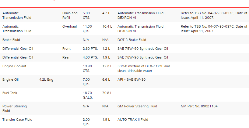

Hello again
The 4x4 transfer case requires oil changes as well.That is what couples the front and rear differentials together when the 4 wheel drive is engaged.Have you performed routine service on the differentials as well as the transfer case? Your cars specifications are below.Hope this helps and thanks again for using 2CarPros.
Danny-
Jan 25, 2019 at 1:46 AM
