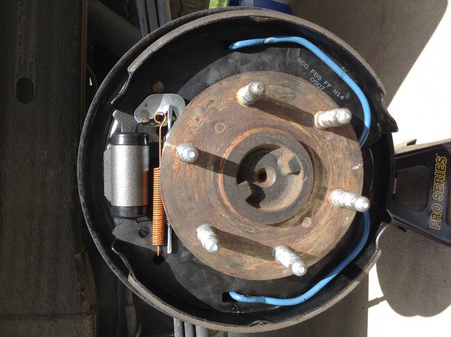

rear brake shoes I did not see where the small clamp goes
2007 GMC SIERRA
82,000 MILES • 1.3L • V6 • 2WD • AUTOMATIC
ABMUNOZ

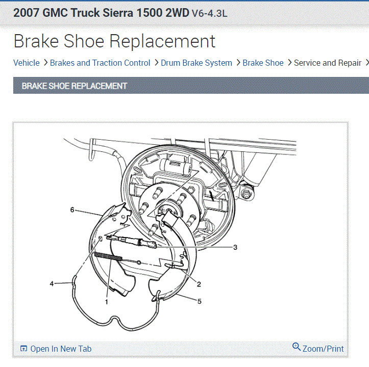

When I took the original break I did not see where the small clamp goes?

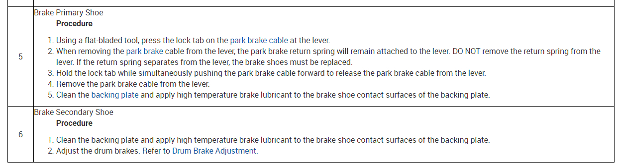

Replacing the brake shoes and drums is a little more involved than disc brakes, but it really isn't too hard if you take your time. You can expect rear brake shoes to last approximately 30,000 miles. Make sure you get lifetime replacement parts so you don't have to pay for them again.
To get you started, here is a link that shows in general how it is done:
https://www.2carpros.com/articles/how-to-replace-rear-brake-shoes-and-drums

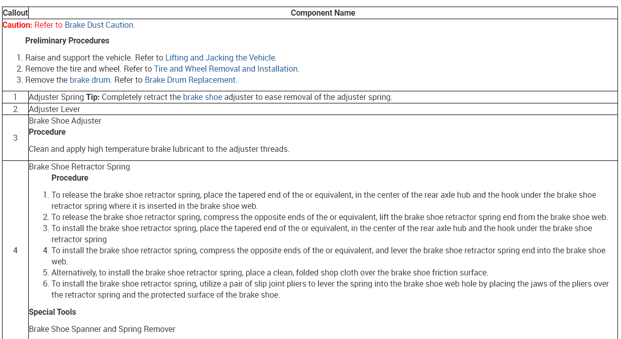

If you look at the attachments below, they include the directions and pictures specific to your vehicle for replacement.
I hope this helps. Let me know if you have other questions.
