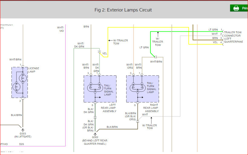

I'm attaching a wiring diagram for the rear tail/turn signal circuit. It shows as a green wire.Let me know what happens after you splice reconnect. Here is a tutorial for you about wiring if needed:

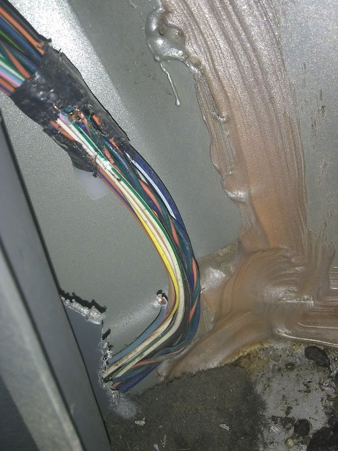

I wonder why the wire color is different. Here's a picture of the damaged wire (there may be more, I haven't gotten too deep into it yet).

Well hmm, if I zoom in real close, it looks like a green wire might be damaged, too. The light blue wire is missing a 4 or 5 inch section, so there's no question there.

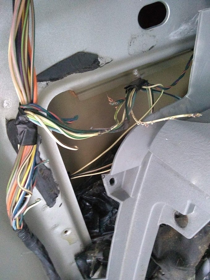

Thanks, Danny. After digging deeper, that was the tip of the iceberg. There were several other wires behind the wall panel that had been severed by the little bugger. Overall, I think there were nine different wires and 13 or 14 different splices that I had to do (some were chewed up in multiple places far apart from each other).
After I did all the patches and the connections were made everything was back to normal. I think it took about four hours overall and a little cursing, but beats paying the repair bill.
