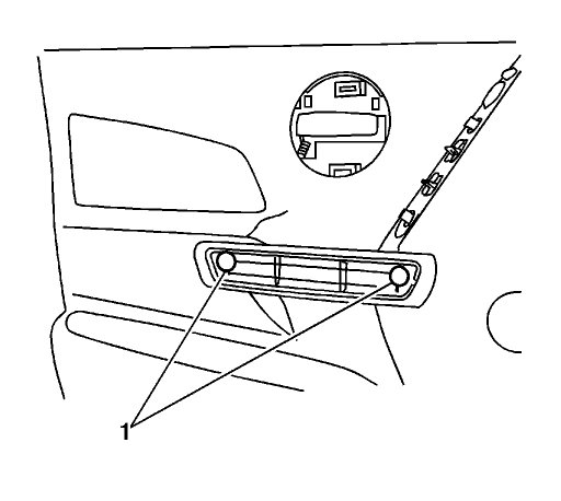

Use a flat-bladed tool to remove the cover plate from the armrest pull handle (first image).
Using a thin walled socket, remove the screws (1) from the pull handle (second image).

Third image just for panel view on clips. Good luck and hope instructions help.
