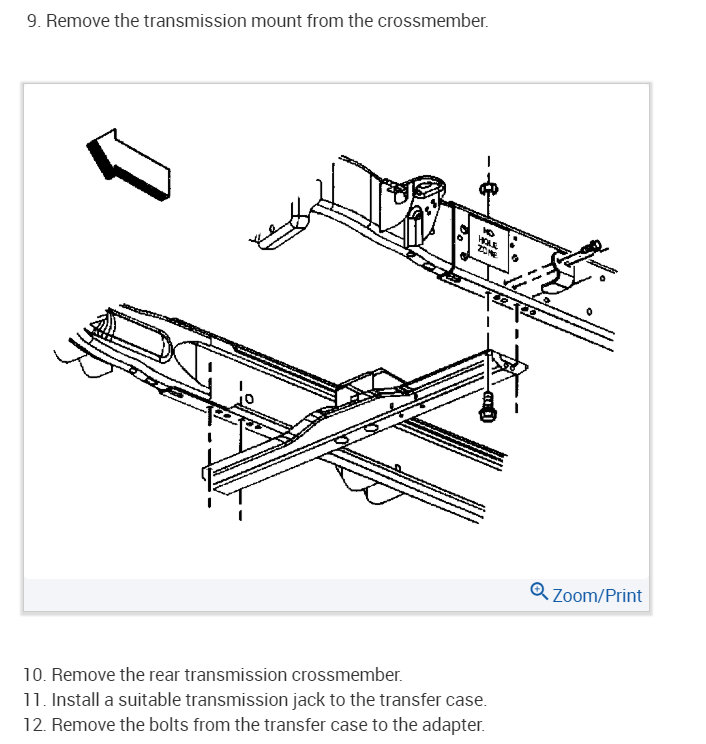

The gasket from the transmission to the differential is wearing in one spot causing a ATF leak. I replaced the transmission and the gasket twice? What is causing that? Also the transmission and differential adapter is cracked like the old one also leaking ATF. I have not been doing any mudding or rough driving other then long distance for work. Found out I have a steel drive line and it is suppose to be aluminum. Could that cause the crack in the adapter and the gasket being worn?
Oct 14, 2020 at 2:42 PM (Merged)

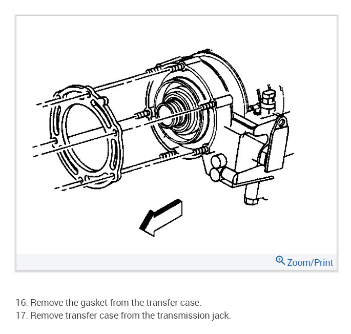

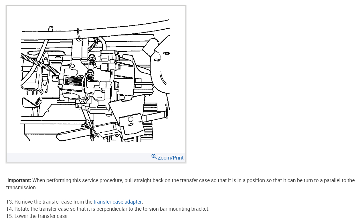

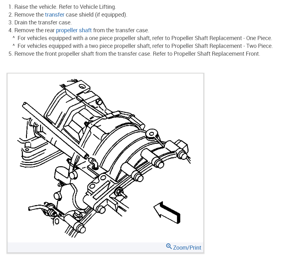

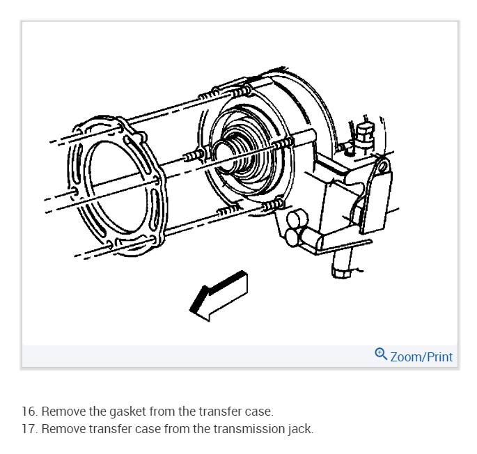

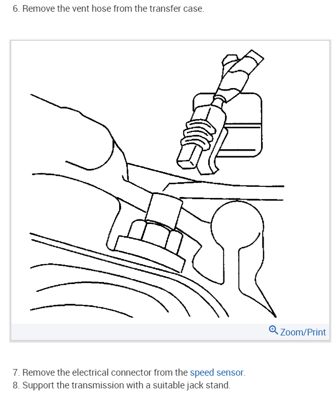

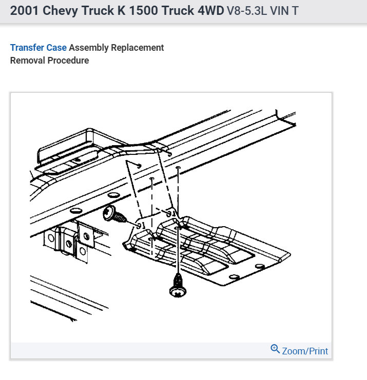

I have a quick question, do you mean the transfer case not the differential? If so there are shaft seals meant to hold the fluid in the gasket is not meant to. I think there is even a relief that allows the fluid to leak out when these seal leak. Can you upload a picture of the location of the leak so I can send instruction on how to fix?

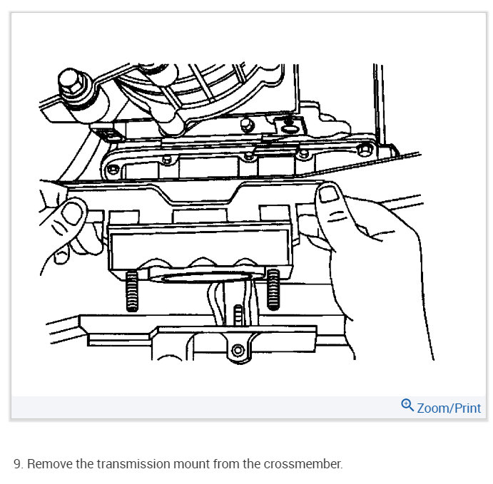

If something is cracked that is not good. If you can get a picture for us we can get you the repair procedure. I just need to see what you are talking about, but if it is what I think it is here are the diagrams to help you get it fixed.
Check out the diagrams (below). Please let us know what you find.
