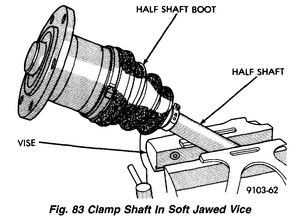

If it doesn't, unbolt the axle at the differential (see attache picture). See if you can then turn it.
Let me know the results.
