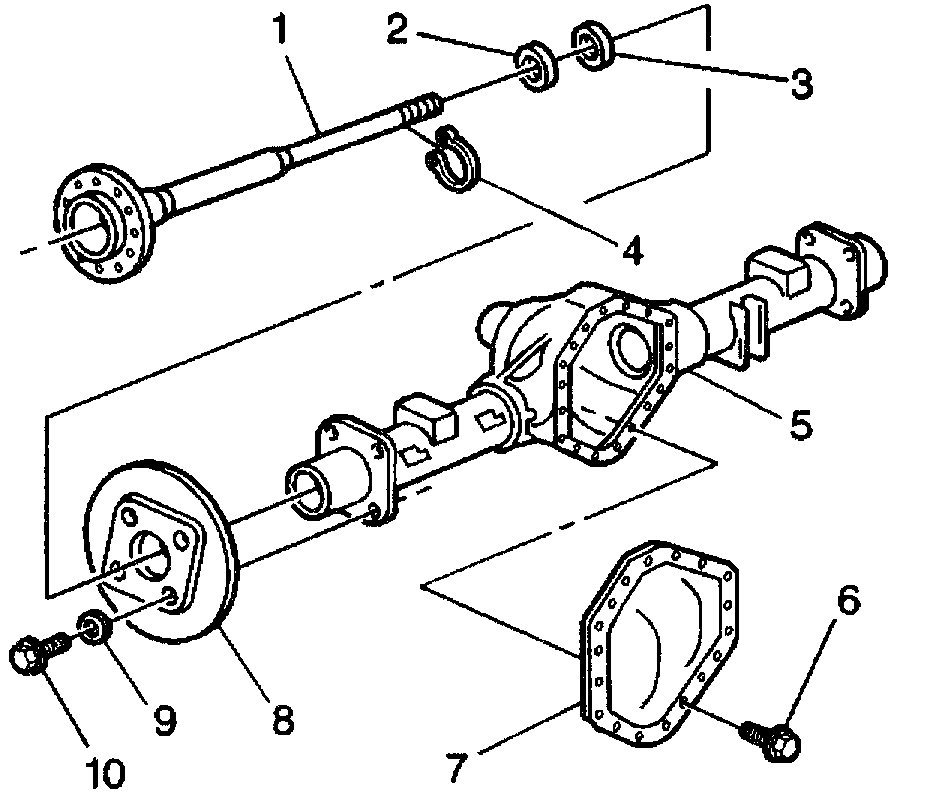

Rear Axle Shaft Replacement
Removal Procedure

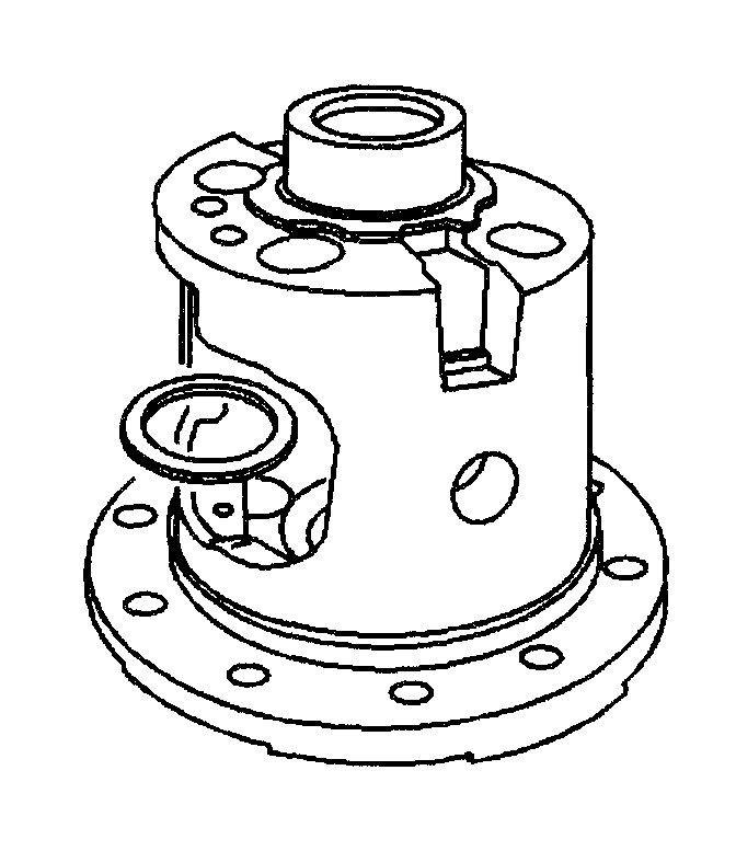

pic 1
1. Raise the vehicle. Refer to Vehicle Lifting.
2. Remove the tire and wheel assembly.
3. Remove the brake caliper.

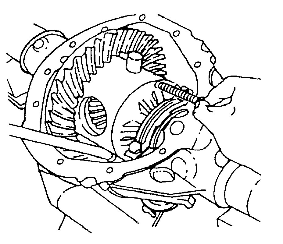

4. Remove the rear cover and the gasket.

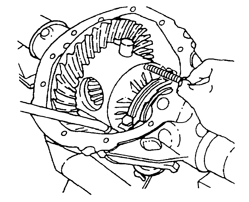

5. Remove the pinion shaft locking bolt.

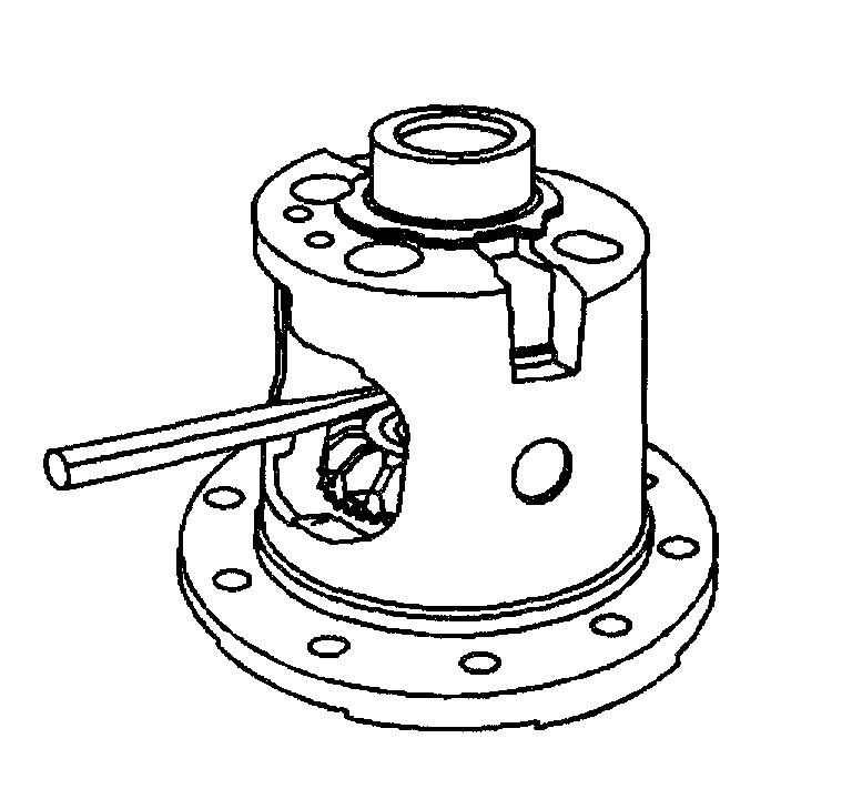

pic 2

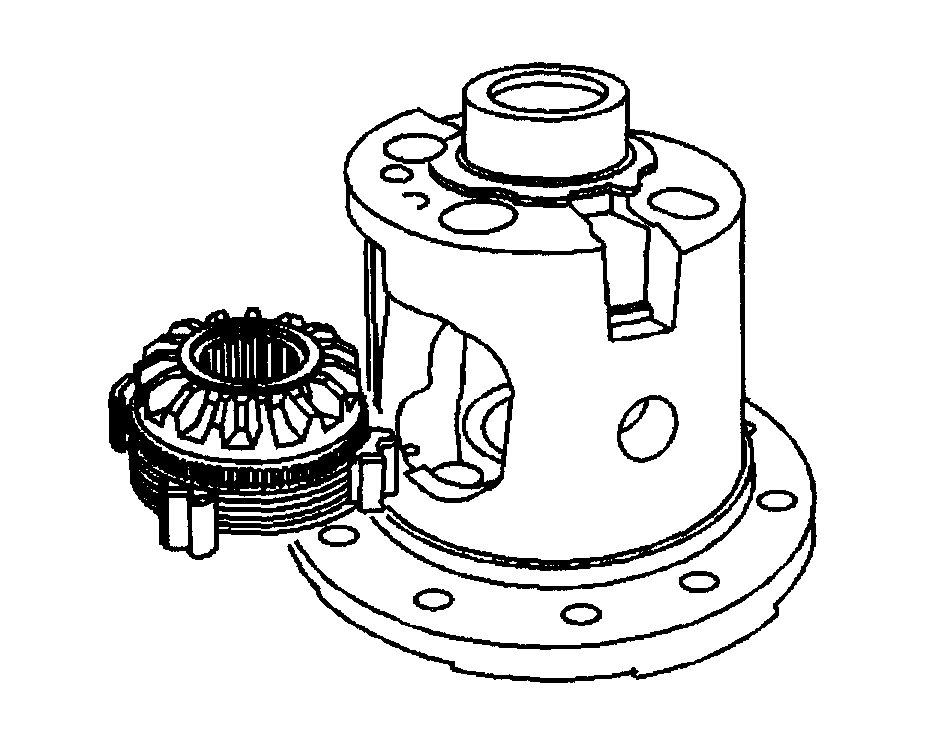

6. On axles without a locking differential, remove the pinion shaft

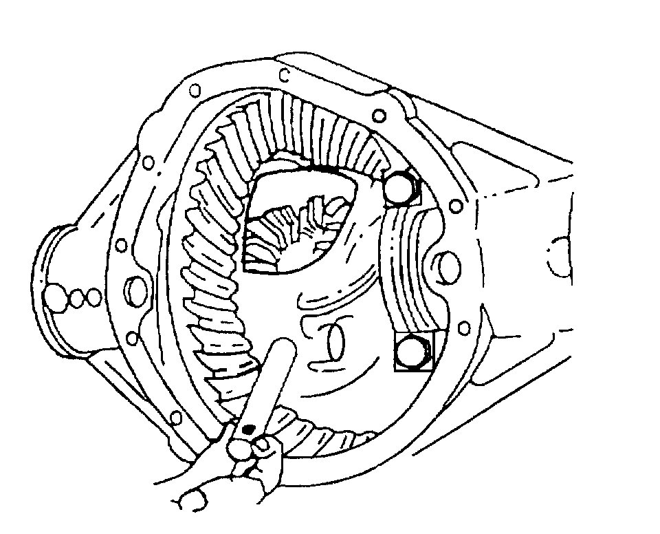

pic 3

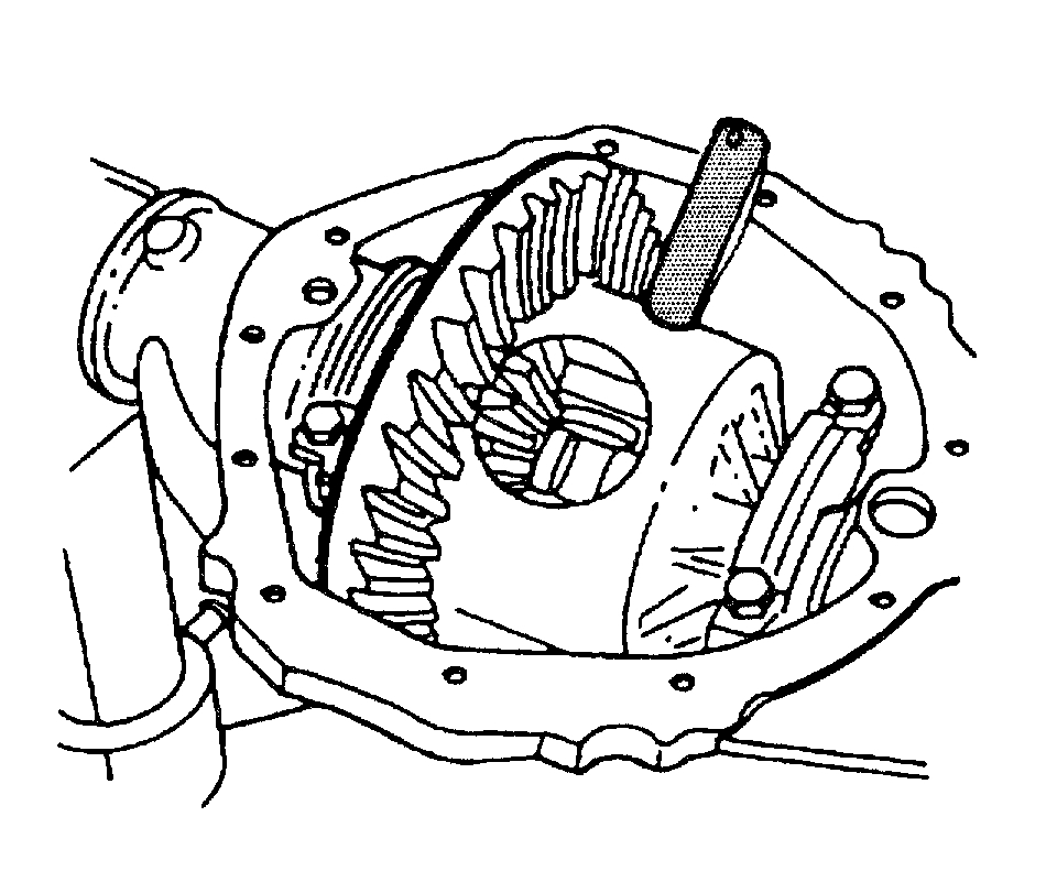

7. On axles with a locking differential, remove the shaft part way. Rotate the case until the pinion shaft touches the housing.

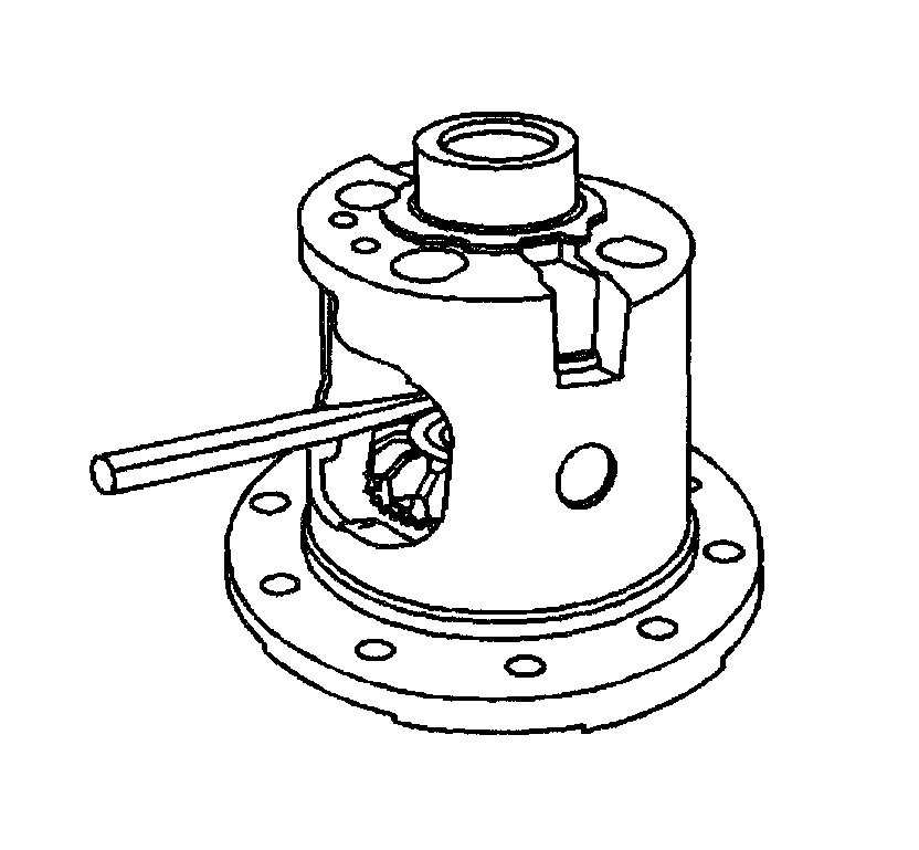

pic 4

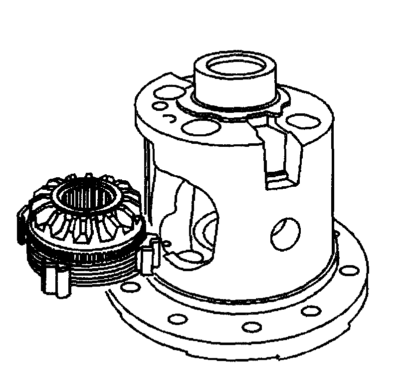

8. On axles with a locking differential, use a screwdriver, or a similar tool, in order to enter the differential case and rotate the lock (1) until the lock aligns with the thrust block (2).

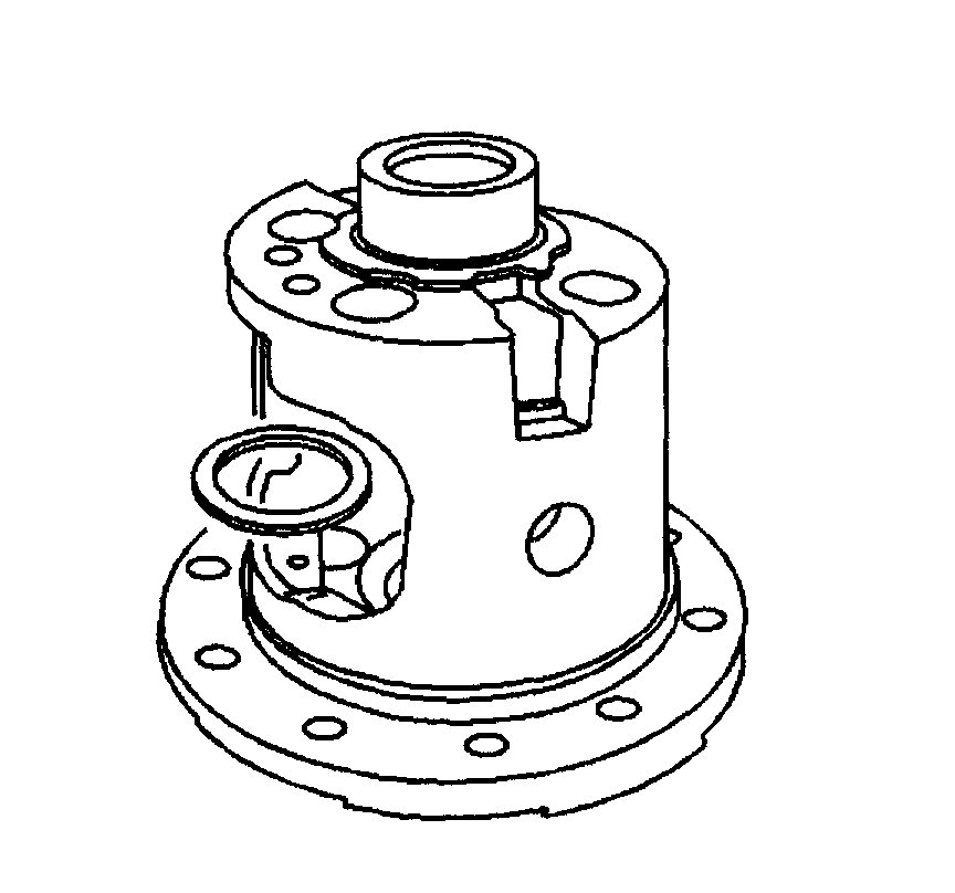

pic 5

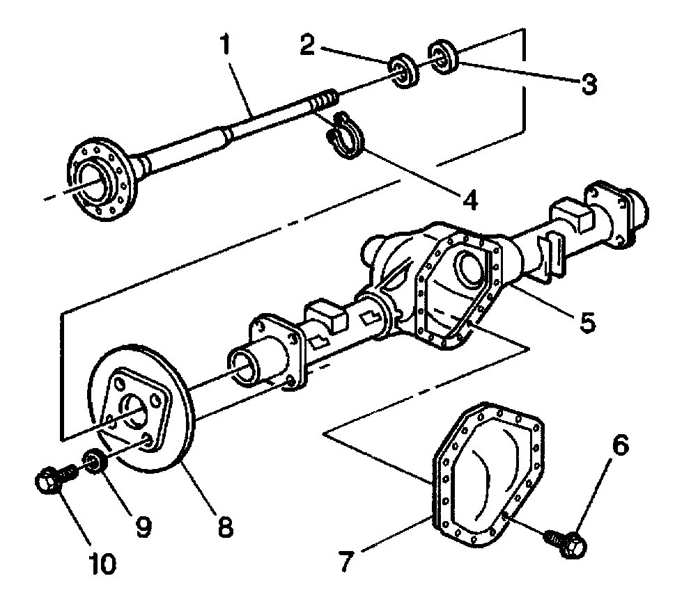

9. Push the flange of the axle shaft (1) toward the differential.
10. Remove the C-lock (4) from the button end of the axle shaft (1).
Important: When removing the axle shaft, do not rotate the shaft. Rotating the shaft will misalign the gears. Misaligning the gears will make the assembly difficult.
11. Remove the axle shaft (1) from the housing (5).

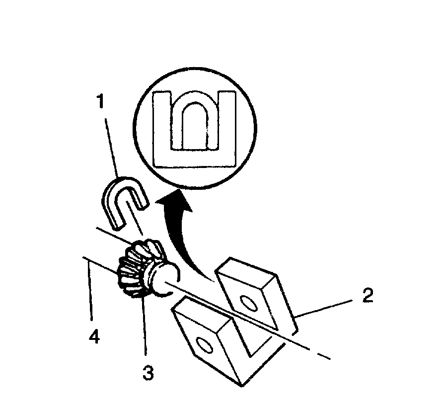

Installation Procedure

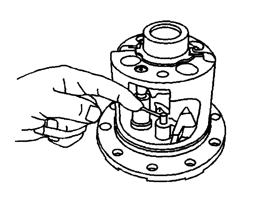

pic 6
Important: Carefully insert the axle shaft in order to not damage the seal.
1. Install the axle shaft (1) into the rear axle housing (5).
2. Slide the axle shaft (1) into place allowing the splines to engage the differential side gear.
3. On axles without a locking differential, place the lock (4) on the button end of the axle shaft (1).
4. On axles with a locking differential, keep the pinion shaft partially withdrawn.

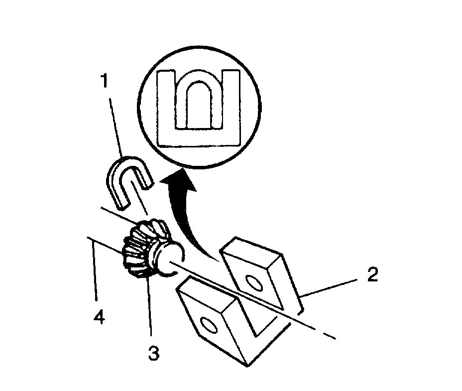

pic 7
5. On axles with a locking differential, place the C-lock (1) on the axle shaft (3) so that the ends are flush with the thrust block (2).
6. Pull the shaft flange outward in order to seat the lock in the differential gear.

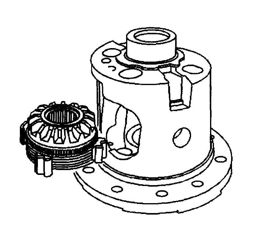

2. Install the left side gear (cam unit) and clutch pack assembly into the differential case.

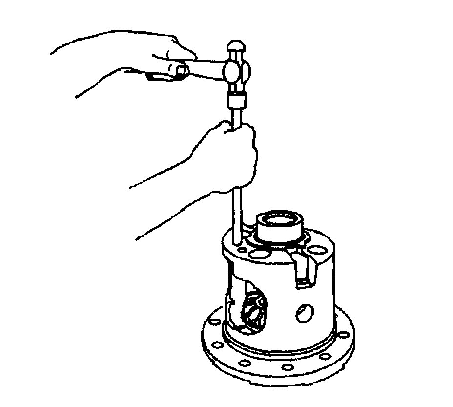

4. Install the pinion shaft. It may be necessary to press down on the side gear in order to align the pinion gear shaft opening with the pinion shaft opening in the differential case.
If the pinion shaft cannot be installed after pressing on the side gear, replace the side gear thrust washer with a thinner washer.

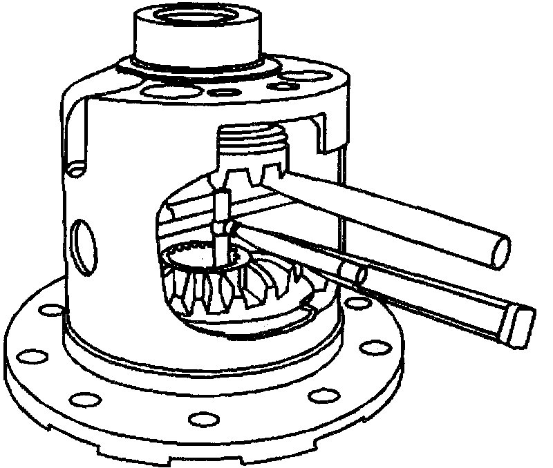

6. Rotate the pinion gear closest to the lock bolt so that one of the teeth is pointing downward (perpendicular to the ring gear flange).
7. Install a brass drift between the side gear and the pinion shaft.
Press the brass drift in far enough in order to compress the clutch discs.

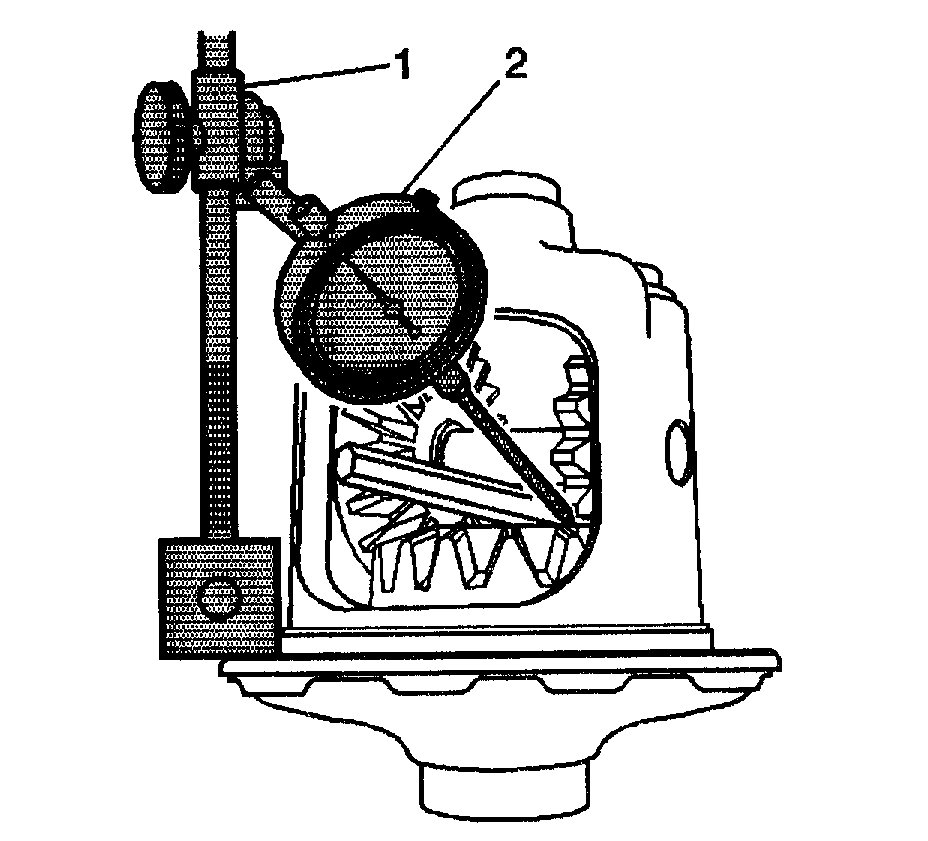

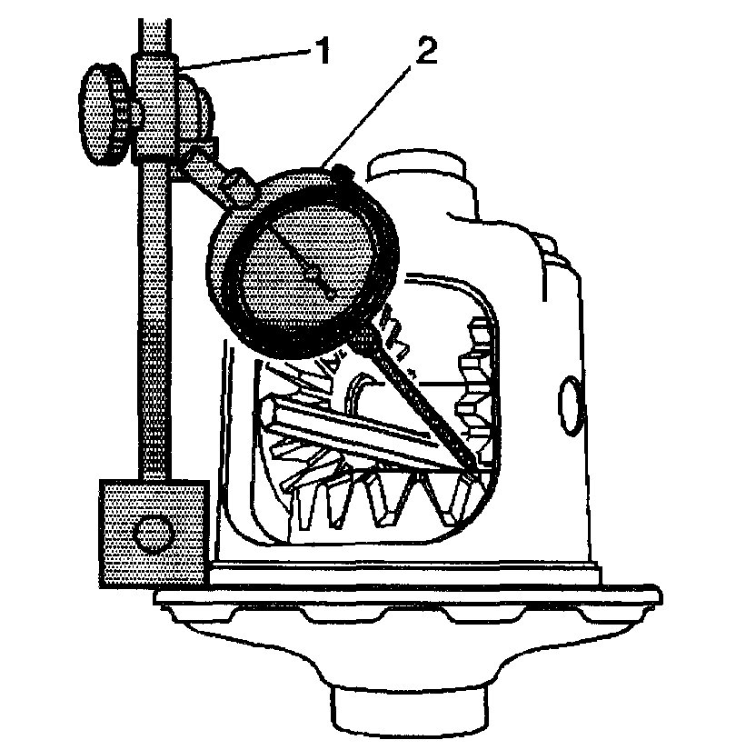

8. Measure the backlash of the pinion gear and the side gear by doing the following:
8.1. Install the J 7872 (1) to the ring gear flange.
8.2. Loosely clamp the J 8001-3 (2) onto the stem on the J 7872 (1).
8.3. Place the contact pad of the J 8001-3 on one of the teeth of the pinion gear closest to the pinion shaft lock bolt. Turn the dial of the J 8001-3 until the needle and the dial face indicate zero.
8.4. Tighten the lock nut of the J 8001-3 finger tight.
8.5. Pull the pinion gear firmly into the differential case seat.
8.6. Rotate the pinion gear back and forth.
8.7. Measure the backlash.
^ The backlash for the pinion gears should be 0.000 - 0.076 mm (0.000 - 0.003 inch).
9. If the backlash is too large, install a thicker side gear thrust washer and recheck the backlash.
10. If the backlash is too small, install a thinner side gear thrust washer and recheck the backlash.

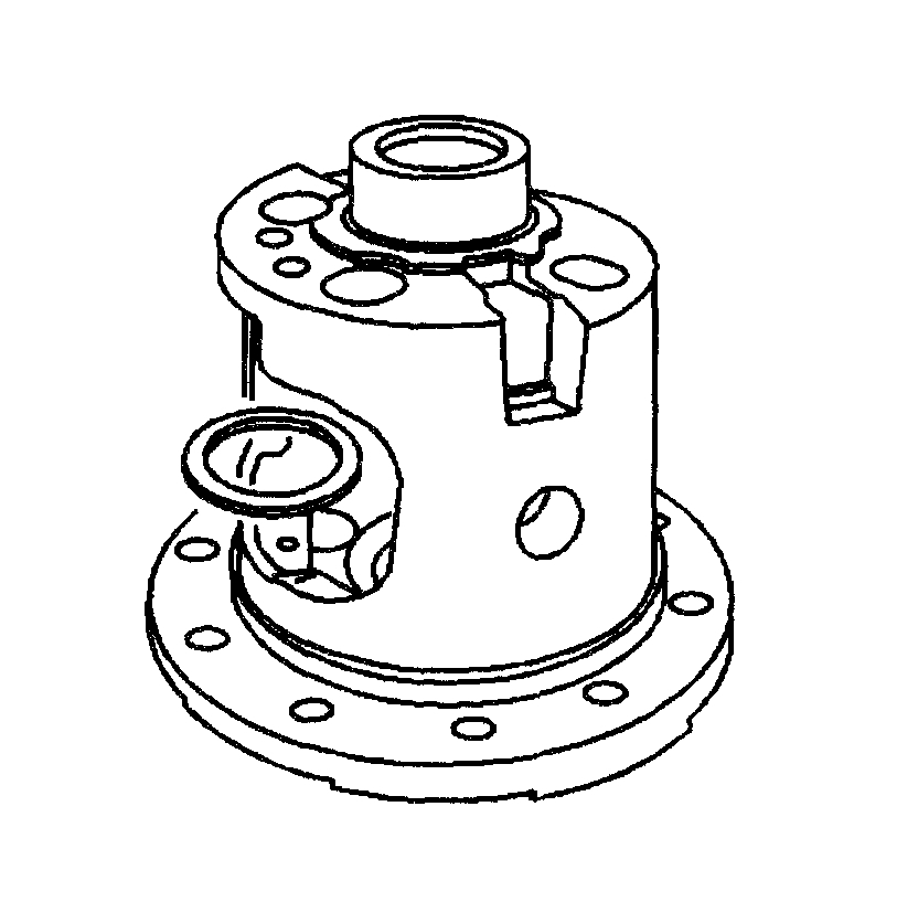

2. Install the right side gear thrust washer into the bell-end of the differential case.
3. Install the right side gear and clutch pack assembly into the differential case.

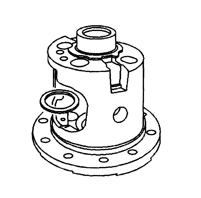

Locking Differential Assembly:
rear differential

^ Press the bushing into place until there is 0.025 - 0.076 mm (0.010 - 0.030 inch) of shaft end play.
pic 21
13. Install the latching bracket assembly.
The straight end of the latching bracket spring must be over and outside the governor assembly shaft.
14. Install the latching bracket bushing using a hammer and a brass drift.
^ Press the bushing into place until there is 0.000 0.051 mm (0.000 - 0.002 inch) of shaft end play.
15. Tighten the pinion shaft lock bolt.
^ Tighten the pinion shaft lock bolt to 36 Nm (27 lb ft).
16. Install the ring gear, if necessary.
