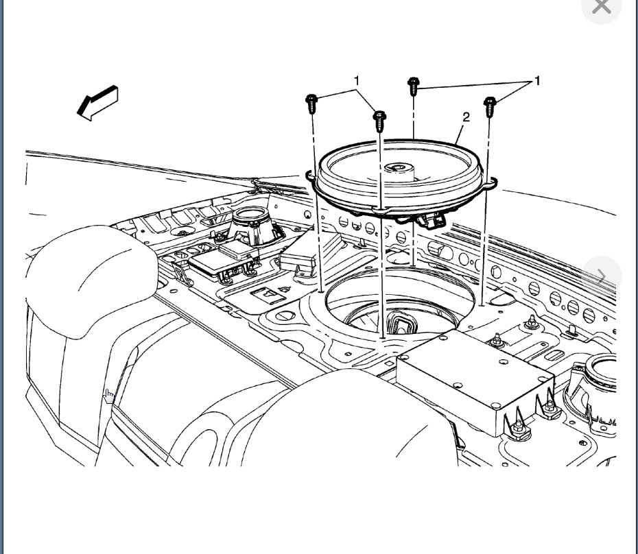

I purchased this ATS and noticed that the previous owner probably had a custom sub-woofer installed. He removed it but never plugged in the original Bose sub-woofer.
Sep 6, 2019 at 8:10 AM

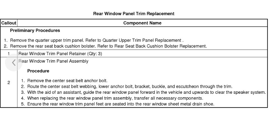

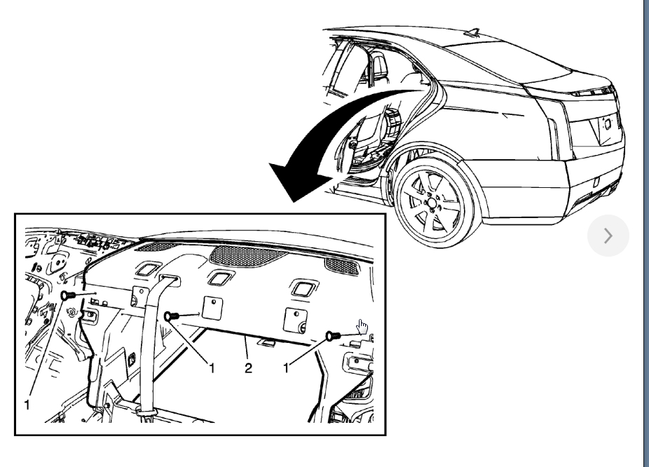

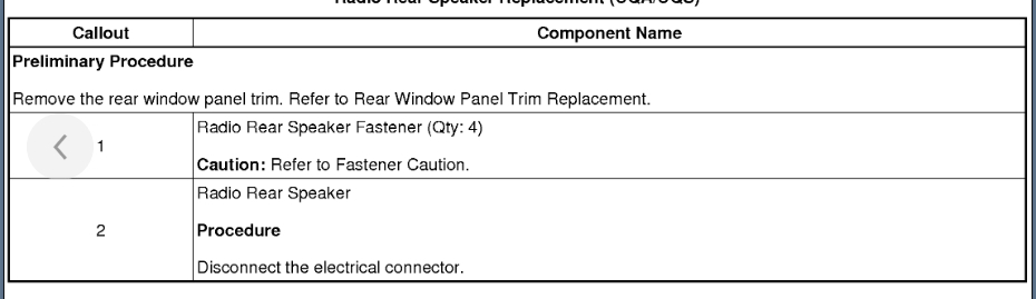

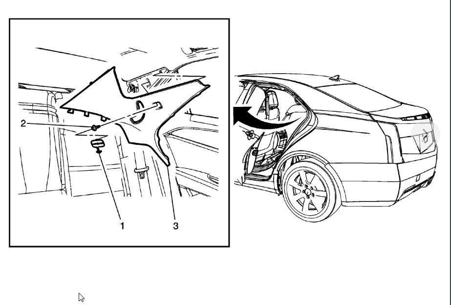

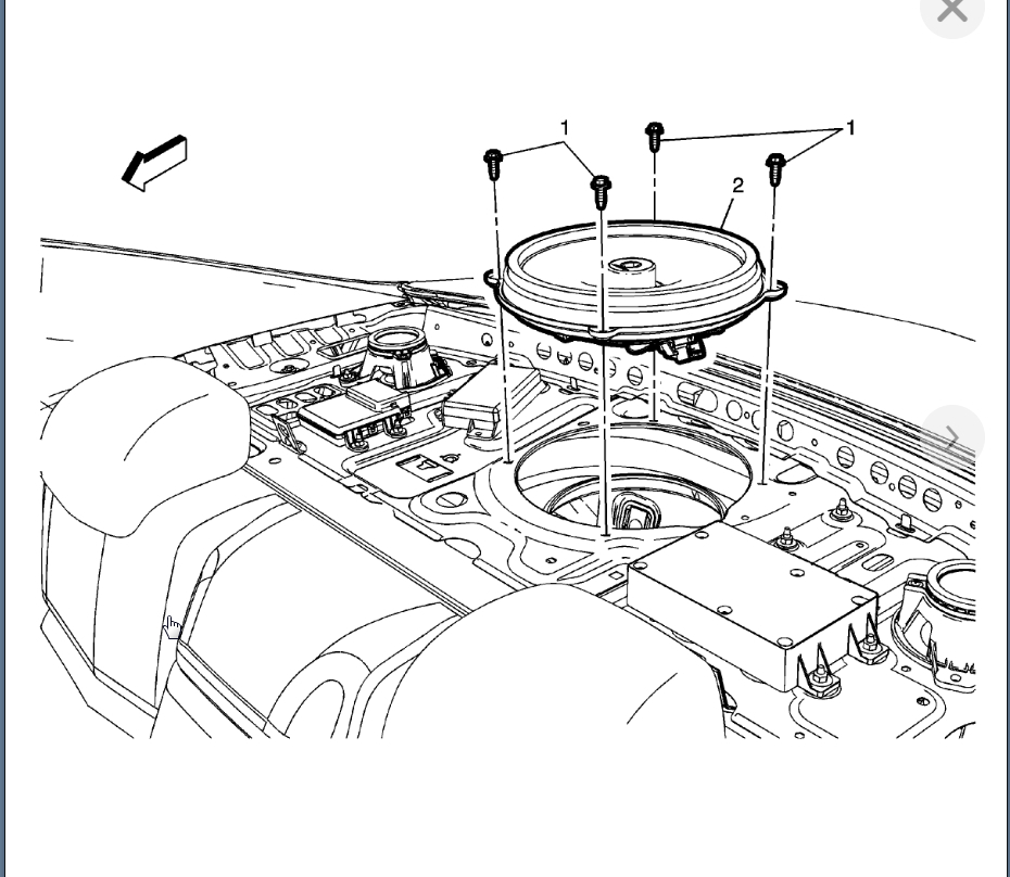

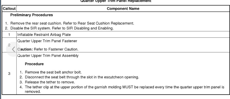

I assume you are looking for a procedure on how to reconnect it? I attached what the manual has for this. Let me know if you have more questions about this. Thanks

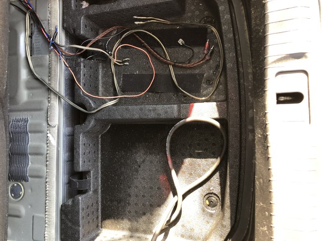

Thank you for your reply, and thank you for providing those instructions. The sub-woofer is actually still in its original place. The actual problem that it is not plugged in. That is the problem, I have no clue how to wire it.
Sep 6, 2019 at 9:23 PM

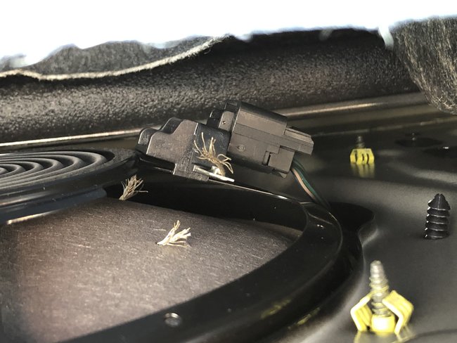

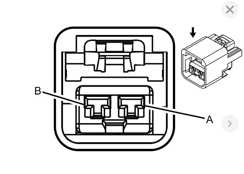

Okay. I am not sure I am following. Those wires that you showed in the first picture are from the aftermarket box that he had as you stated in the first post. The second picture shows the OEM connector for the OEM sub and it is connected. Those wires from the first picture do not go to the OEM sub.

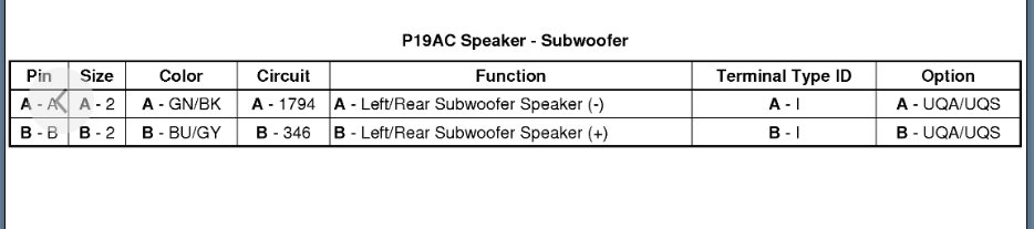

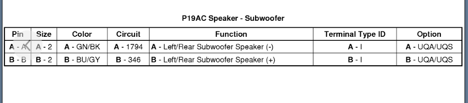

Here is the wiring diagram for the sub-woofer. It appears the connector is the only one for this sub.

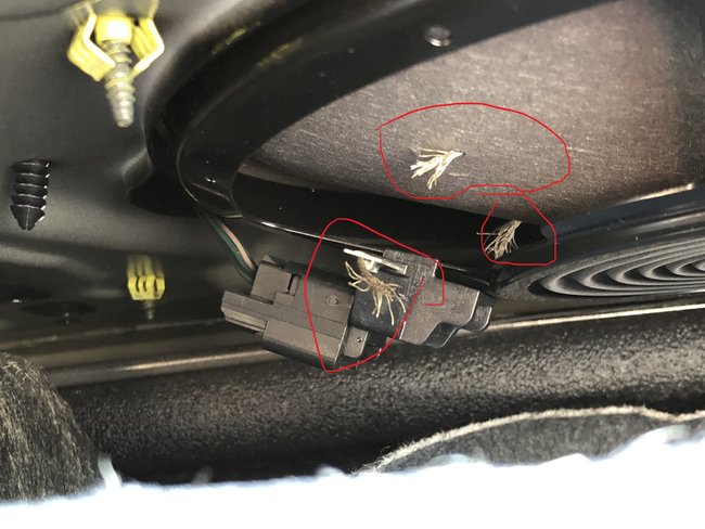

Hi sorry for the long delay, I was out of town in a business trip. I had not had a chance to read your reply. Thank you for the information. So my next question is are those three that look like wires, are they not suppose to be connected anywhere?
Sep 11, 2019 at 10:58 PM
That looks like string and not wire. Wiring would be copper but that looks like it is string. Plus that is coming through the diaphragm of the speaker which should never happen. The diaphragm is what generates the sound so it can’t have any cuts holes.
I bet that is someone’s attempt to repair that speaker. I have seen mesh used but I have not seen string used.
Sep 12, 2019 at 7:03 PM
