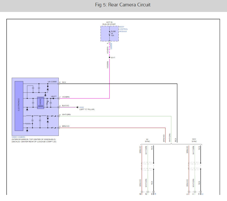

I removed the trunk liner, and the connection is good, no corrosion or damage. Checked fuse #34 it was good. Figured the camera needs replaced. Then the camera came on yesterday but only one time. So now I think the camera is good but don't know. What else could be the issue?
