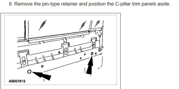

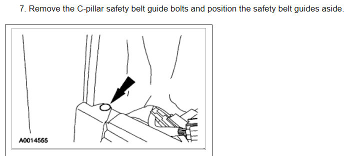

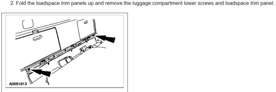

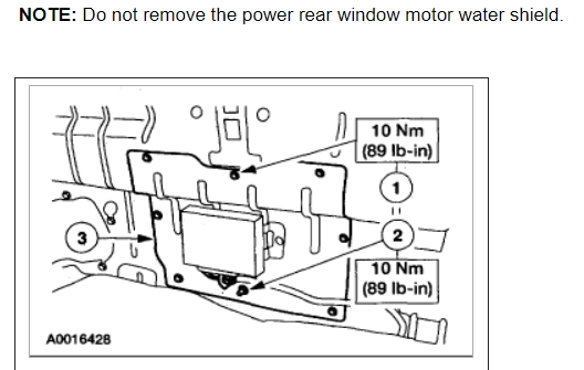

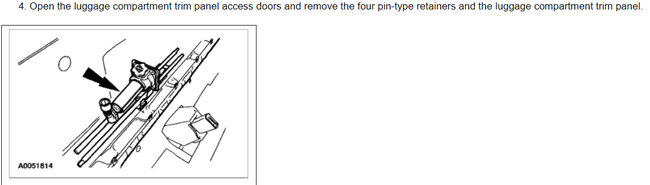

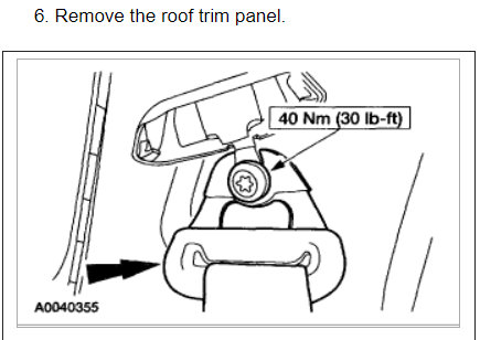

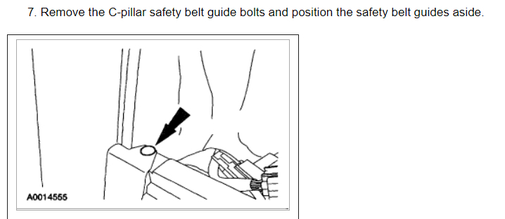

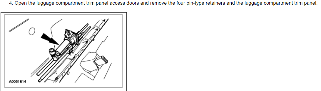

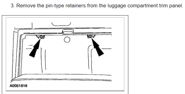

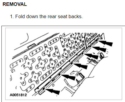

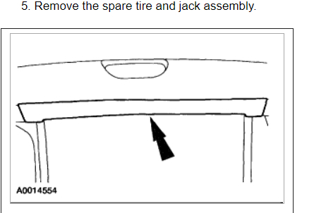

I found the information you are looking for it is in ALLDATA check the diagrams (below).
