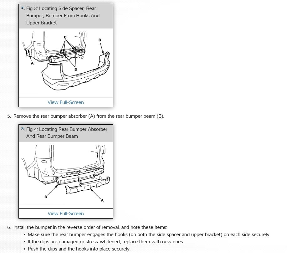

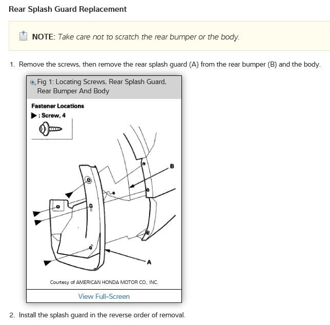

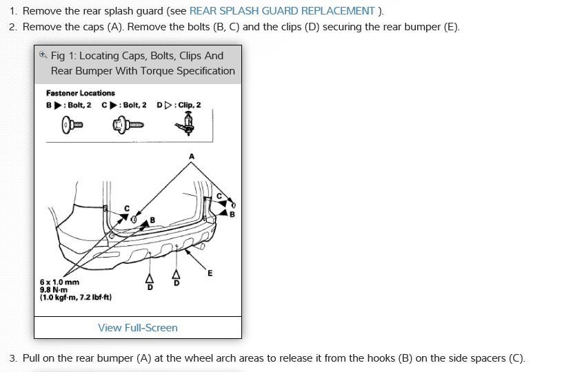

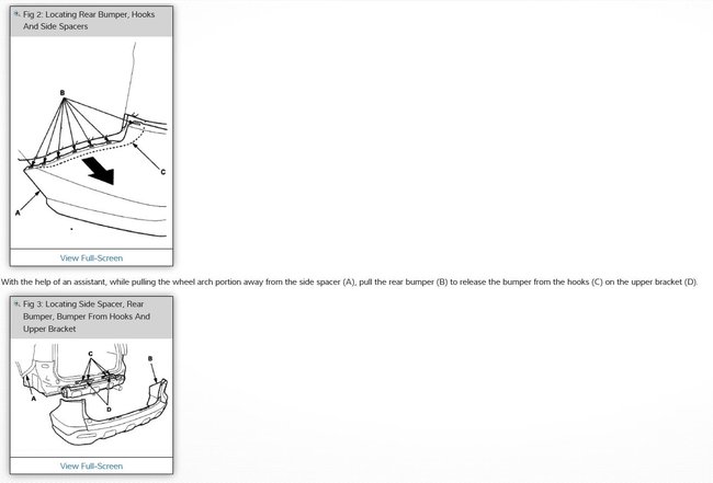

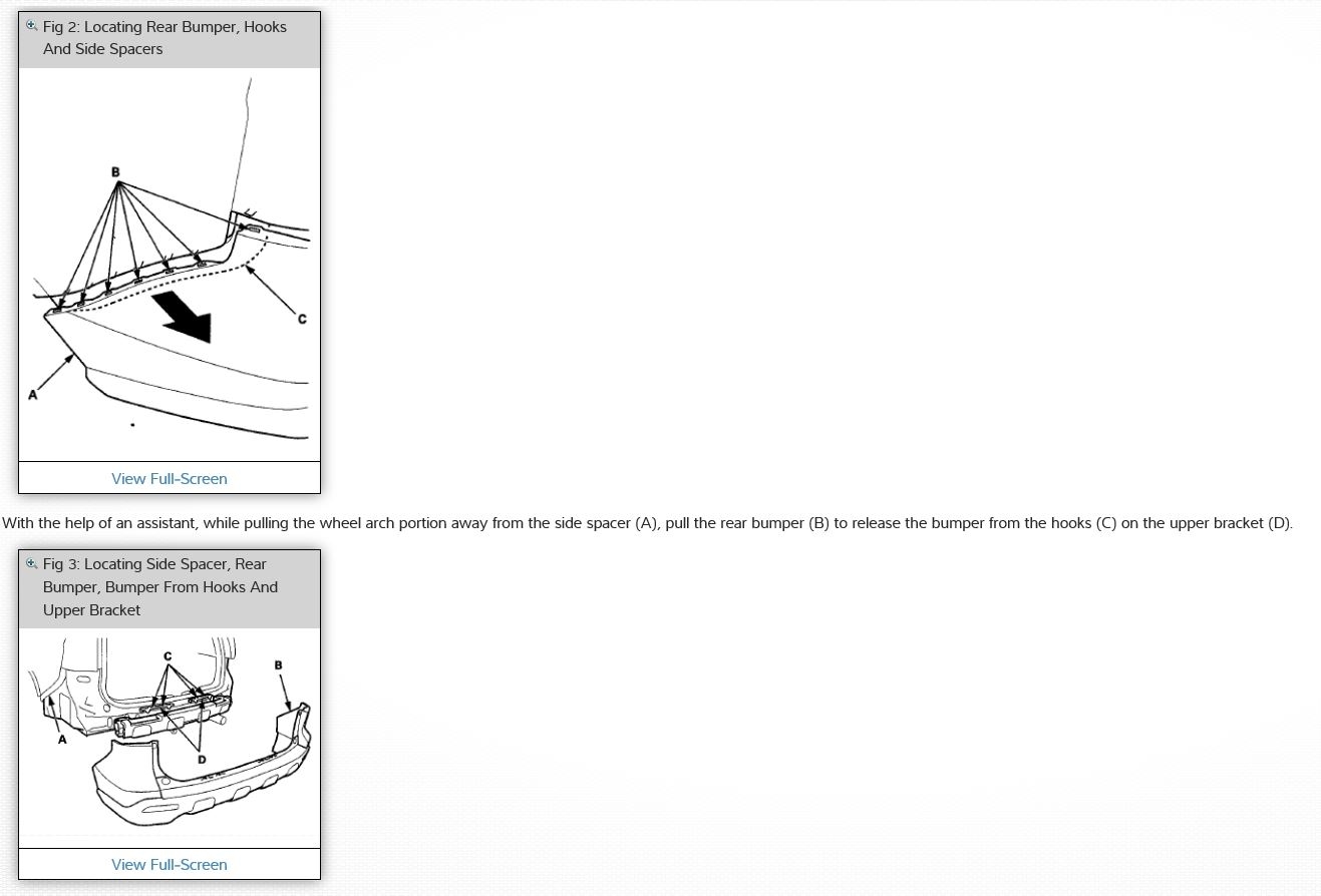

Grateful if you could provide me with removal instructions for my car's rear bumper.
Oct 16, 2018 at 7:27 AM
PATENTED_REPAIR_PRO
  • 1,853 POSTS
Bumper removal instructions in the diagrams below. Check out the diagrams (Below). Please let us know if you need anything else to get the problem fixed.
Oct 16, 2018 at 8:51 AM
