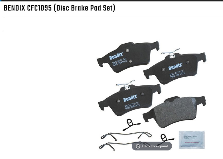

For the best value, dependability, and cost I would use Bendix brand. Here is a tutorial showing how to replace rear brake pads:
https://www.2carpros.com/articles/how-to-replace-rear-brake-pads-and-rotors
Here is a YouTube video from our site on how to compress the rear brake caliper for brake pad replacement.
https://youtu.be/j8YwfSKEzZo

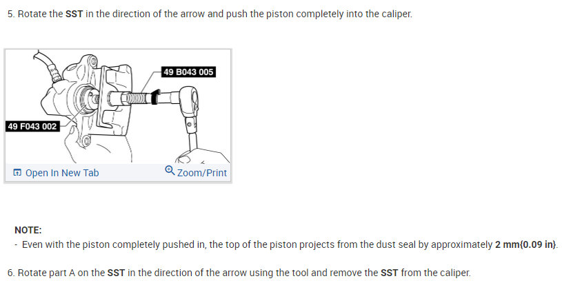

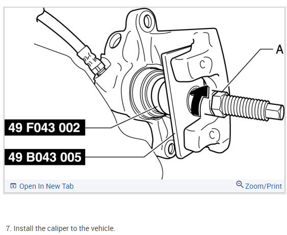

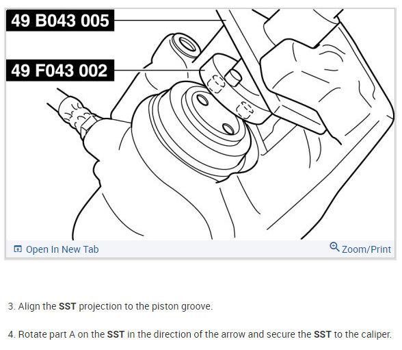

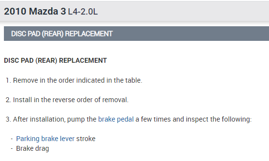

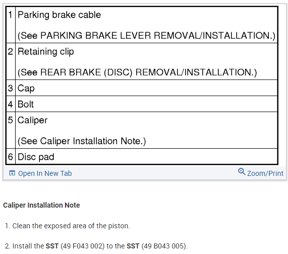

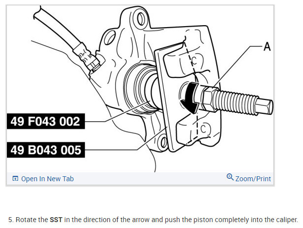

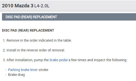

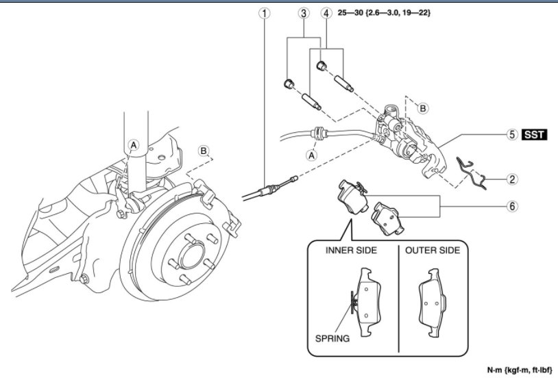

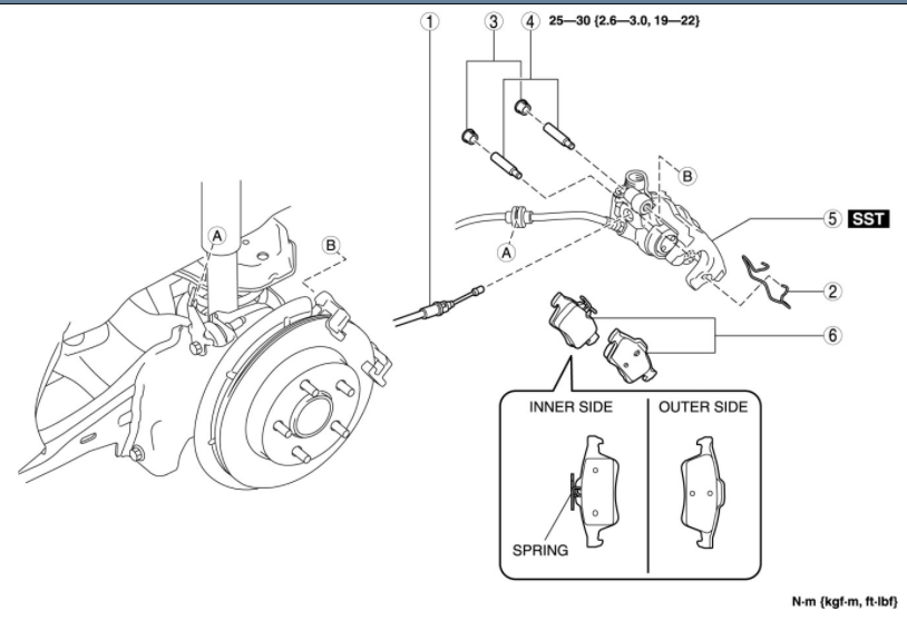

I've attached picture steps below on how to change the rear brake pads on your vehicle. I've attached below as well a picture of the Bendix brand brake pads and part number that are available at your local auto parts stores. Hope this helps and thanks for using 2CarPros.
