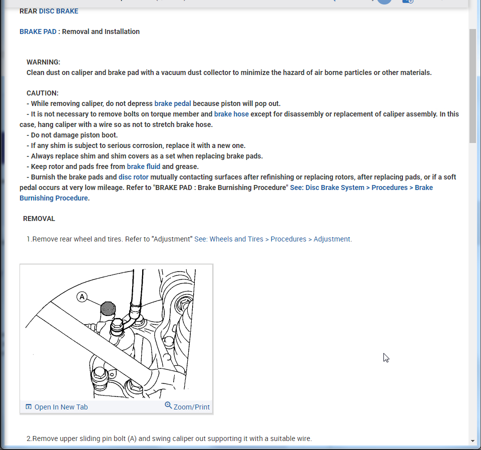

I recently replaced the brakes and calipers and my rear pads are wearing very quickly. I've looked around for an adjustment but can't find one. Should I have under sized the rears somehow?
