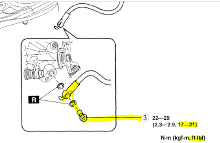

Hello, I was wondering if you'd be able to provide the banjo bolt torque specs on the rear caliper of the vehicle listed above. Thank you.
Dec 3, 2022 at 2:08 PM
As far as the torque specs are concerned, I attached them below for you. See pic 1.
When you reinstall the hose, make sure to replace the brass washers as indicated in the picture.

Yes, that helps. Thank you very much.
