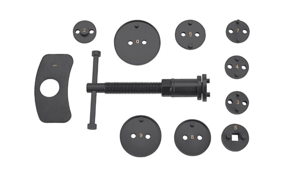

You need to compress and twist at the same time. Being a 2008 the seals are likely stiff. It sounds like you are trying to use one of the ice cube tools. You will need to get the type of tool in the image. They can be found as a "loaner tool" at many parts stores, you basically buy the tool, then when you return it in good shape, they give you back your money. Then you use that tool to apply pressure while turning. There were a few years when there were left hand thread parking brake calipers as well. I don't believe that one has those though.

the tool i used was the brake kit that you have pictured and even with the force, it won't go in.
