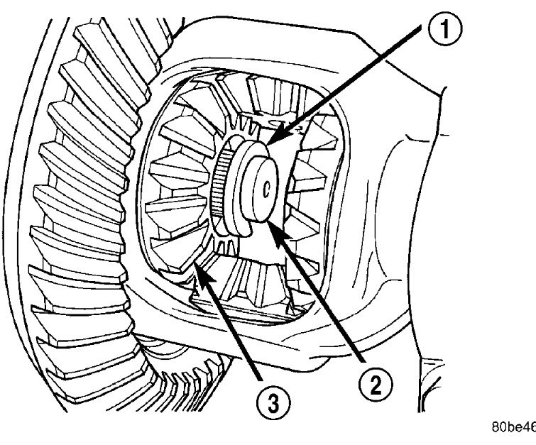

cannot remove rear axle. is there a circlipe or something holding it in under the differential cover?

yes, the cover has to be removed and pin going through differential then the circlip removed to remove axle. see picture.
