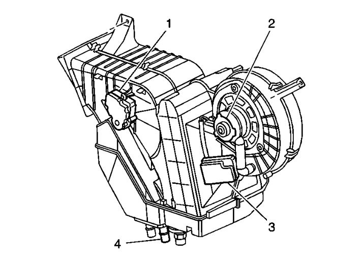

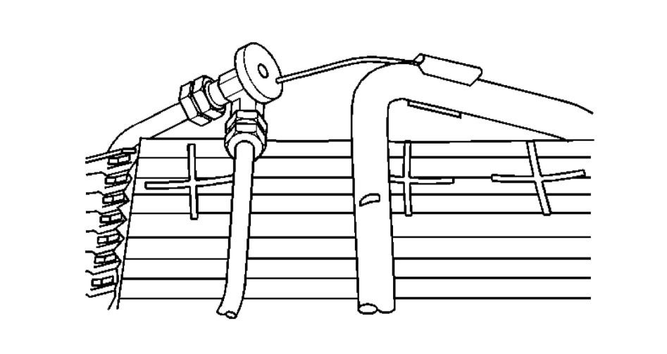

Do you have the pressures for me to see?
It could be either a bad expansion valve or a blend door motor.
Both are at the rear of the van under the plastic trim in the left rear of the van.
