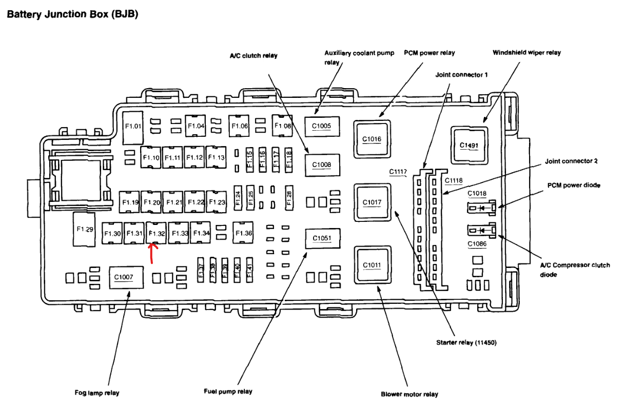

The first thing we need to do is check the fuse #f1-32 on the left side of the engine compartment which runs the rear blower motor. Here is a guide to help and the fuse location below:

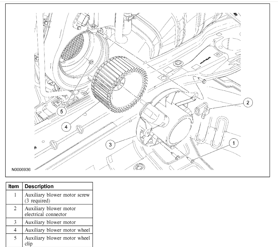

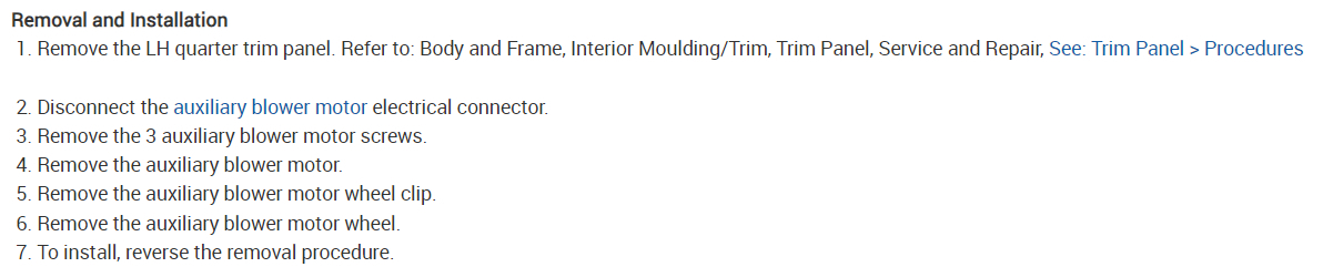

If the fuse is okay, here is a guide to help test the blower motor which has probably gone bad:
https://www.2carpros.com/articles/how-to-test-an-automotive-hvac-system-blower-fan-motor-a-detailed
