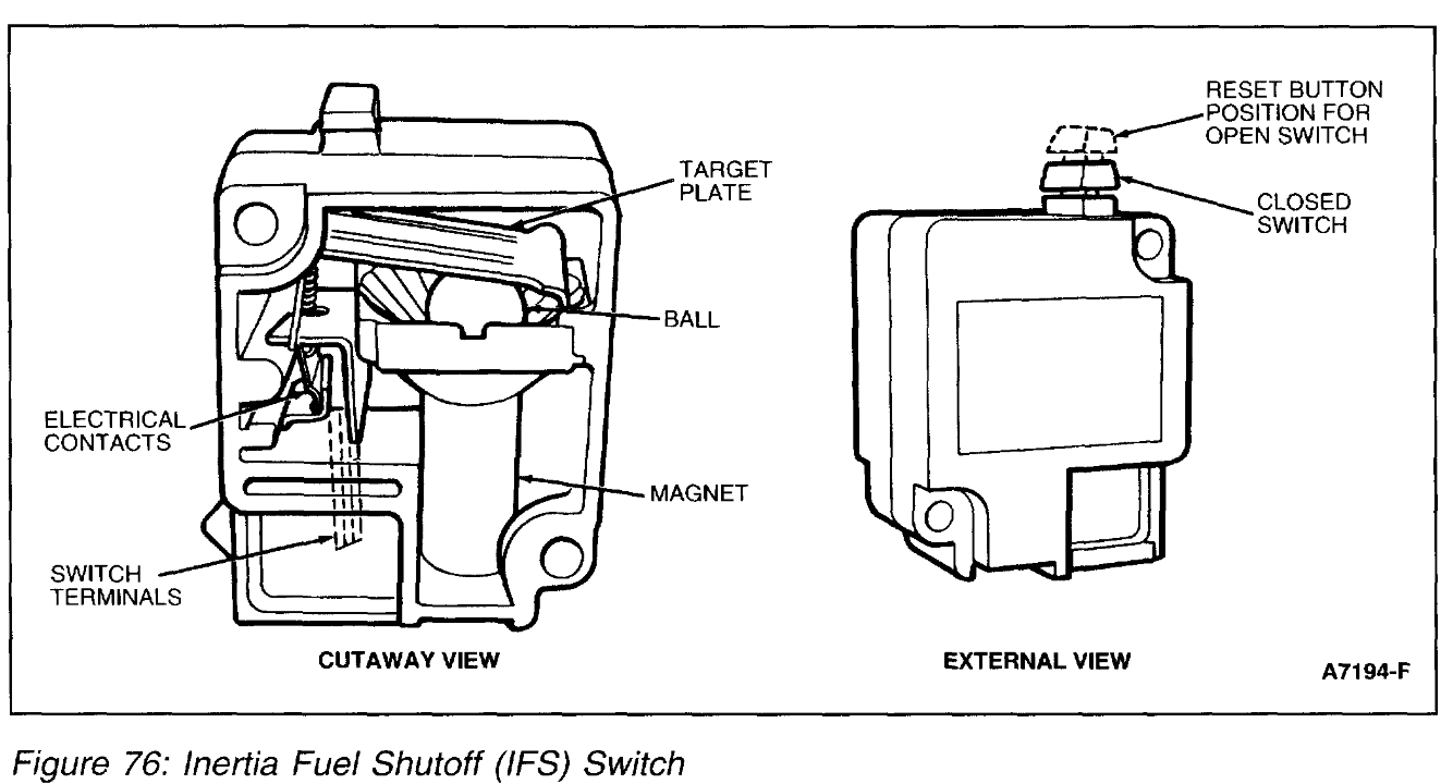

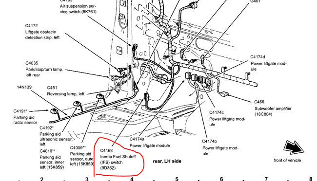

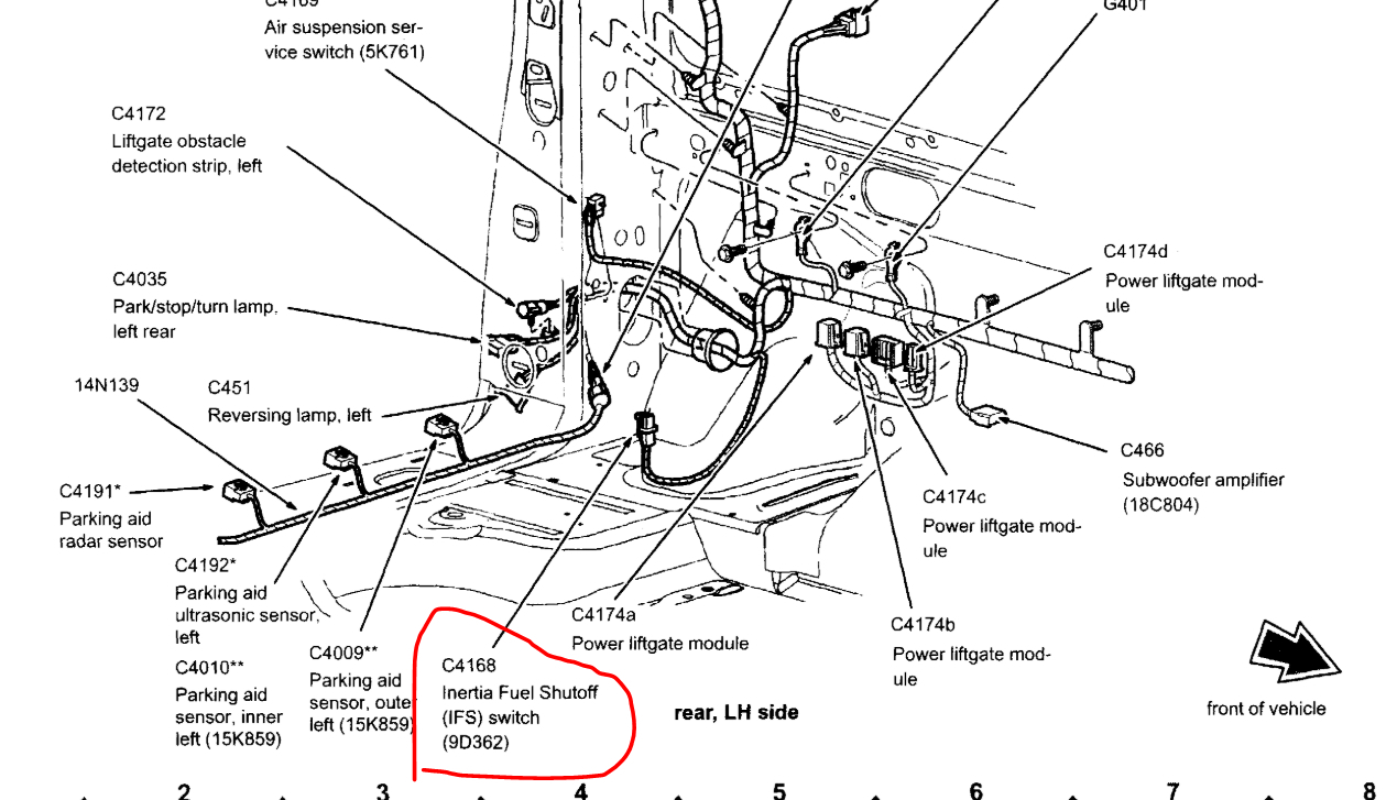

Check to see if the inertia switch needs reset. It should be located in the rear of the vehicle, driver's side. You should have a small panel that is removable to access it. I attached two pics which I hope help.
Let me know if this helps. If it doesn't, I need to know if you are getting fuel and spark to the engine. Here are two links that explain how it is done:
Let me know what you find.

There is no fuel reset in the back just a air suspension switch. the cop that showed up said that the only way the fuel switch gets tripped is from an accident crash.. I lost oil pressure which shut me down.
