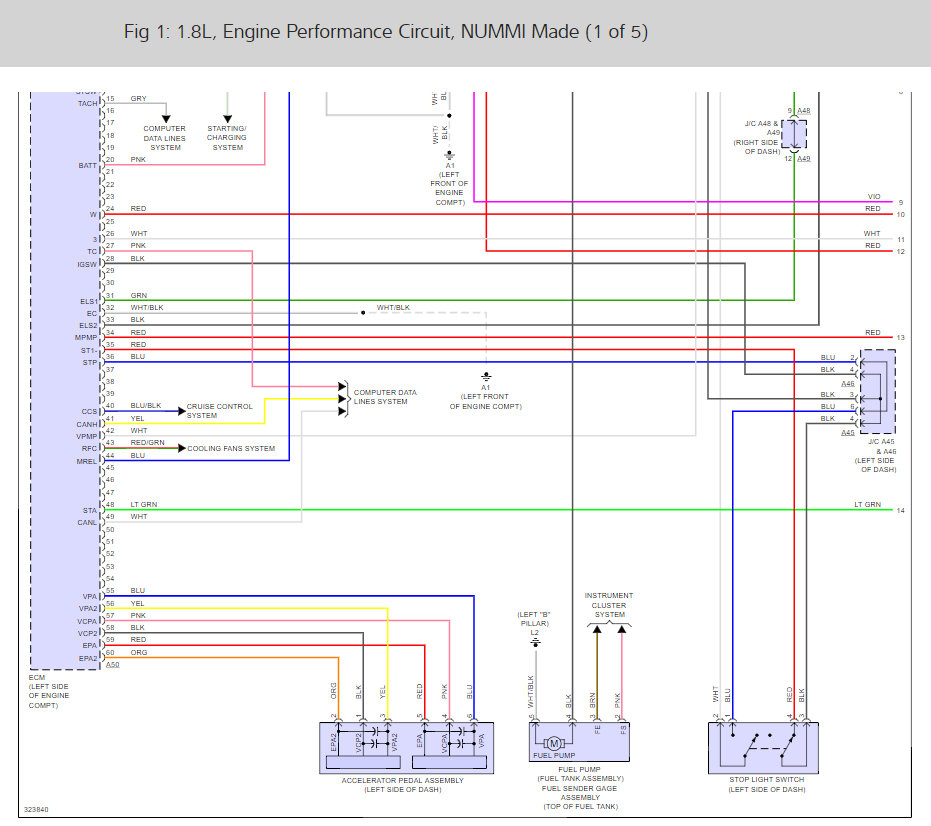

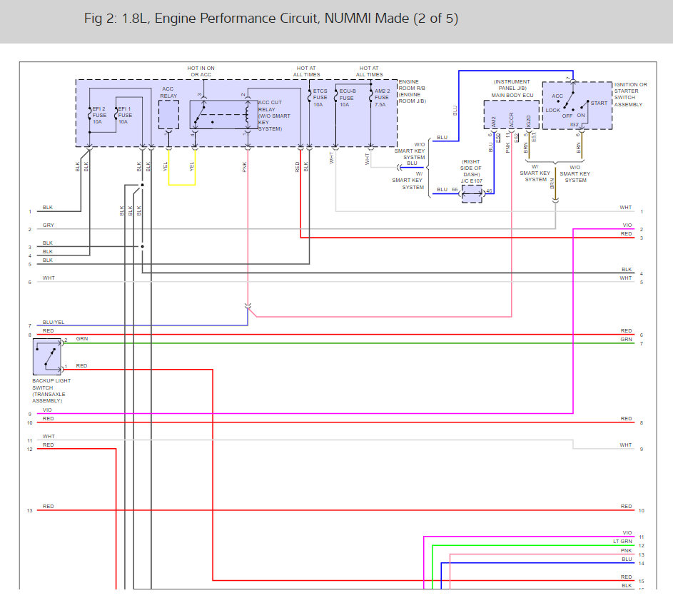

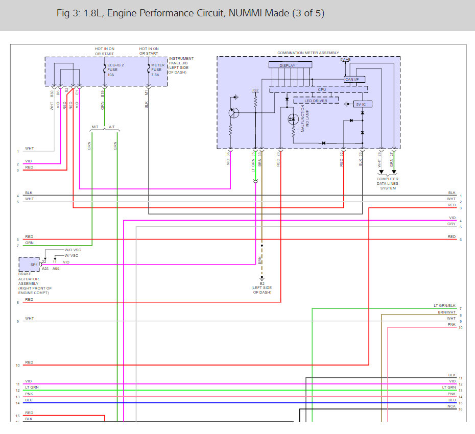

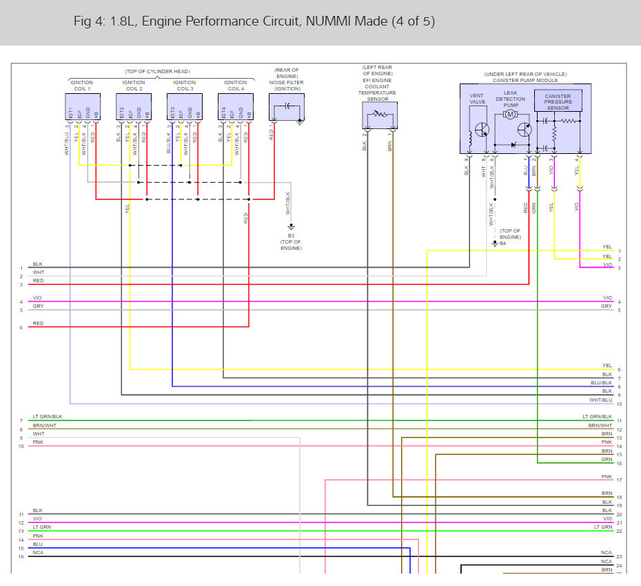

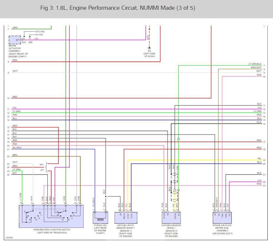

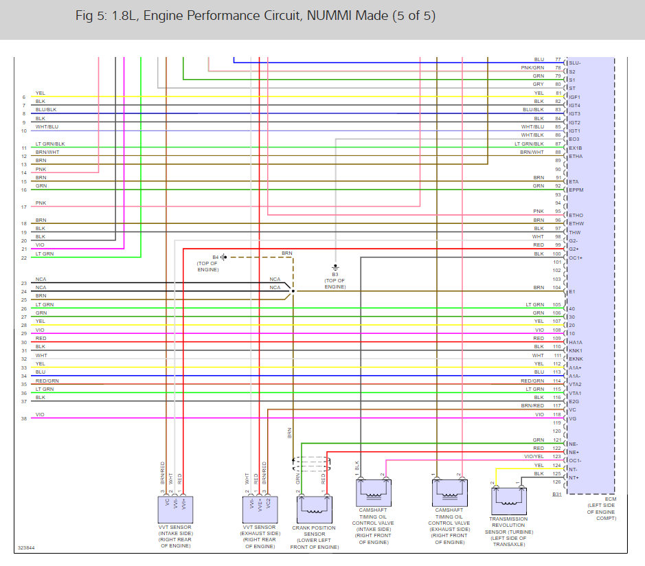

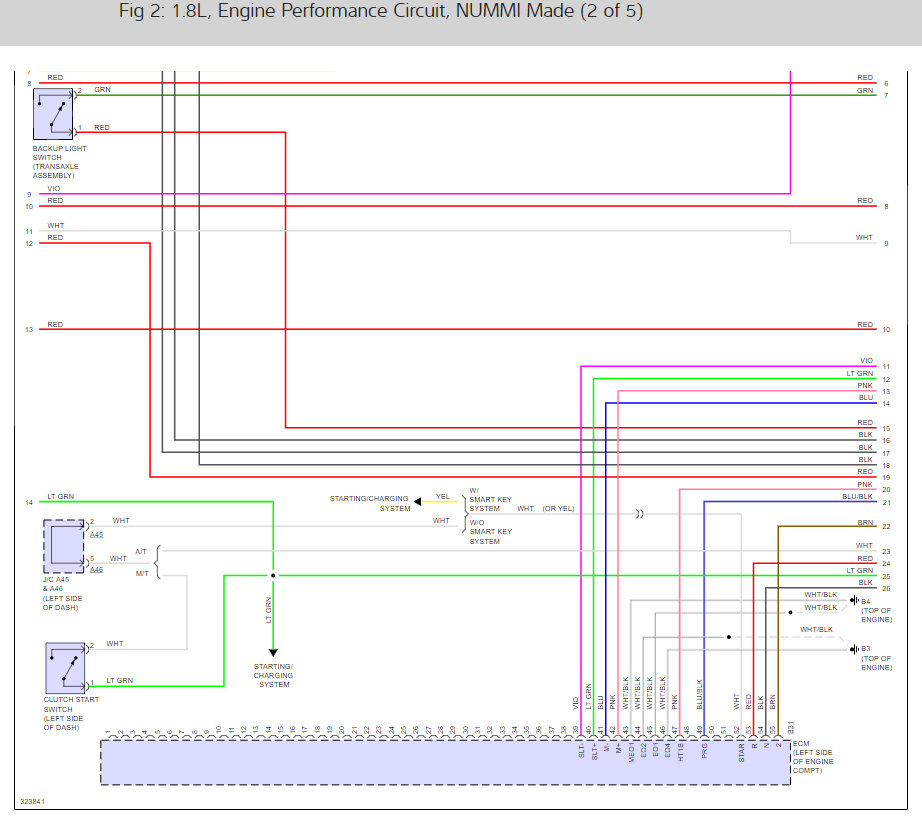

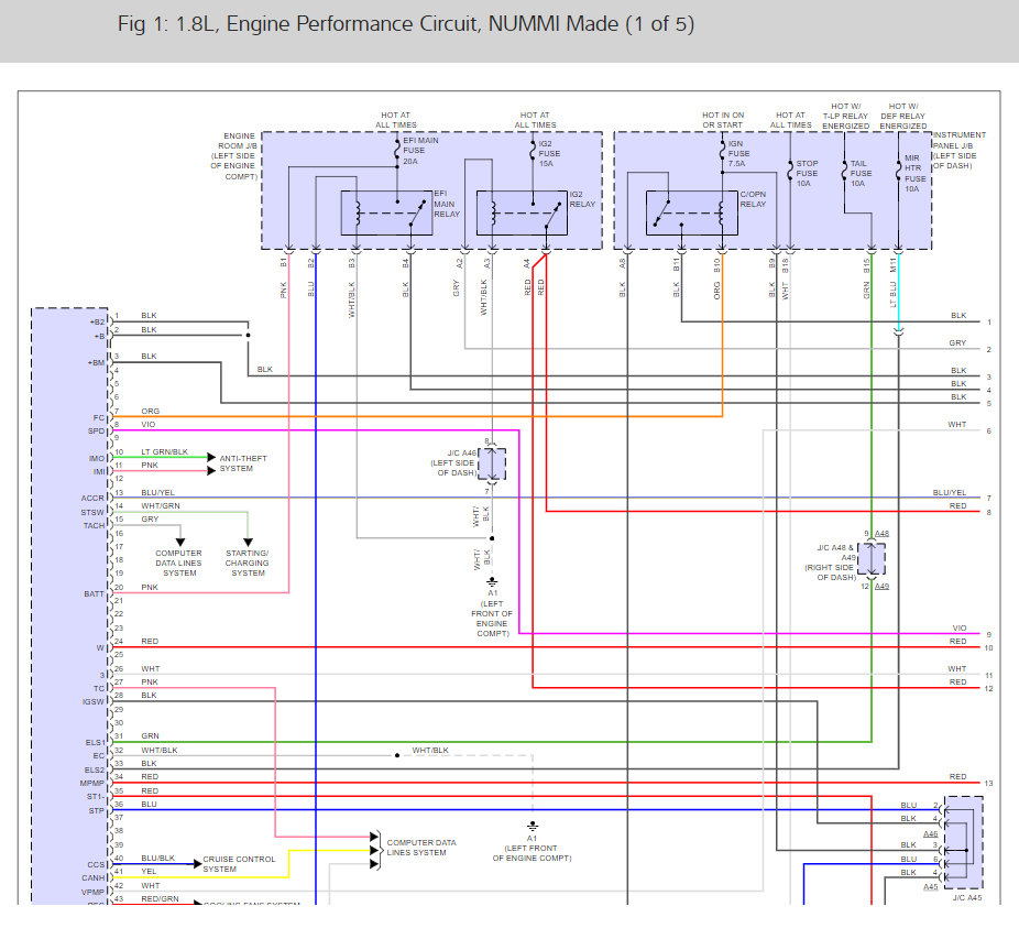

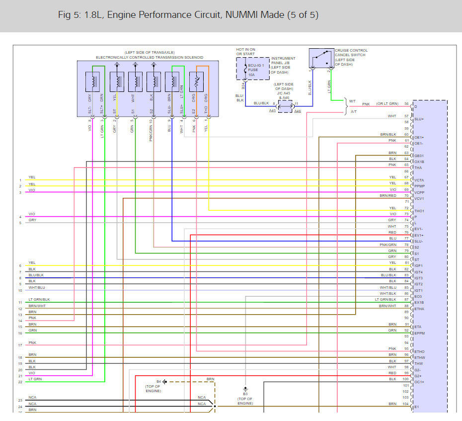

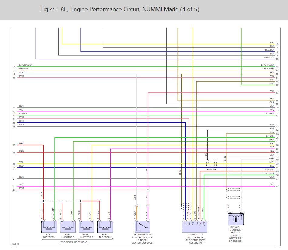

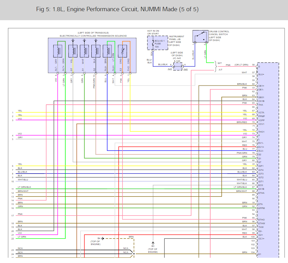

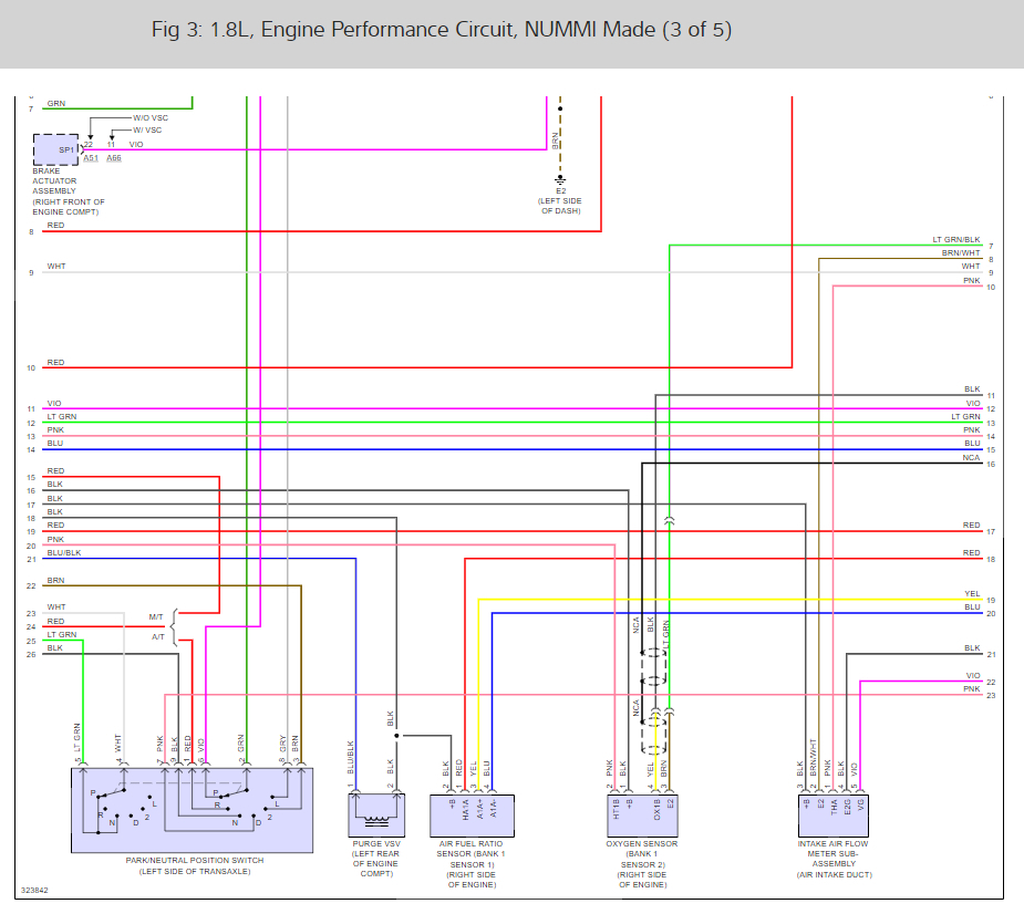

I would check the wiring and connections first. Here is a guide and the engine wiring diagrams so you can run tests:
If the wiring checks out you will need to have the PCM reprogrammed for about $130.00.
Here are the engine wiring diagrams.
Check out the diagrams (below).

Ken,are you mean if I use multi-meter to check the wiring I will need to reprogram the PCM by dealer ?
Feb 9, 2018 at 9:07 PM
Sorry, I mean you can check the wiring and it is okay you will need to go to the dealer to have the PCM reprogrammed.
