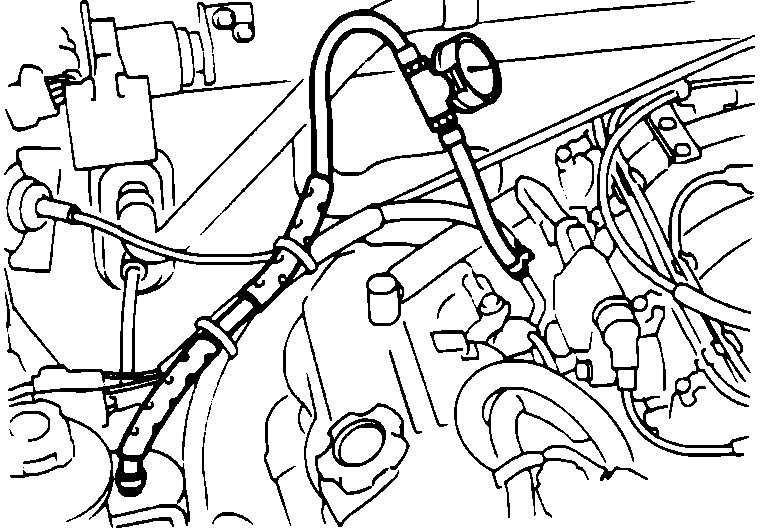

2. Disconnect fuel hose between fuel filter and fuel tube (engine side). Then install pressure gauge.
3. Start engine and check for fuel leakage.
Fuel Pressure Gauge
pic 1
4. Read the indication of fuel pressure gauge.
pic 2

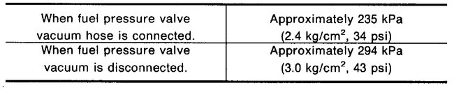

SPECIFICATION AT IDLING

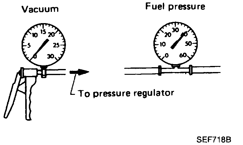

5. Stop engine and disconnect fuel pressure regulator vacuum hose from intake manifold.
6. Plug intake manifold with a rubber cap.
7. Connect variable vacuum source to fuel pressure regulator.
Vacuum/fuel Pressure Test
pic 3
8. Start engine and read indication of fuel pressure gauge as vacuum is changed.
NOTE: Fuel pressure should decrease as vacuum increases. If results are unsatisfactory, replace fuel pressure regulator.
