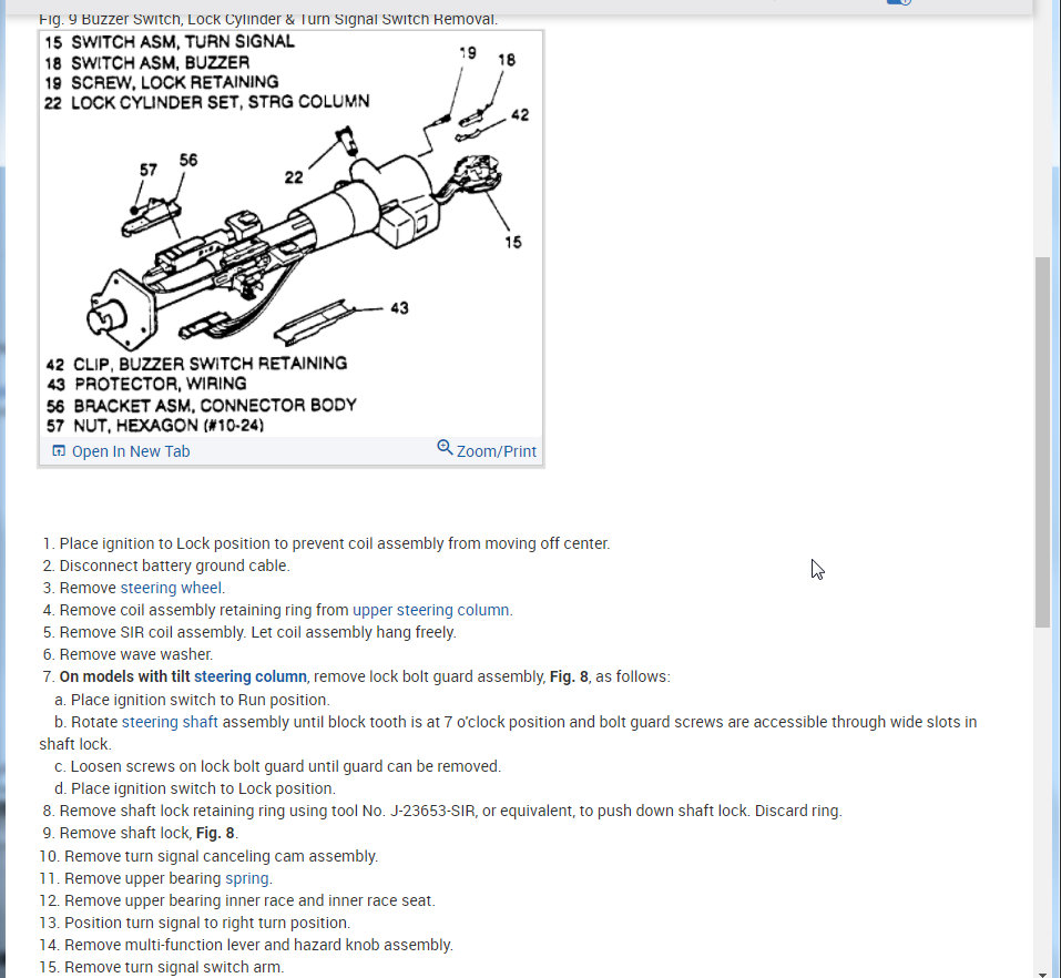

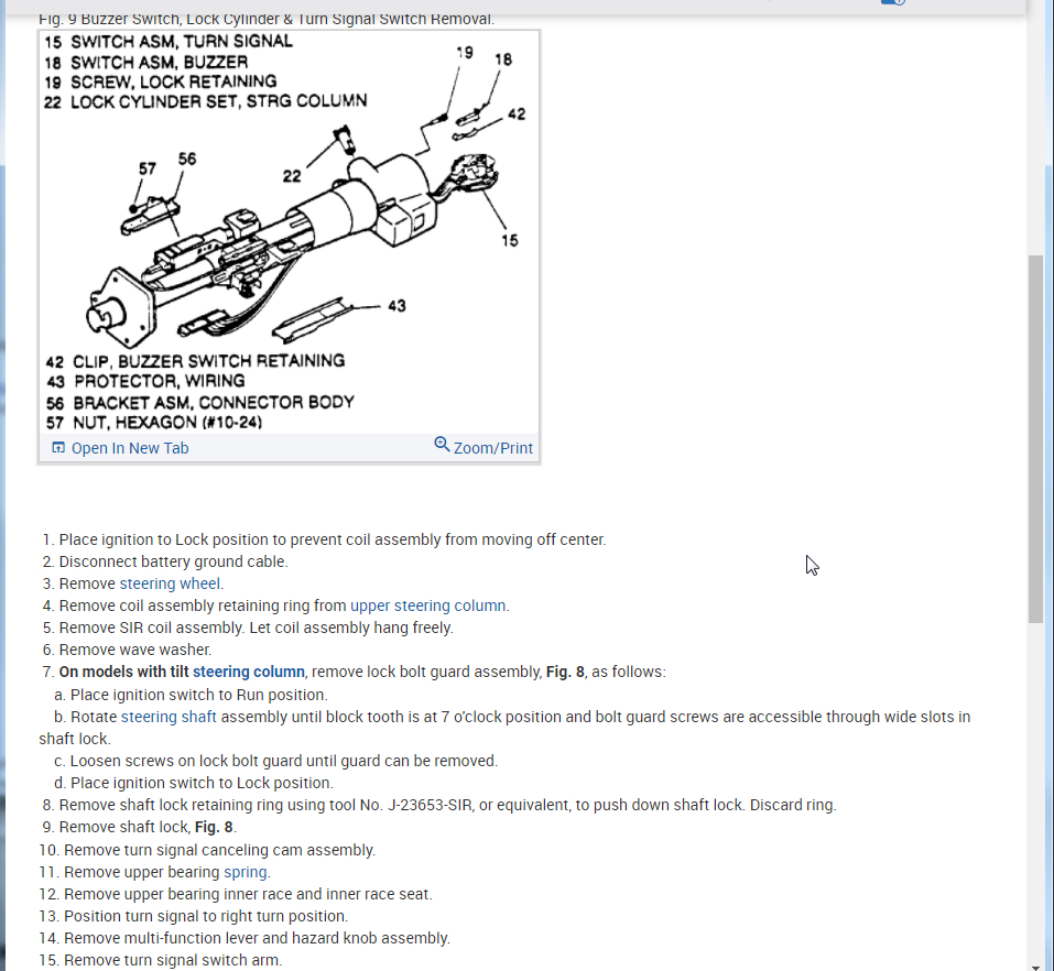

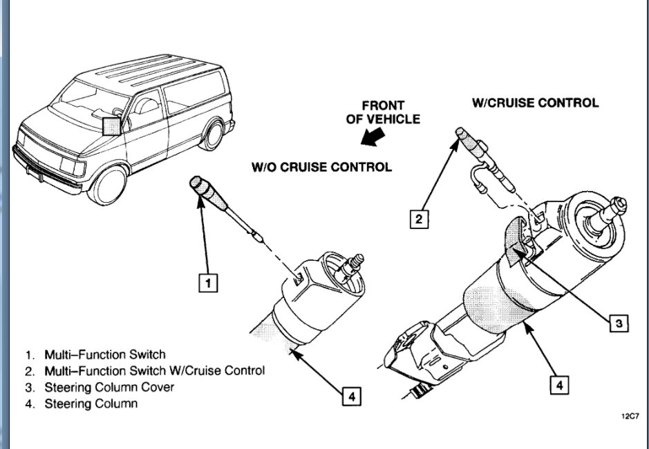

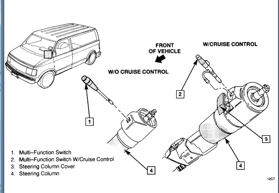

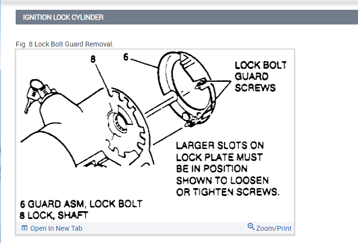

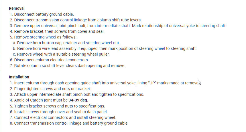

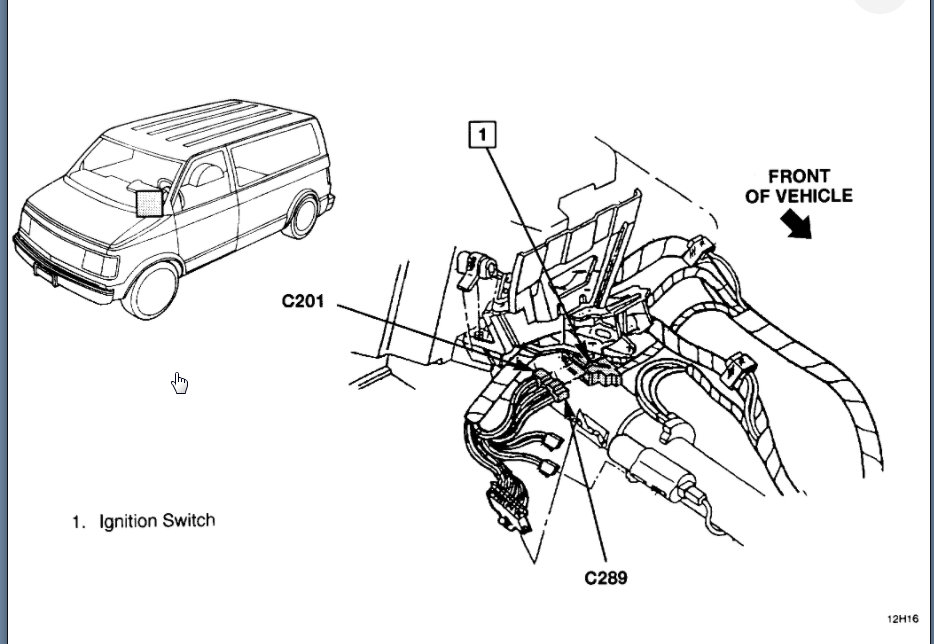

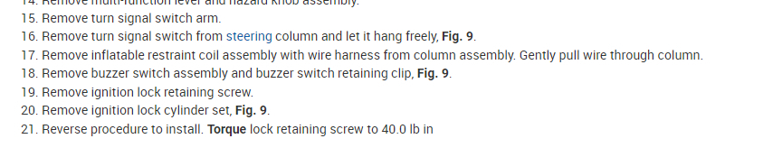

I am attaching the process for the column, cover, and switch. Let us know if you need more info. Thanks

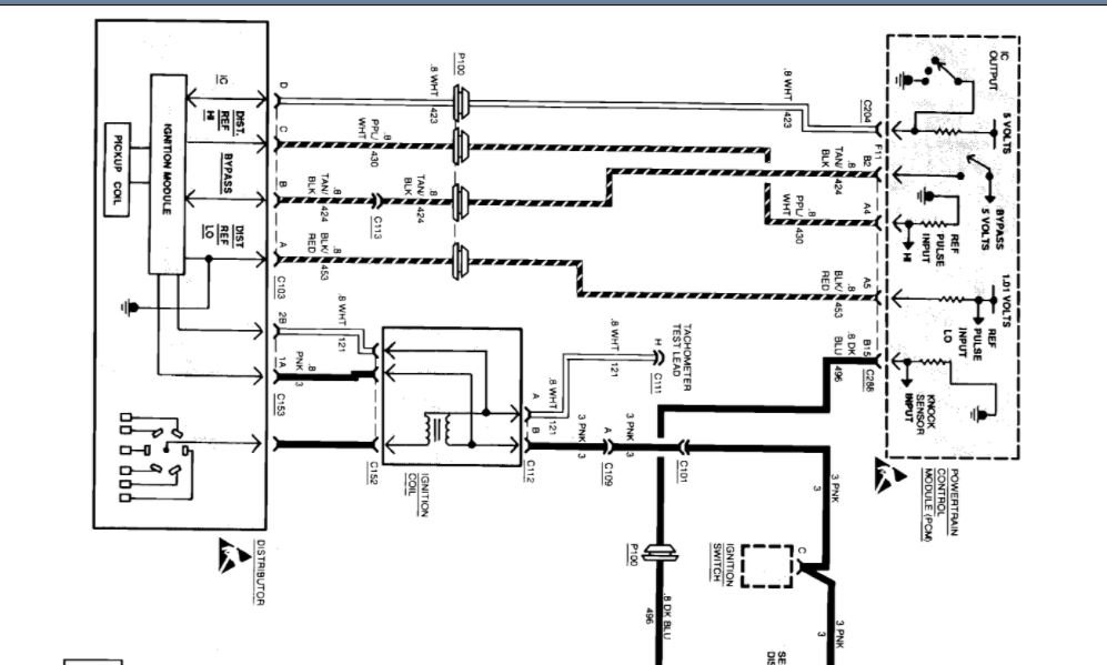

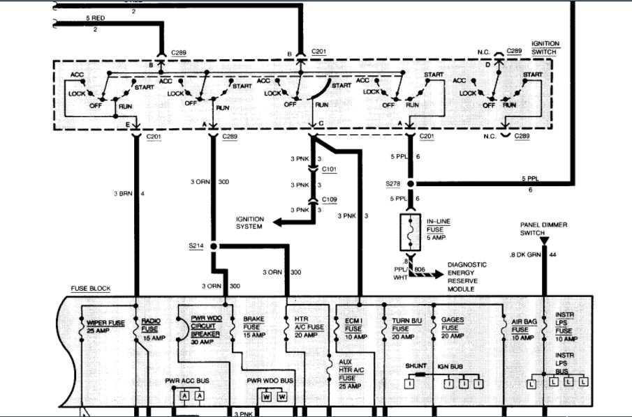

I attached a wiring diagram of the ignition switch for you to view.
You should have power to the positive side of the coil with the key on. Then use a test light on the negative and crank the motor and see if the test light blinks. That will tell you if the module is working.

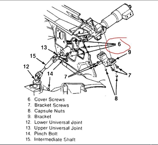

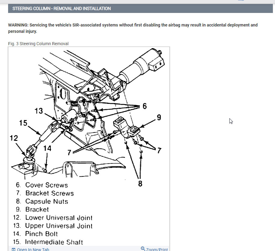

How do I gain access to the ignition switch on the steering column underneath the dash? I took out the two big bolts, but the steering column does not lower. How do you lower the steering column? Thank you for all your valuable info. Robert Mason.
Nov 17, 2020 at 3:53 AM
Okay, I attached the picture. Remove the 3 bolts marked number 6 in the picture. That should allow the column to come down.
