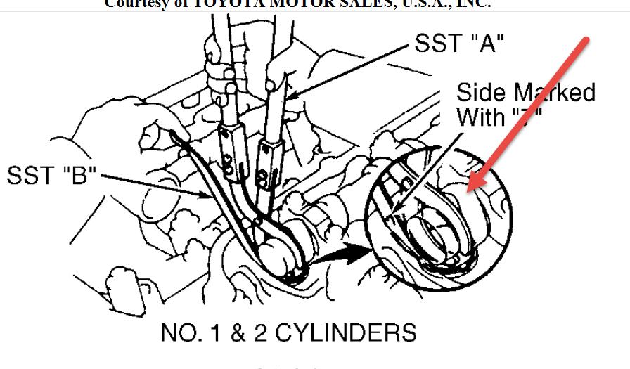

THE CAR HAS 58000 MI. IT MAKES A RATTLING NOISE ON LEFT VALVE COVER AREA SPECIALLY ON THE REAR AREA WHEN ENGINE GO OVER 2000 RPM. OIL PRESSURE IS OK. I REMOVED THE EXHAUST CAM SHAFT VALVE CLEARENCE WAS OK. ALL COMPONENTS LOOK OK. I DISASABLED THE FLOATTING GEAR AN CHECK THE SPRING WASHER LOOKS OK. TO ME . I BOUGHT 2 NEW SPRING WATCHERS THAT I'M GOING TO INSTALL THEY LOOK A LITTLE BIT CLOUSER IN GAP THAN THE USED ONE I REMOVED. I HAVE NOT PUT THE ENGINE TOGETHER UNTIL IHAVE AN OPINION FROM YOU GUYS. TO ME EVERYTHING LOOKS NORMAL ON THAT AREA CAN YOU PLEASE GIVE ME AN OPINION IF I'M ON THE RIGHT TRACK OR WHAT ESLSE COULD BE? TKS.
