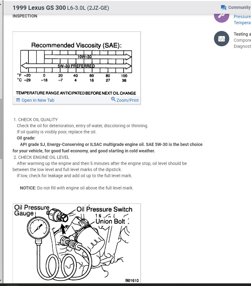

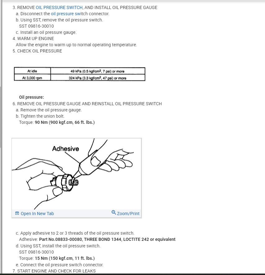

Just to be clear, you replaced the fuel filter in the tank from under the rear seat and now this is rattling?
If so and this is now rattling, then it very well could be a faulty oil pump and just a coincidence.
So that means we need to start with checking the oil pressure in order to determine if this is related to the oil pressure.
https://www.2carpros.com/articles/high-or-low-engine-oil-pressure
I attached the process below on how to test the oil pressure so let's start with this and go from there.
