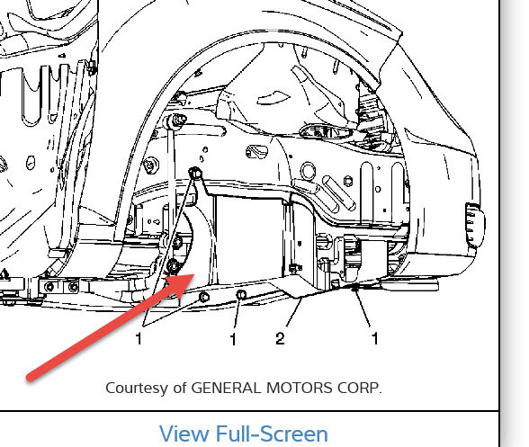

it can be the rivets have broken above catalytic converter or converter it self hit the converter and see if you can hear it rattle if not it may be a shield around engine. Unless you hear it at another time. See picture.
