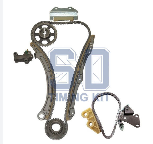

A good layout of the timing chain set up in your engine, the smaller chain is the oil pump drive chain is in the image below.
