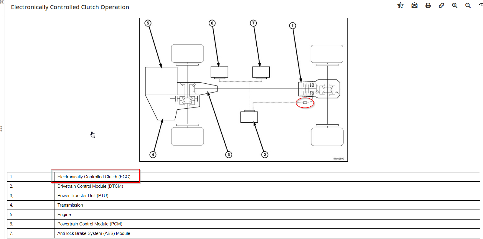

Okay. Since they replaced the coupler that tells me they think it is related to the 4WD system or engagement.
I am thinking they were close but need to look at the rear driveline module. This is basically the system that links the rear suspension to the front when 4WD is needed. I suspect that clutch is slipping.

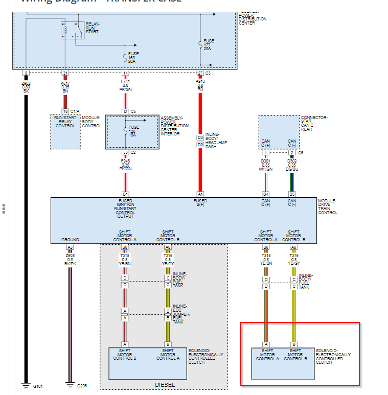

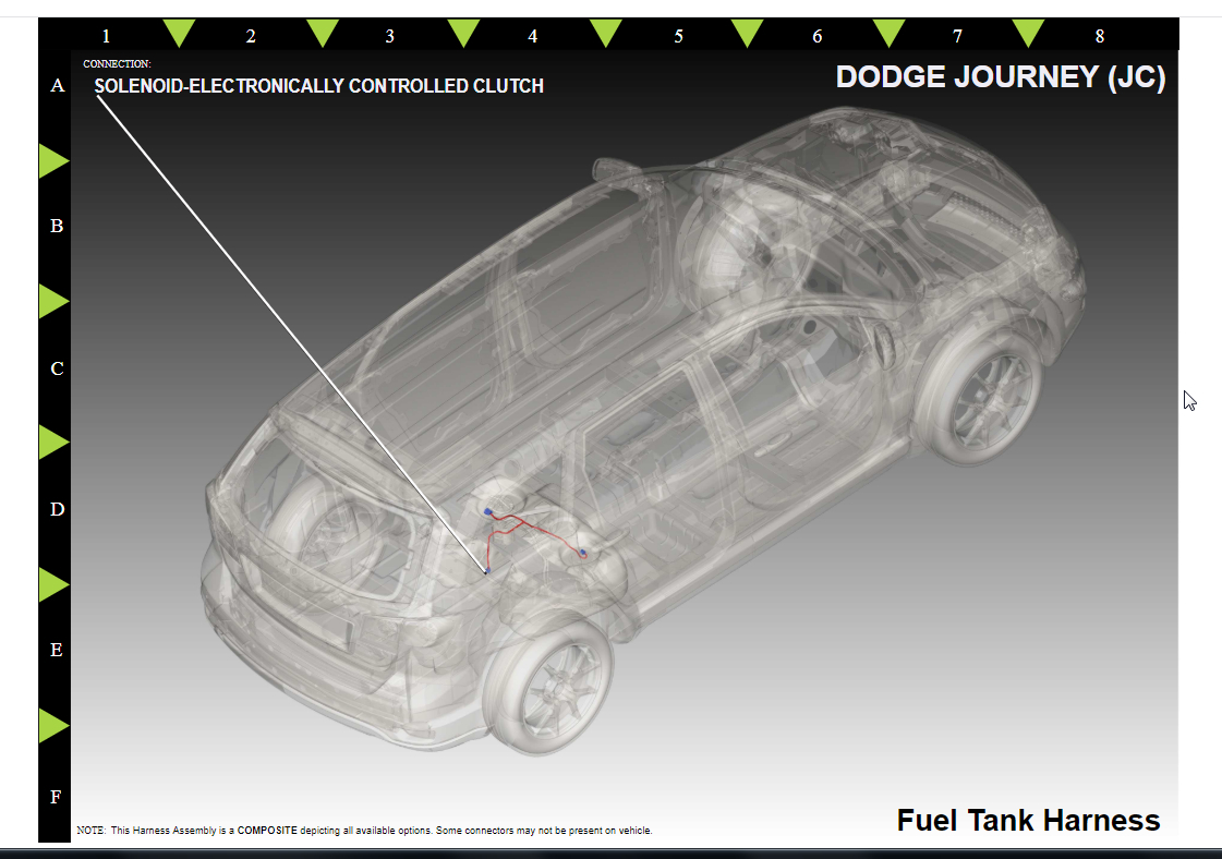

Okay. That is good info. Let's try unplugging the rear drive unit that is at the back of the drive shaft before the differential. Basically this is a clutch that gets engaged when it needs 4WD on. If this does not make the noise when this is unhooked then we know the RDM is the issue. We can get into that detail if this proves out. If not, we will go in a different direction but we are getting close now that we can get things to make it happen and not to make it happen.
When you drive it with this connector unhooked, you may get a code but that is okay. Let me know if you have questions on this. Thanks
