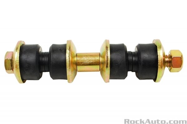

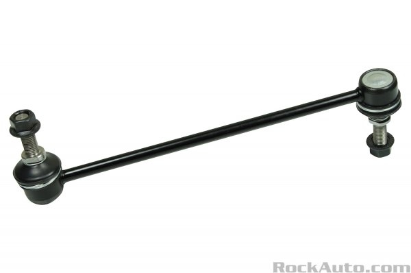

Most likely cause would be worn sway bar end links and the mount bushings. Next would be the A arm bushings and finally the strut bushings. Most are rubber and get squeezed until they fail, then you hear them rattle.
The front end links are not hard to change out you just need the correct wrenches or one wrench and a good pair of vice grips. I would also check the rear ones if equipped as they can rattle even worse. The fronts run from ten to twenty dollars each and the rears are about twenty dollars for both sides.

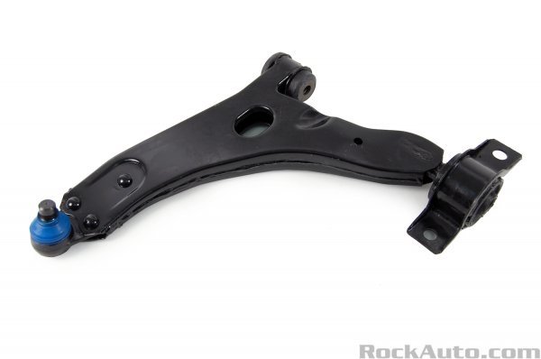

For the A arms you can save a lot of money by just buying the complete arm with all the bushings and a new ball joint. Those run about $60.00 to 100.00 each vs. the individual parts and time to replace them at closer to one hundred dollars per side.
You can easily find those parts online at RockAuto.com or check at a local parts store if you want to DIY it.
