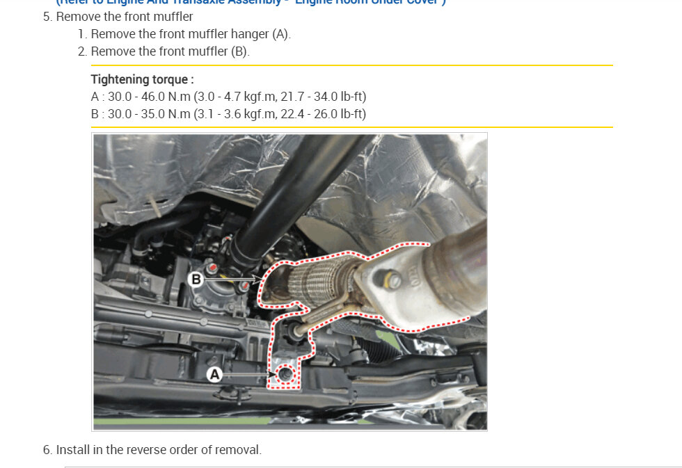

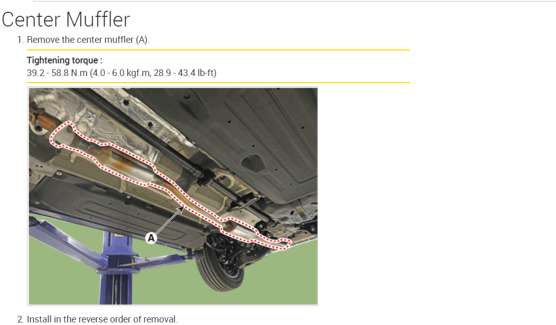

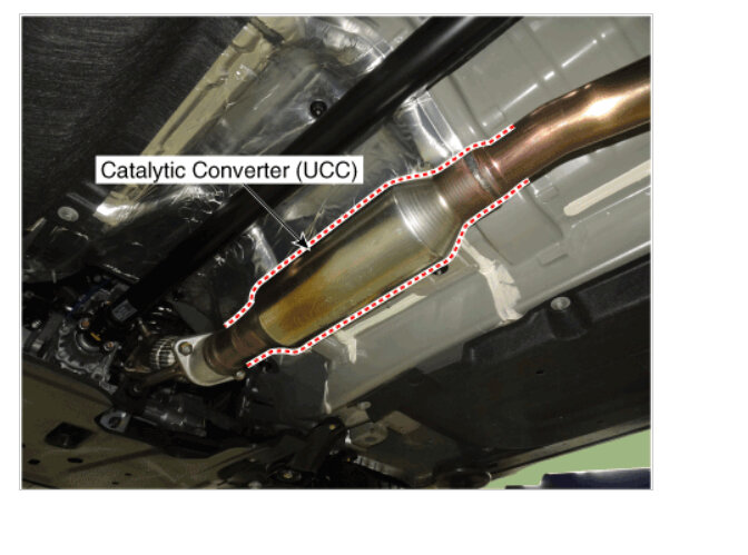

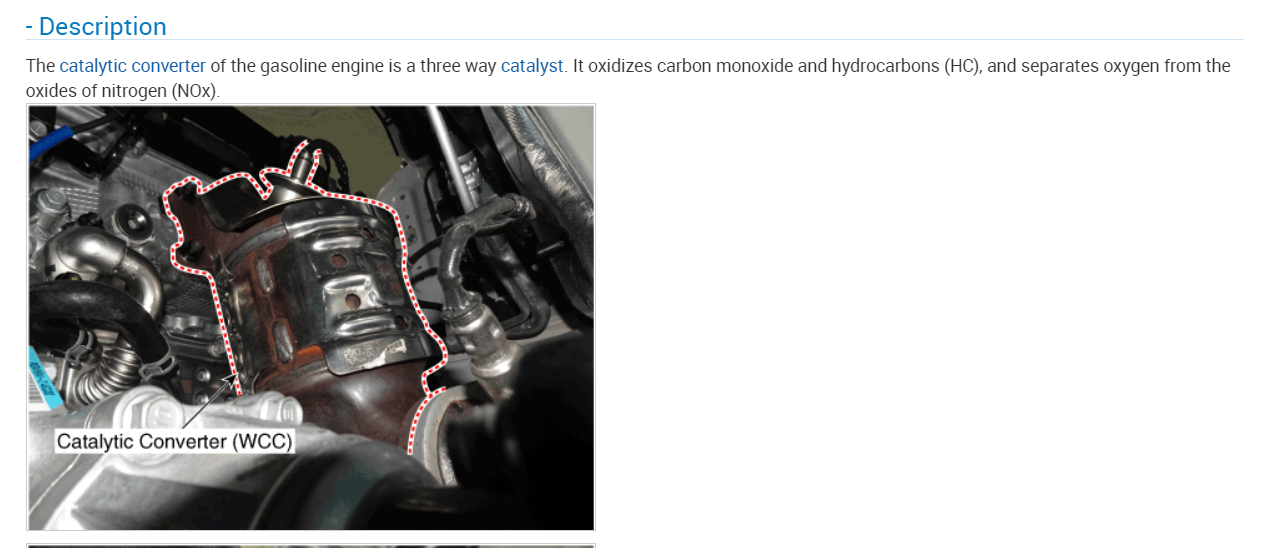

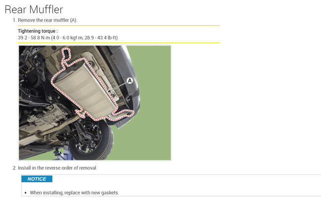

Thank you for the video, it really helps. I did hear the noise and it sounds like a heat shield is loose on the exhaust system which coincides with your description with the engine speed and load. I would raise the car up (cold) and get underneath it to check the shielding to see if you can find anything loose. Here is a guide to help you raise the car up and the exhaust system diagrams.
Gently strike the exhaust system in different places using a rubber mallet until you hear the noise, especially the catalytic converter. Please get back to me I am interested to see what you find. Check the images below.
