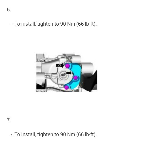

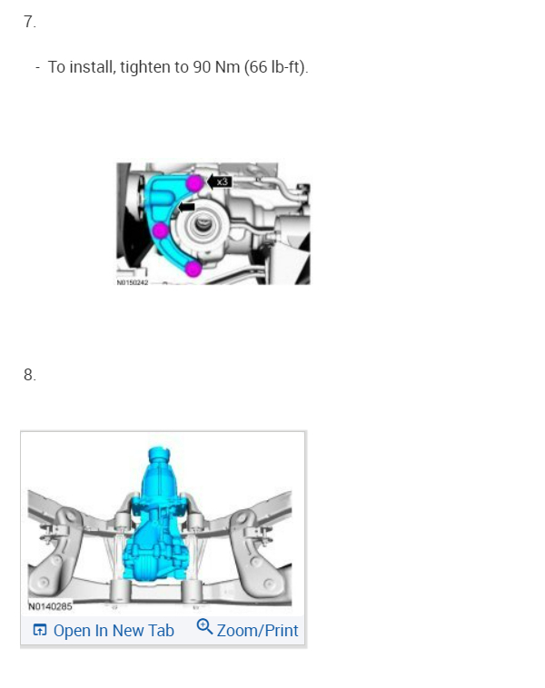

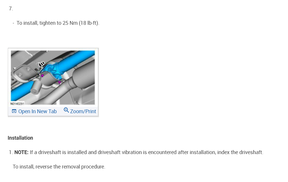

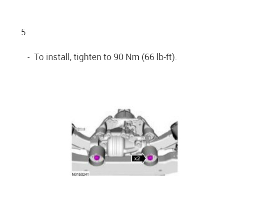

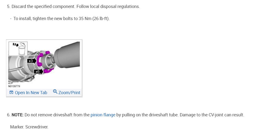

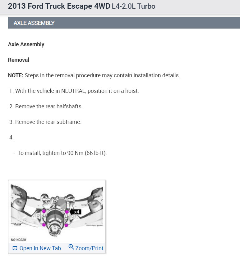

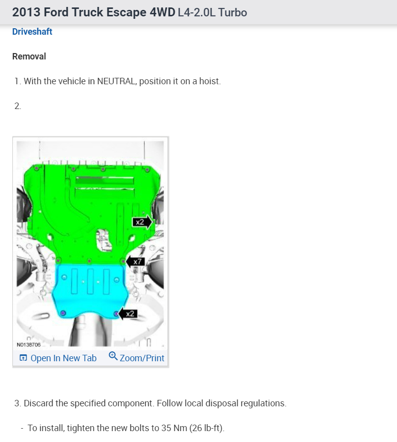

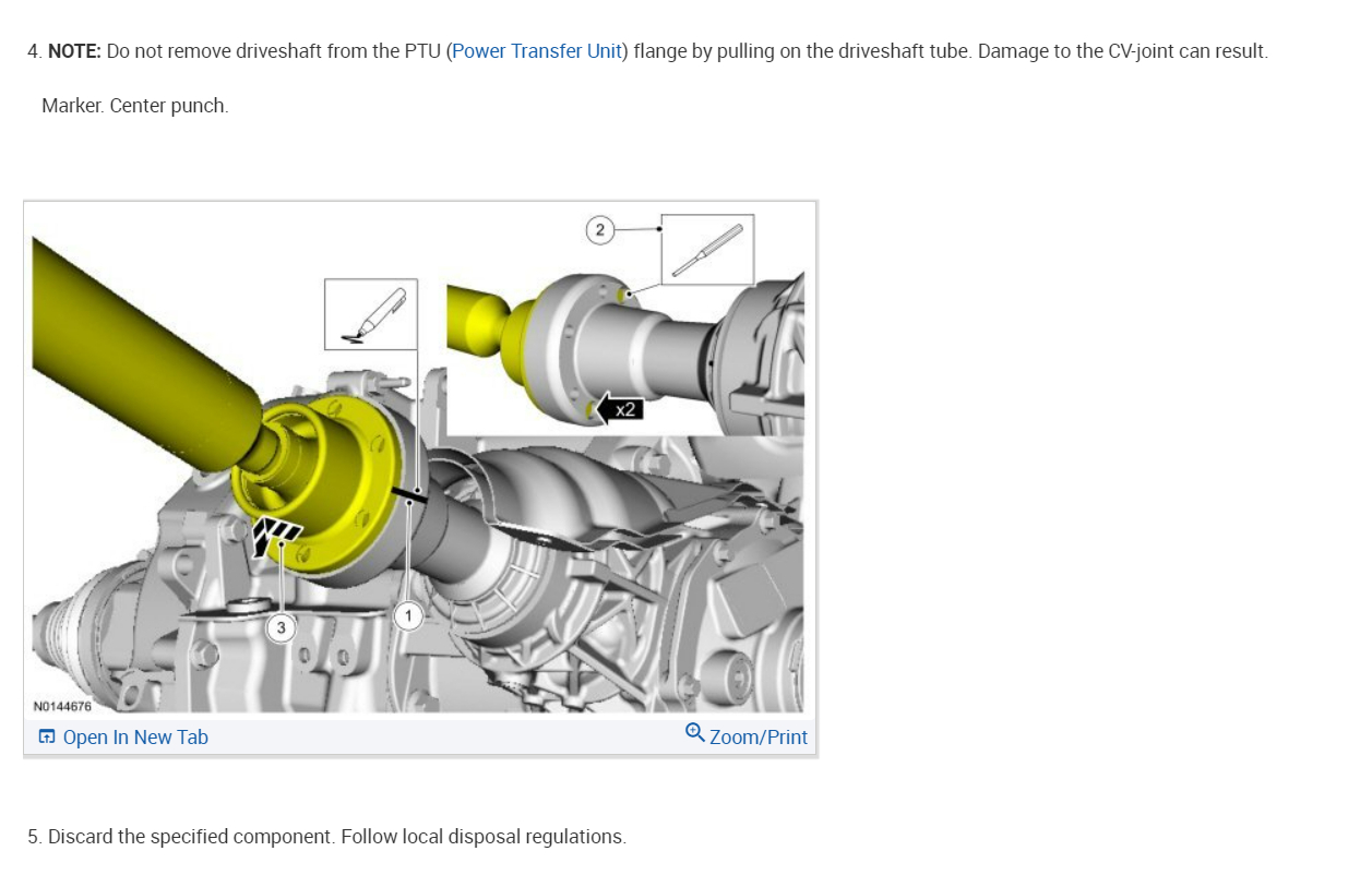

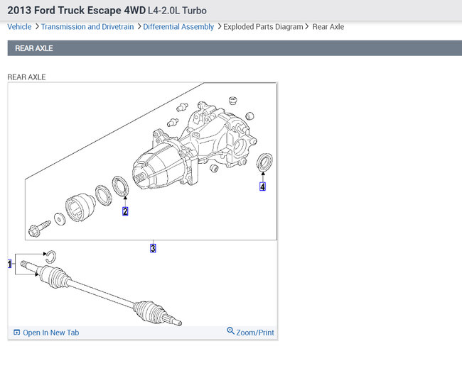

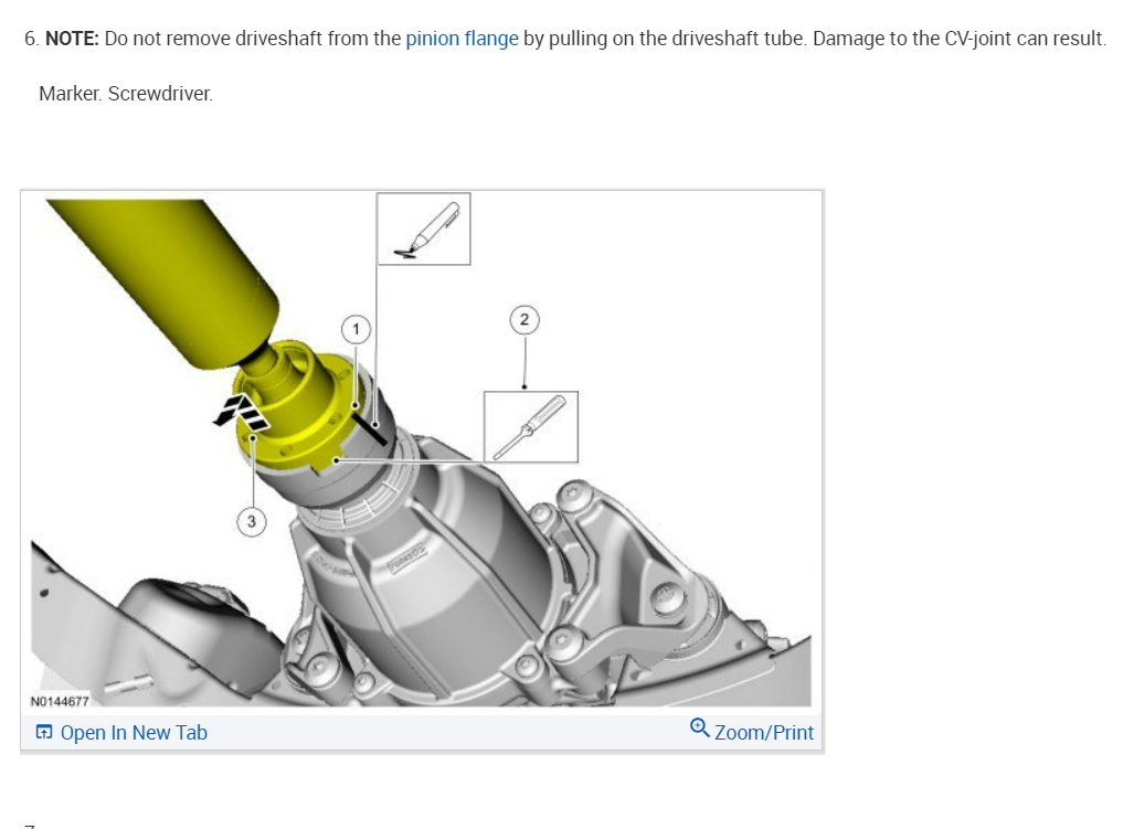

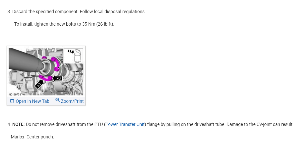

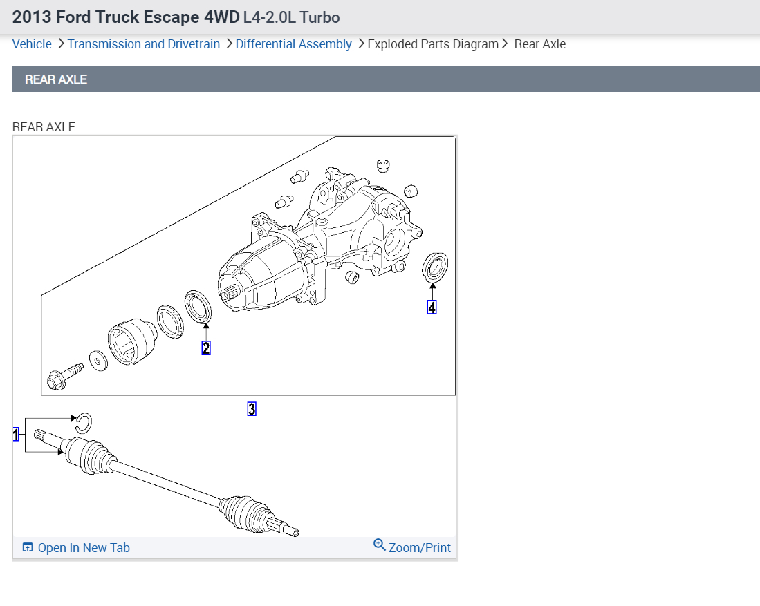

and here is the driveshaft and rear differential images so we both can see what is going on and what might be causing the noise. Check out the images (below). Let us know what happens and please upload pictures or videos of the problem so we can see what's going on.
