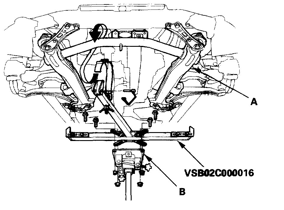

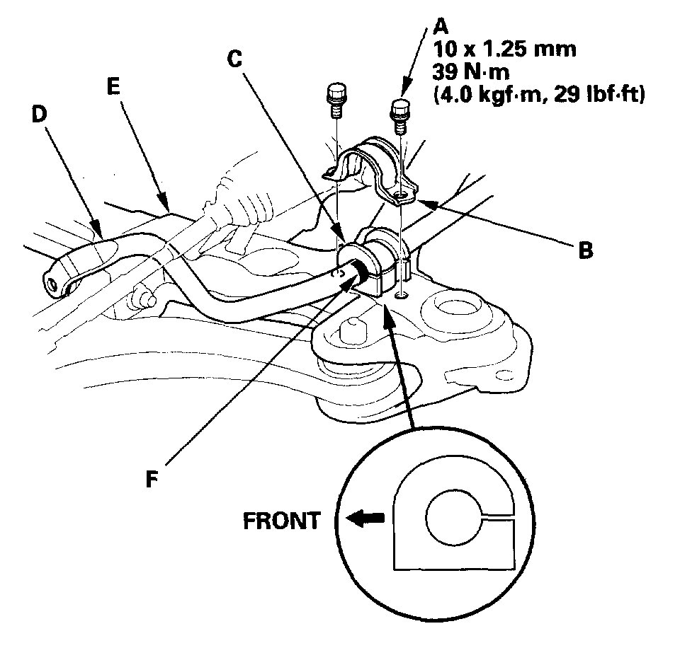

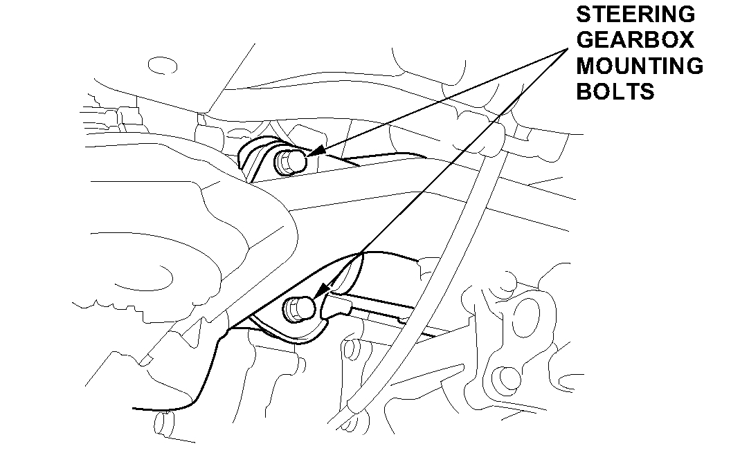

Next, I would like to add that there is a technical service bulletin (TSB) from some years back that defined a pop, clunk when turning. It was related to the steering box bolts. If they are loose enough, you may be hearing them. Pictures 1 and 2 correlate with this TSB. Additionally, at the end it explains how to diagnose if this is the problem. I listed this because the steering box is on the front driver's side of the vehicle.

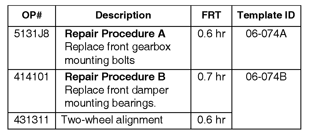

^ Replace the two driver's side gearbox mounting bolts: see REPAIR PROCEDURE A, or
^ Replace both front damper mounting bearings: see REPAIR PROCEDURE B.

WARRANTY CLAIM INFORMATION
In warranty:
The normal warranty applies.
Failed Part: Repair Procedure A P/N 90161-SJC-A00, H/C 8116873 Repair Procedure B P/N 51 726-SJC-A01, H/C 7929144 Defect Code: 07405 Symptom Code: 04201 Skill Level: Repair Technician
Out of warranty:
Any repair performed after warranty expiration may be eligible for goodwill consideration by the District Parts and Service Manager or your Zone Office. You must request consideration, and get a decision, before starting work.

3. Have an assistant turn the steering wheel quickly from the left to the right while you inspect the steering gearbox pinion area. Look for the gearbox moving from side-to-side on the subframe, causing it to thump or pop.
4. Raise the vehicle on a lift.
5. Inspect the two bolts holding the gearbox to the subframe in the pinion shaft area on the driver's side.
^ If the bolts are loose, go to REPAIR PROCEDURE A.
^ If the bolts are tight, go to step 6.

Replace the two steering gearbox mounting bolts in the pinion shaft area. Torque the new bolts to 58 N.m (43 ft-lb).

I added pictures 3 and 4 to show you what the sway bar and bushings look like. For you to actually seem them from under the front of the vehicle, you will have to remove the plastic splash shield.
