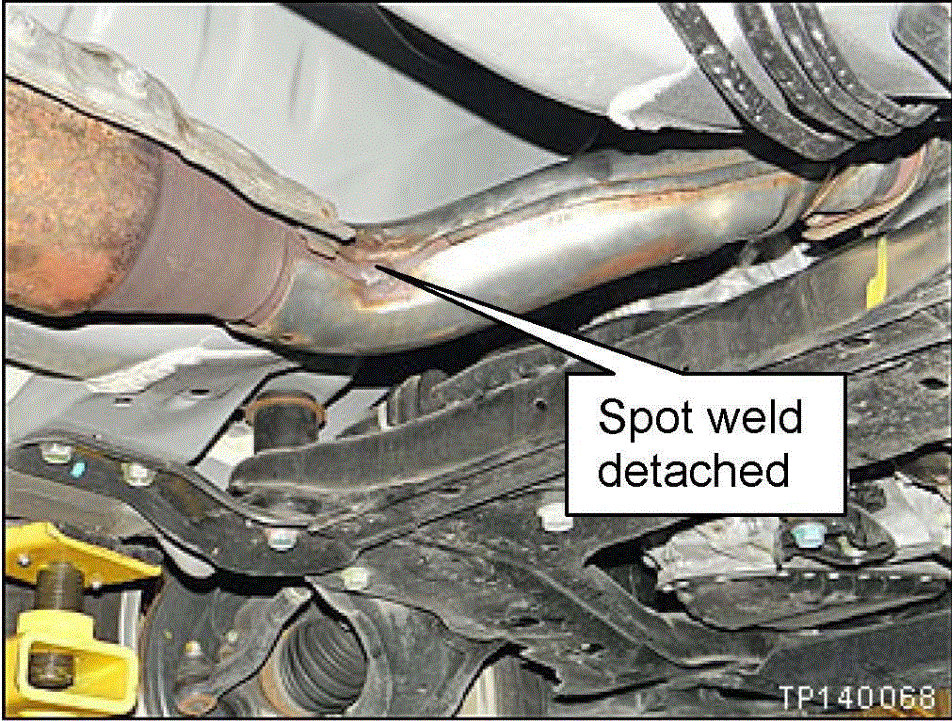

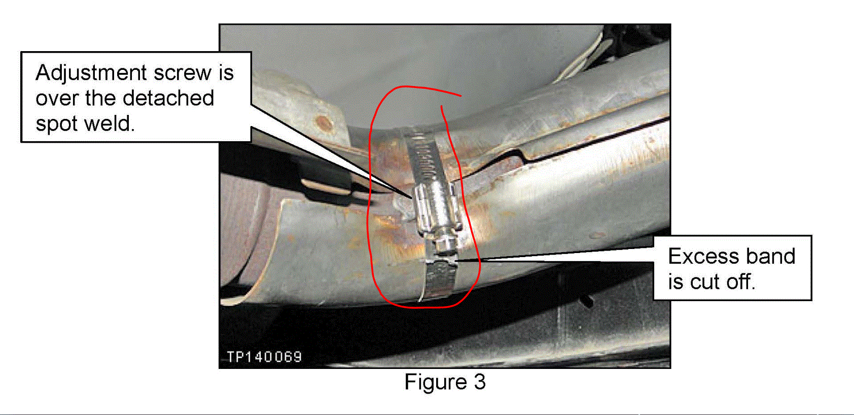

Now, I attached two pics below. A short while back, there was a technical service bulletin regarding a heat shield weld breaking and causing noise. The first pic shows the affected heat shield, and pic 2 shows how Nissan recommends repairing it. The pipe is under the vehicle approximately where your feet would be above in the driver's seat.
