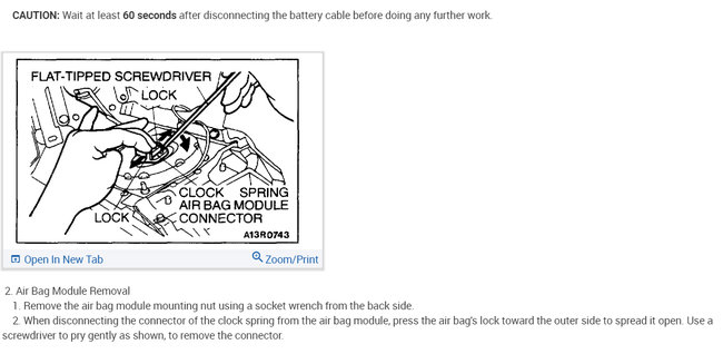

There seems to be something loose inside the steering column of my 1998 Mitsubishi Montero 3.5L, 4x4, so that when i drive over a bump it both feels and sounds like something is loose in the steering wheel. The dealer said it is coming from inside the SRS assembly but it is not dangerous nor anything is malfunctioning.
I need to fix this so it rattling or go crazy.
Can you help with
1) exact or possible causes
2) the fix

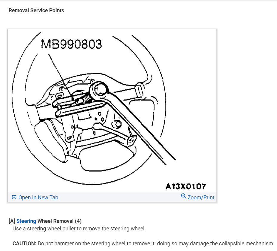

3) how do i take the steering wheel off safely
Can you help with
2) the fix
