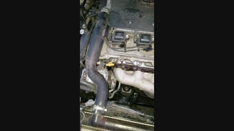

Also, I replaced the motor mounts but could not get to the one located down in the back. But attached is the video.
Jun 18, 2018 at 9:24 PM

That sounds like a cracked flex plate. To eliminate anything on the front end you could remove the accessory drive belt on a cold engine and start it. If the noise is still there it is not the accessories. You might be able to slip a camera up into the bell housing and look at it directly. Or use a mechanics stethoscope to listen to the parts of the engine and track it down.
Jun 22, 2018 at 12:22 AM

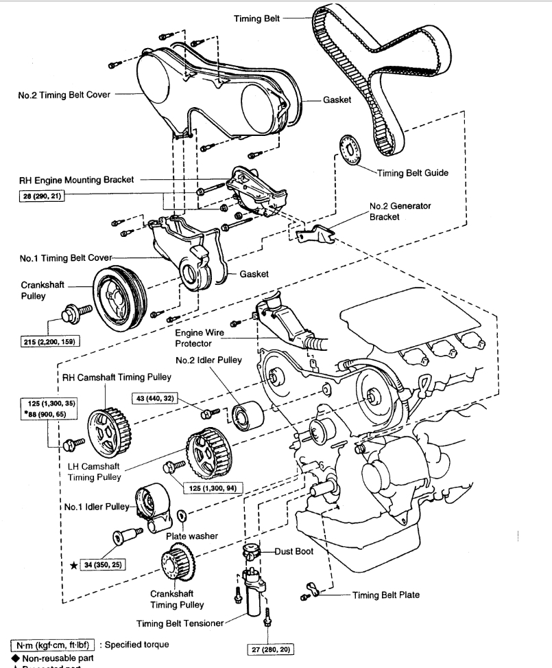

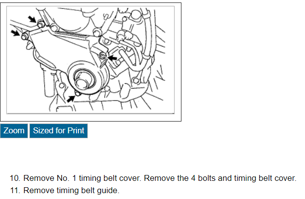

I would remove the serpentine belt and start the engine. If the noise is still there it will be the timing belt and tensioner problem. Thanks for the video really helps.
You will need to remove the front balancer. To get started here is a guide that will show you how and the diagrams on how to change the timing belt and tension-er:
https://www.2carpros.com/articles/how-a-harmonic-balancer-works
