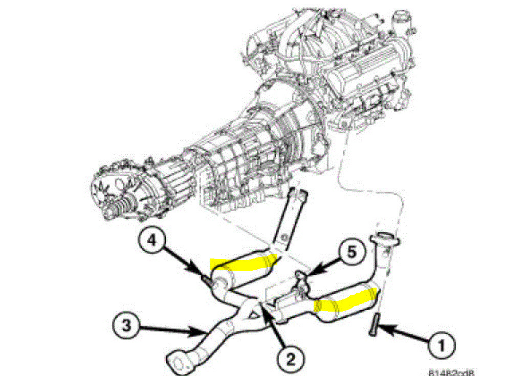

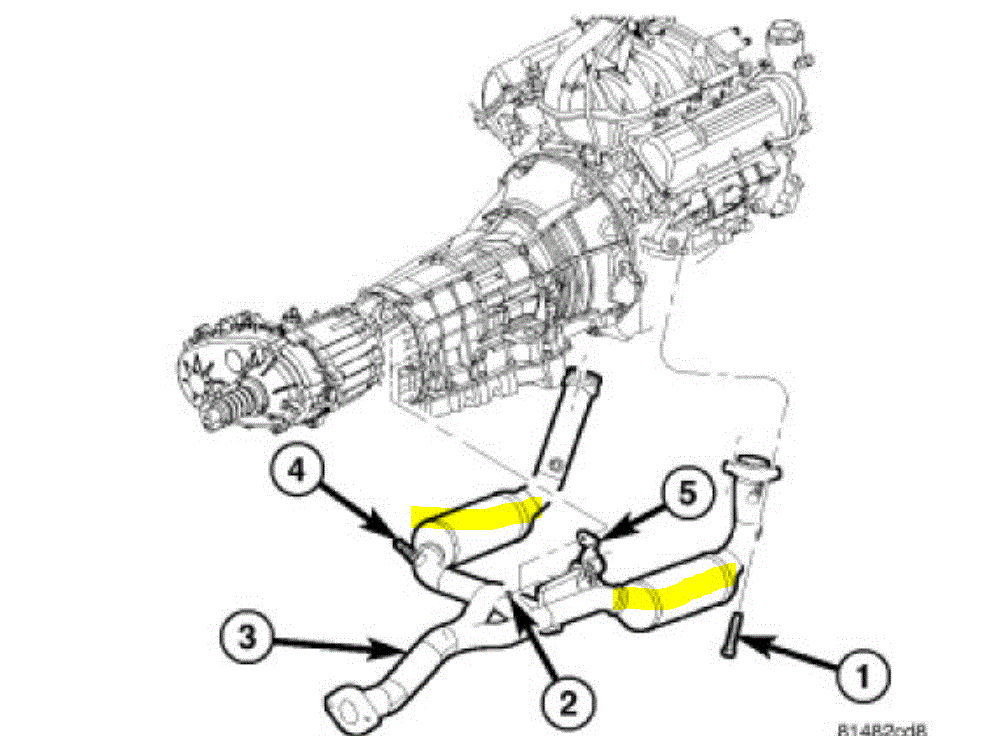

It could be one of the catalytic converters has come loose internally. You wouldn't be able to see it, but they can make a rattling noise.
Take a rubber mallet and tap on the exhaust to see if you can recreate the sound. I attached a pic of their locations.
Also, make sure the same type of thing hasn't happened in the muffler.
