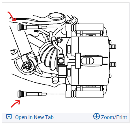

Yep, thanks for the video. I would remove the tire that is making the noise and check the brake caliper, it sounds like one of the bolts fell out and the caliper is loose, please check the image below to see what I am talking about, also here is a guide as well:
https://www.2carpros.com/articles/wheel-removal-and-re-installation
On a side note, I see your account has 3 other questions that were never posted, did you have a problem with the site or? Check out the images (below). Please upload pictures or videos in your response.
