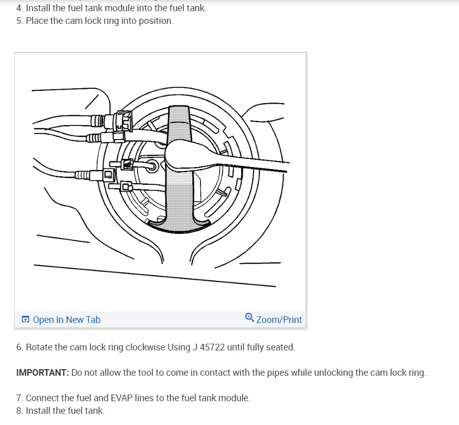

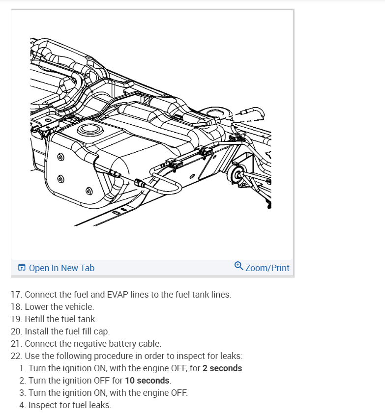

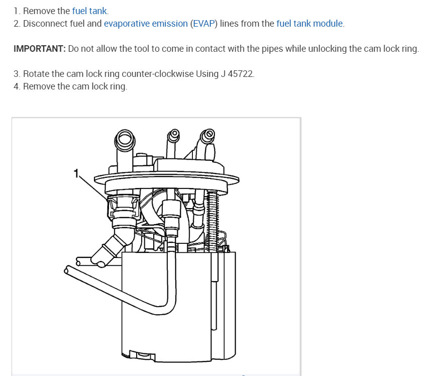

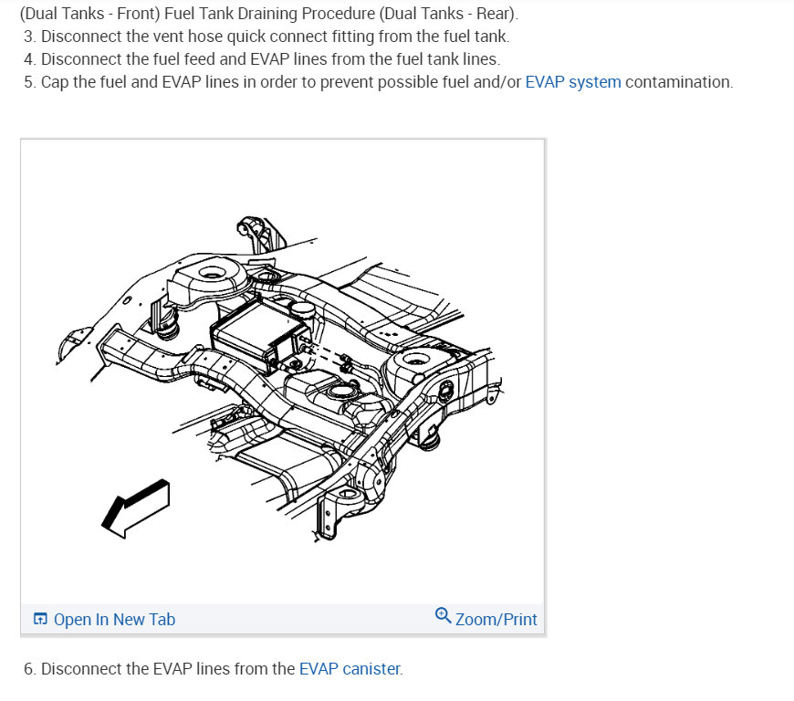

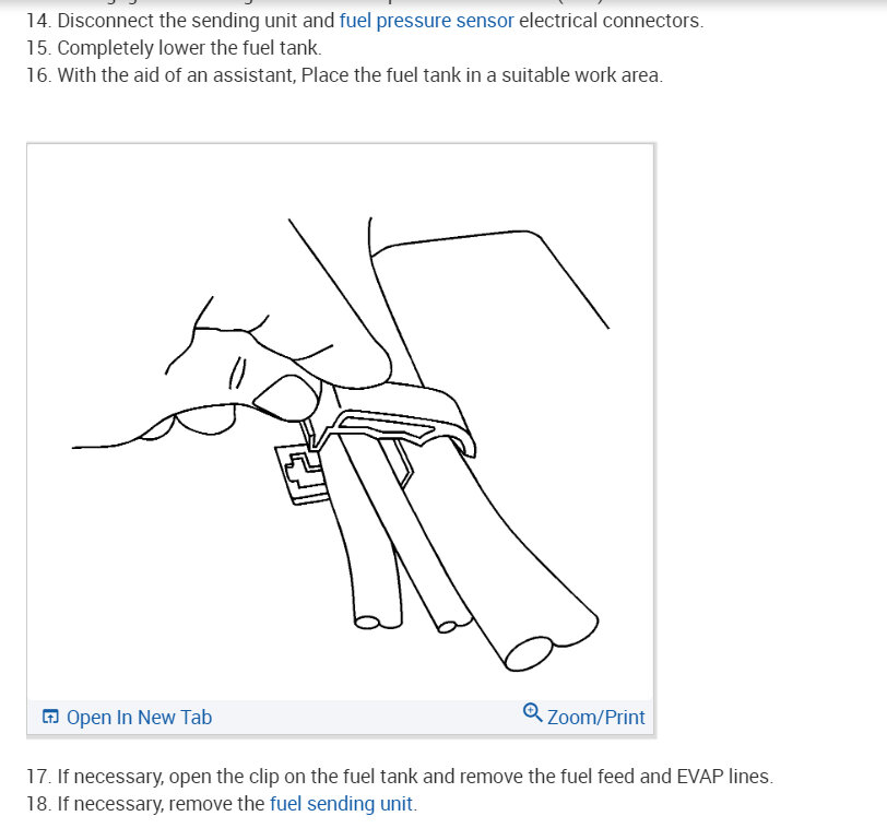

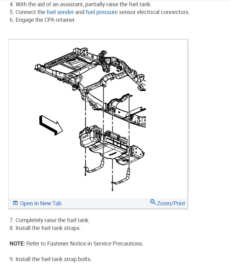

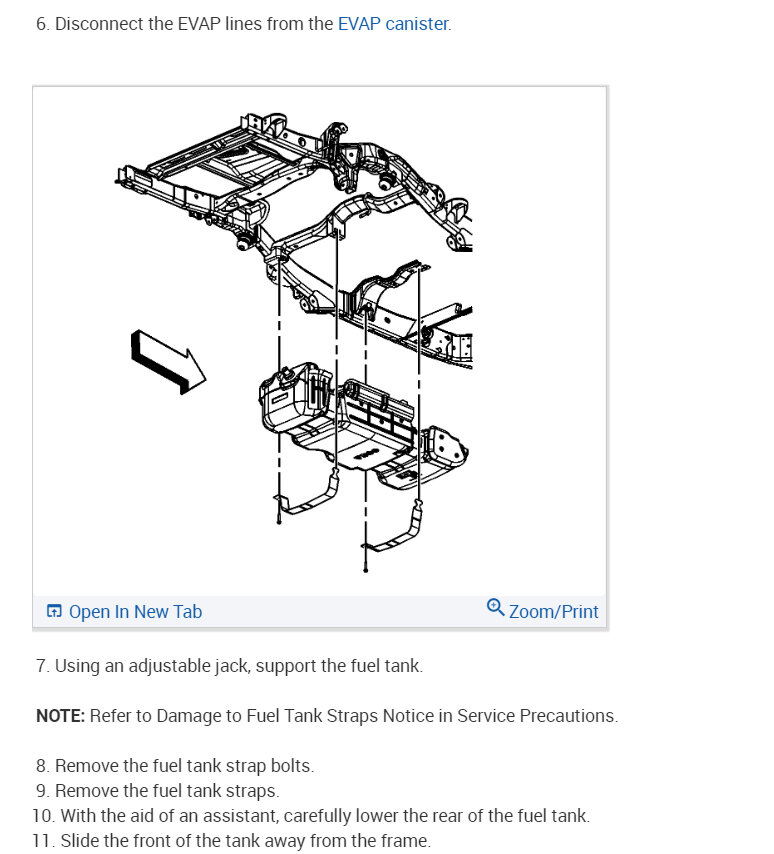

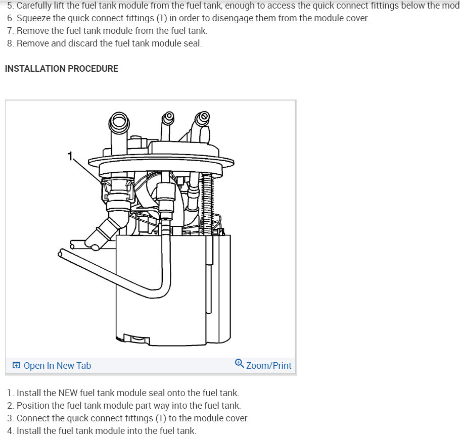

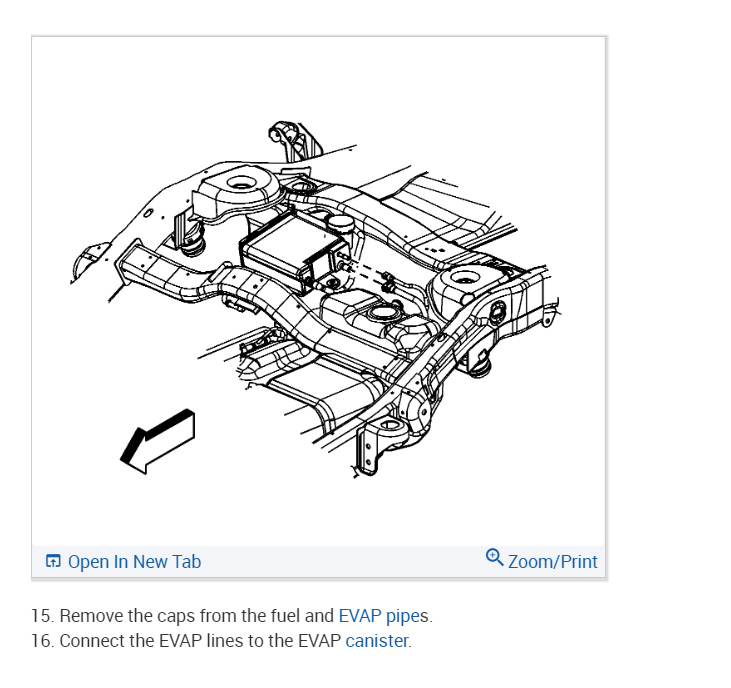

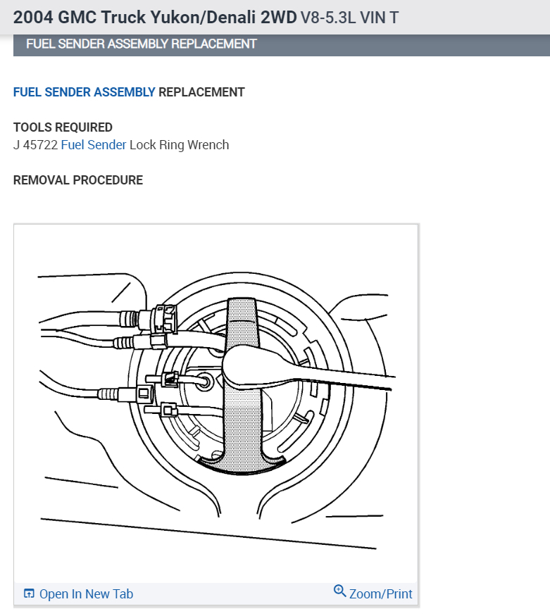

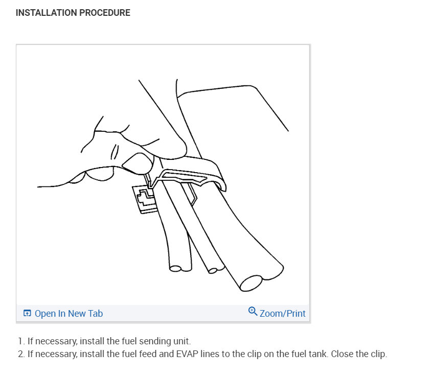

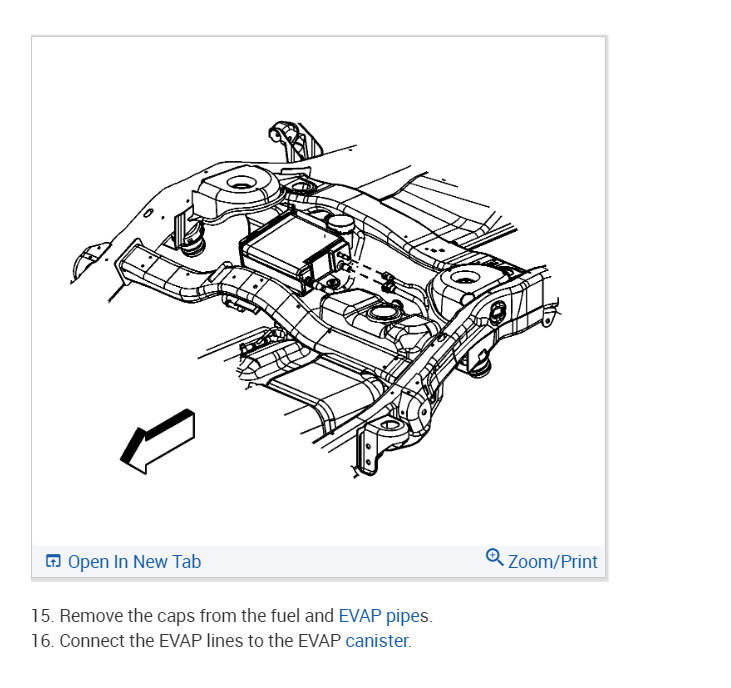

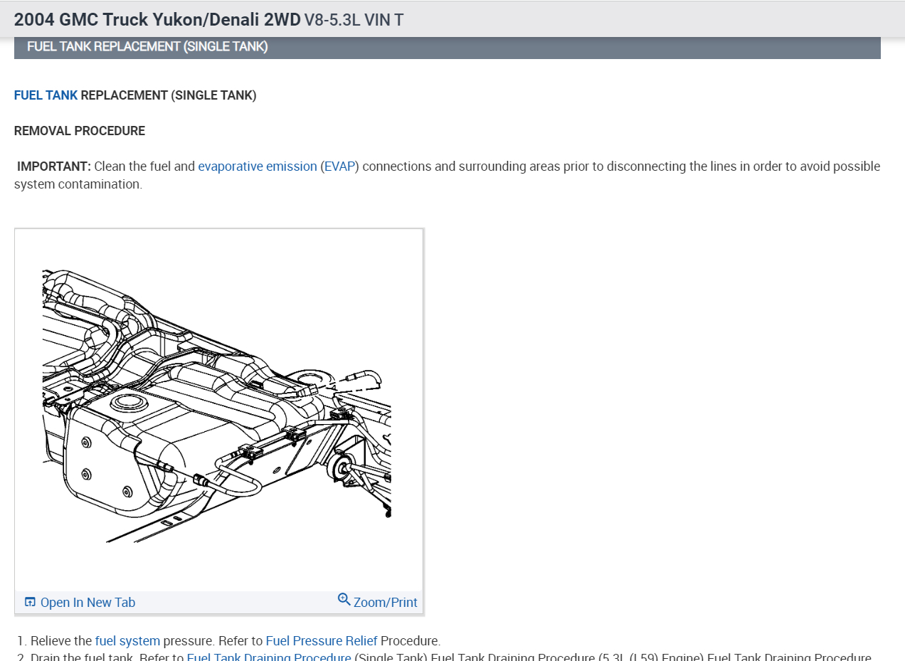

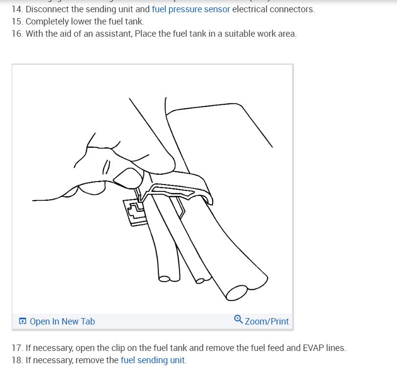

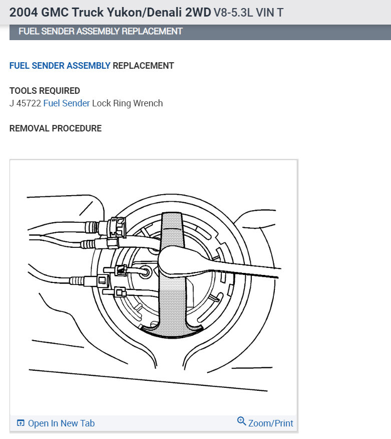

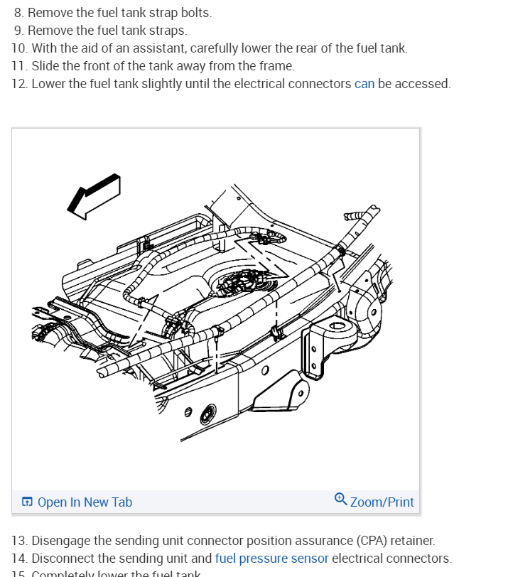

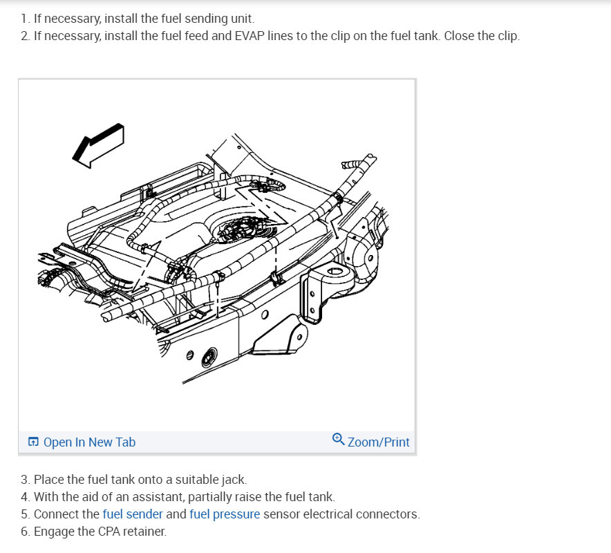

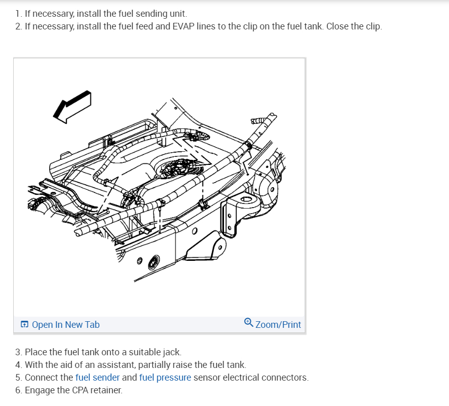

It is common for these cars for the fuel pump to go out, when the engine stops running turn the key off, then back on again without cranking the engine over you should hear the pump running in the tank for about 5 seconds if not, the pump is bad. here is how you can change it out in the images below. Please let us know what you find. We are interested to see what it is.
Nov 20, 2022 at 11:44 AM
