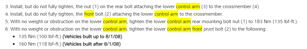

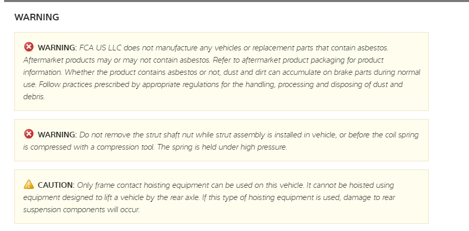

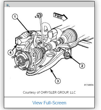

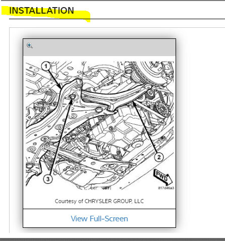

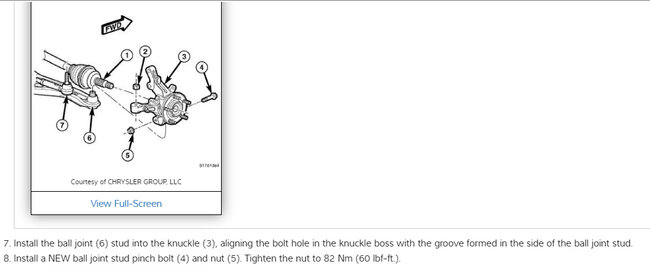

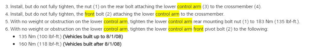

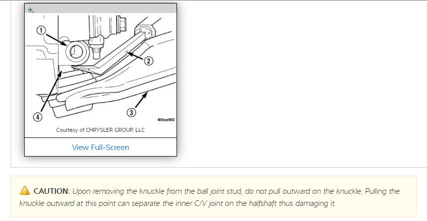

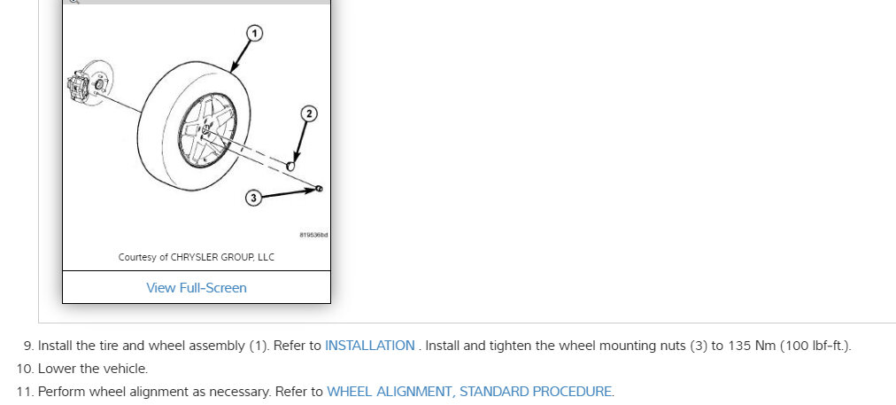

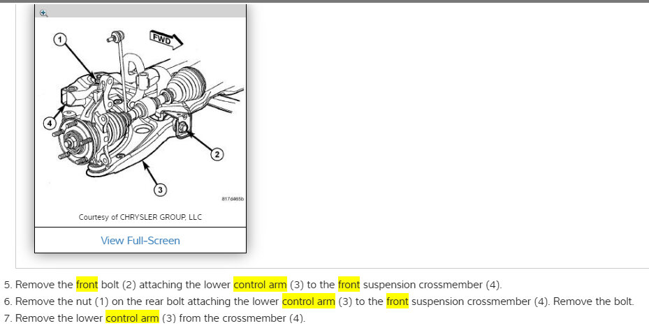

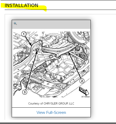

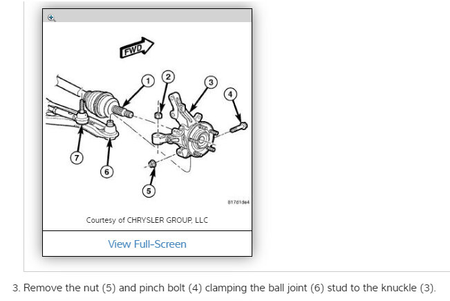

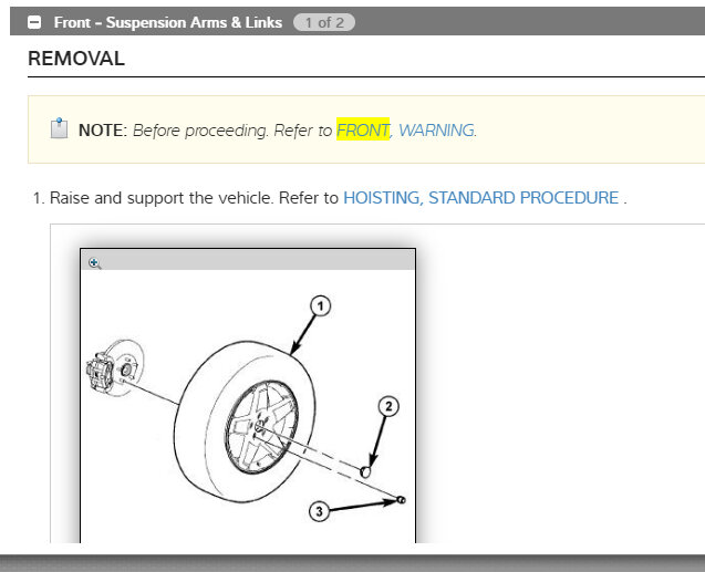

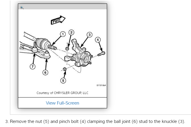

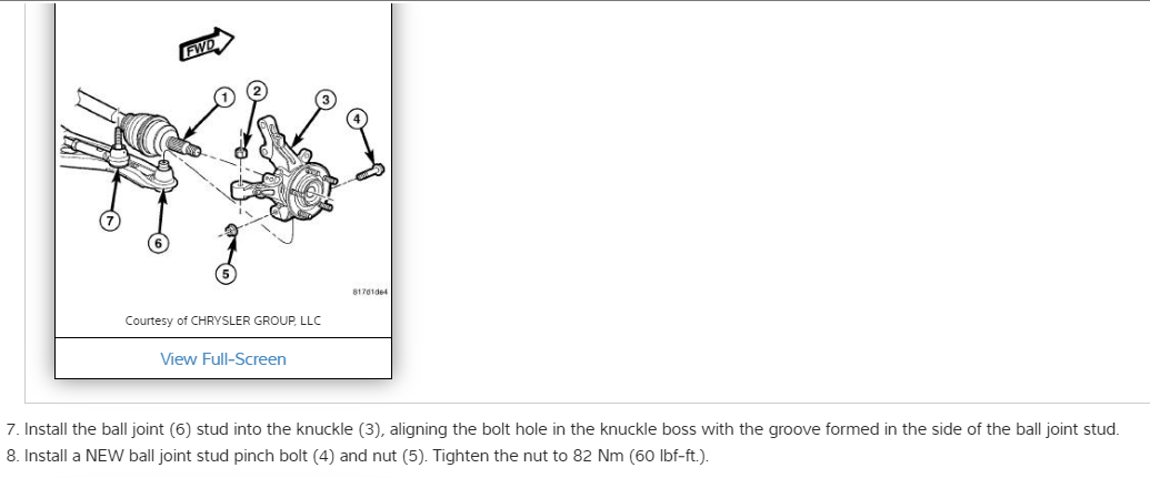

If it is that loose, that is just as dangerous. It has to be wearing the tires.
If you look below, I attached the directions for removing and replacing the lower control arm. I believe this is sold as a unit with the bushings and ball joint installed. I know I've tried to replace just a ball joint, and it was basically impossible. LOL
Let me know if this helps you or if you have other questions.
See pics below.
