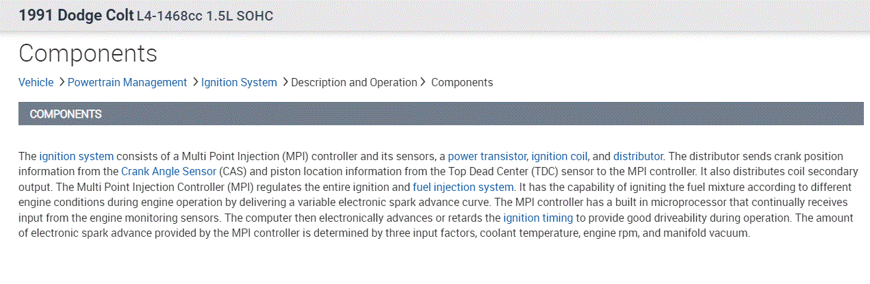

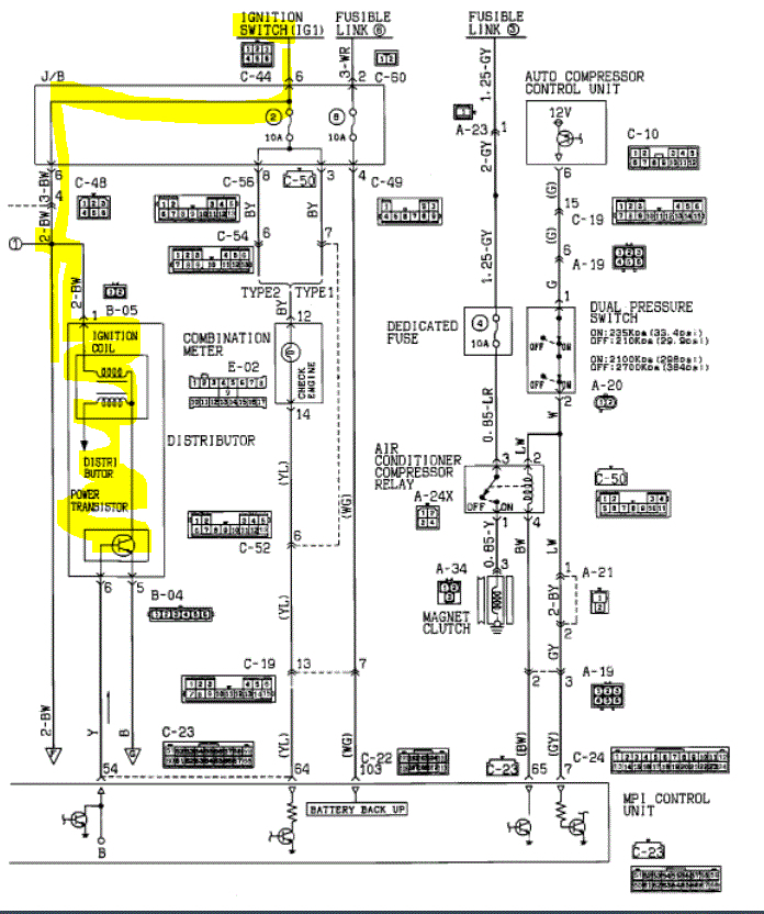

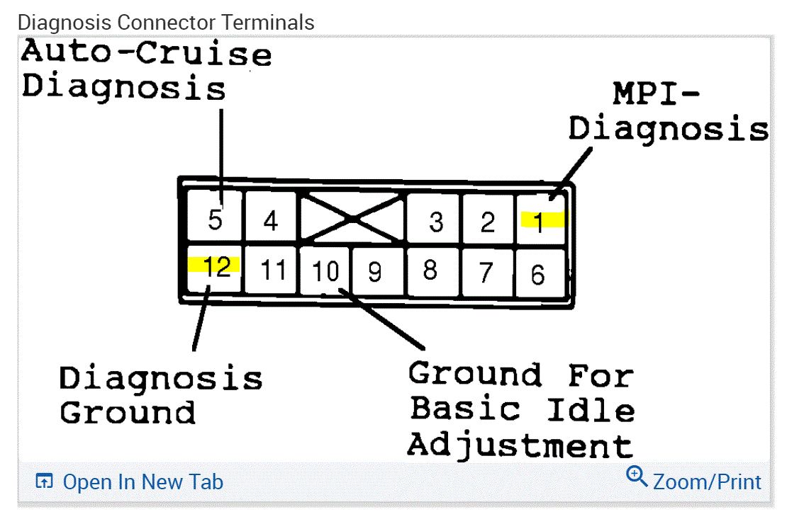

Distributor failed. Replaced and spark returned, but engine didn't run. so, the owner declined repair. Old distributor was re-installed, and I purchased the car. I installed another new distributor, but this time it didn't fix the spark. Discovered fuel pump wasn't getting power from MPI relay. Test procedure determined failure and new MPI relay installed. Now has fuel but still no spark. I've also replaced the spark plugs and wires.
