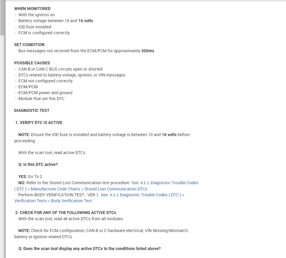

If the car stalls out it could any number of things. When the car is not running is when you would have to check for the cause. I've attached a guide to help. We need to try to narrow down the issue to fuel, spark, or electrical.

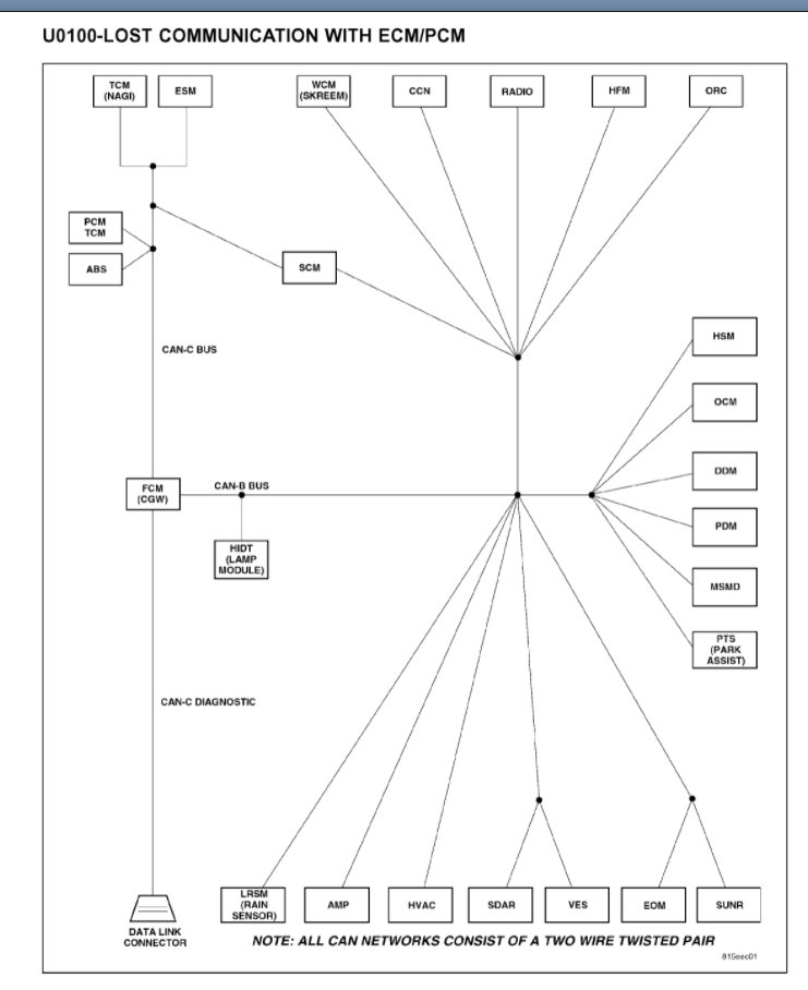

That U1000 code is a communication code, meaning that there is a module on the network that is not talking to the other modules. Which module was the code stored in? The PCM?

I have seen this a number of times. This code is set basically when another module is expecting some information from the PCM but it never gets it due to it shutting off.

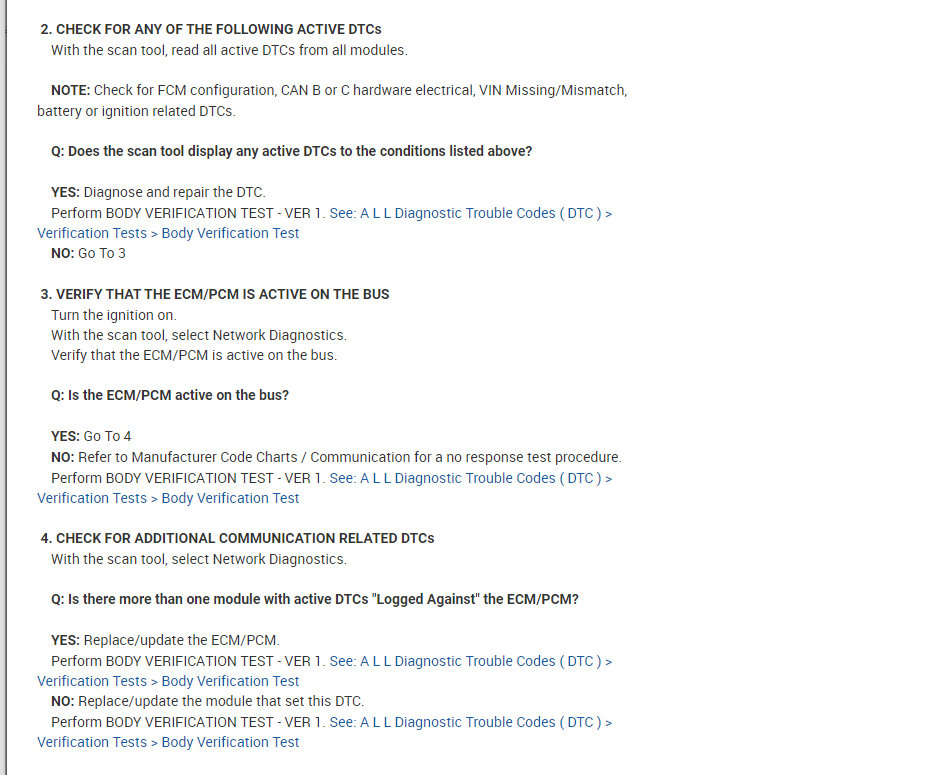

I am attaching the info below on this code. Please run through this info and let us know what you find with this. Thanks

Okay. That code is telling you that some other module like the transmission controller or ABS or drivetrain control module (4WD) was not able to communicate with the PCM when it needed to. So it is not going to name it in the title of the code. It is going to be in the scan tool that says something like ABS - U0100- PCM/ECM "A" lost communication. This means the ABS is what lost communication with the PCM. However, your tool may not give this level of detail at which point we should ignore it.
If this code is active when this happens then the module that set the code against the PCM would be the issue. However, if it is stored and it not there each time it stalls then it is not related or at least not causing the stall.
