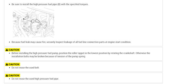

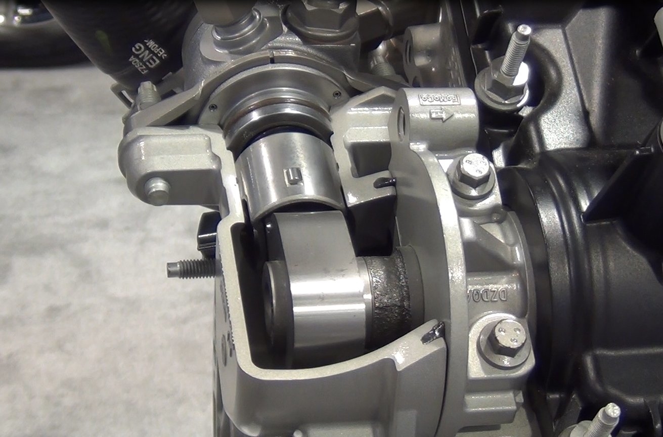

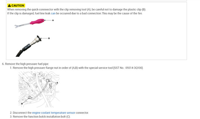

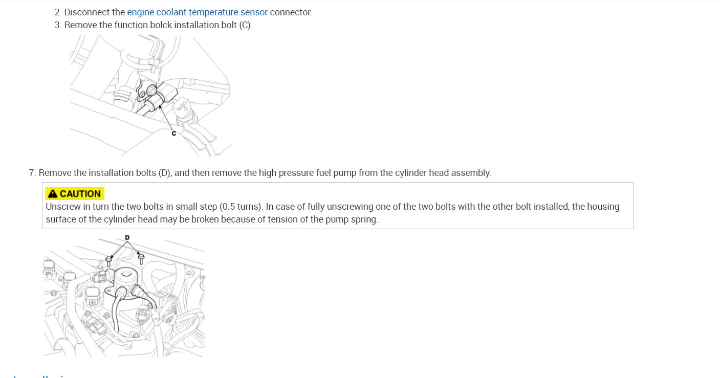

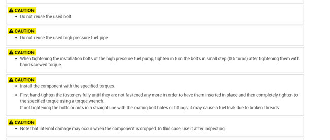

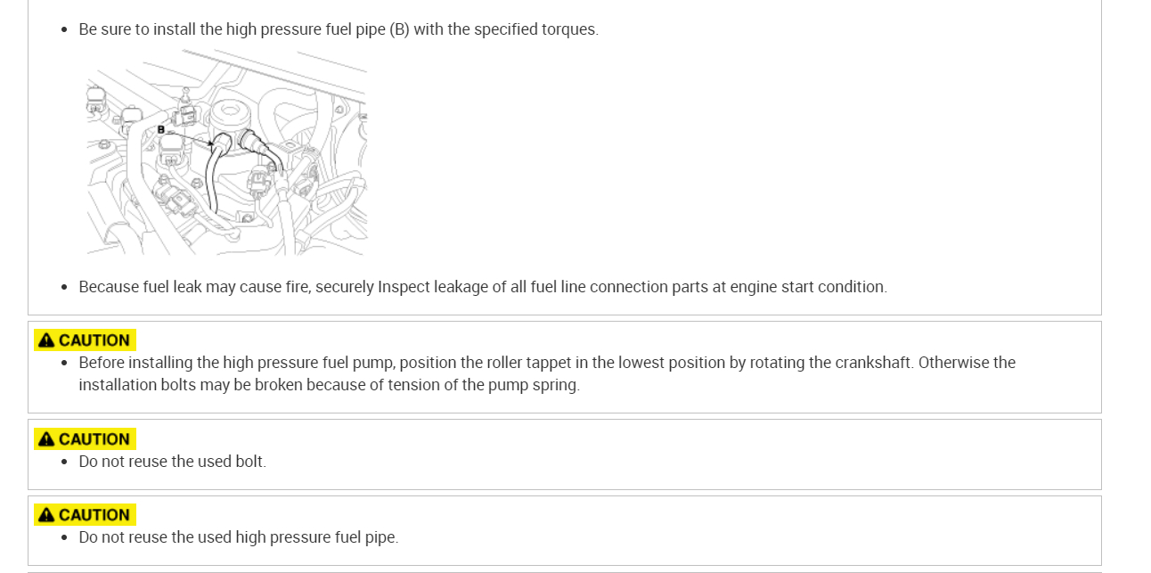

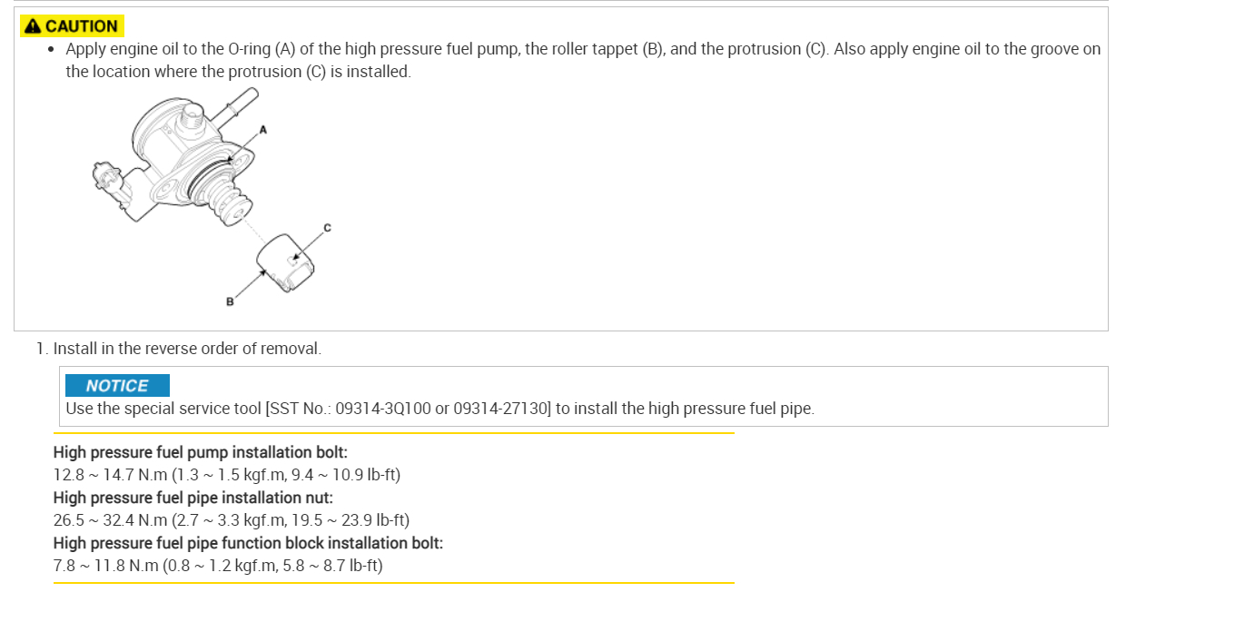

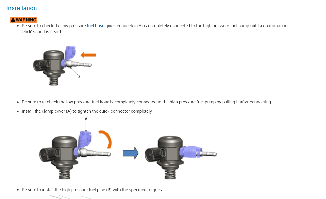

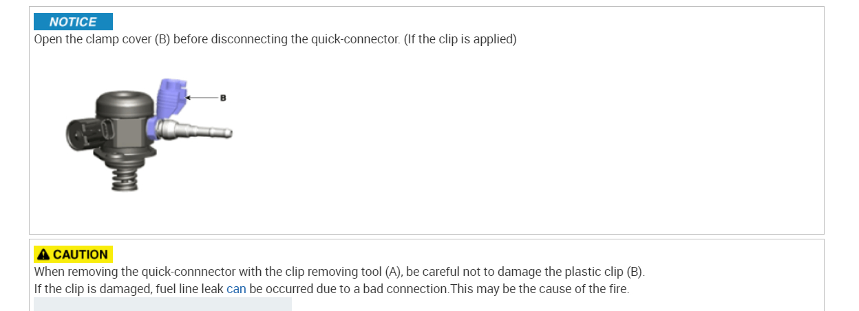

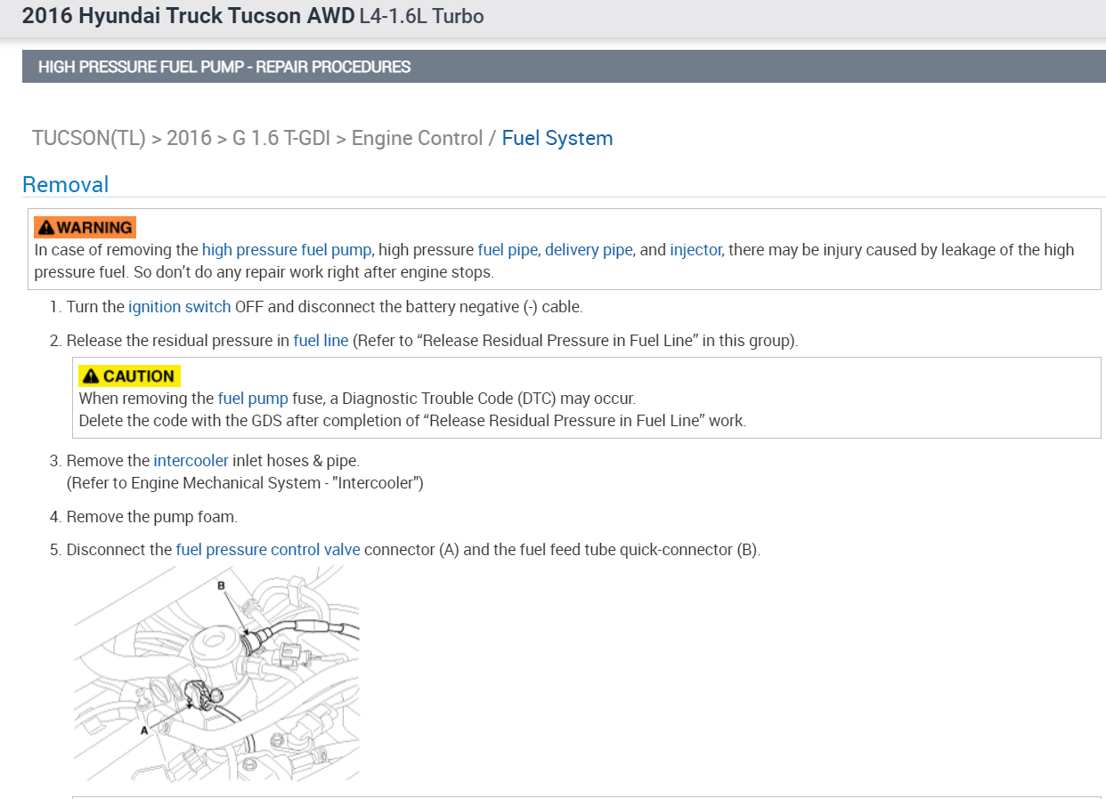

If there is no leak it sounds like the high-pressure pump is going out or the camshaft lobe that drives the pump is beginning to flatten out, which is common. Here is the pump location so you can remove it to inspect the cam lobe. Here is a cutaway of the high-pressure camshaft lobe as well. Check out the images (below). Please let us know what you find. We are interested to see what it is.

The MAP reading is correct, but the fuel pressure is low, can you remove the high-pressure fuel pump and check the camshaft lobe? This is a common problem. Follow the instructions above.
