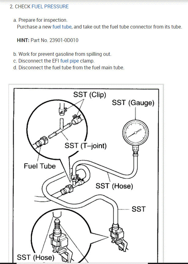

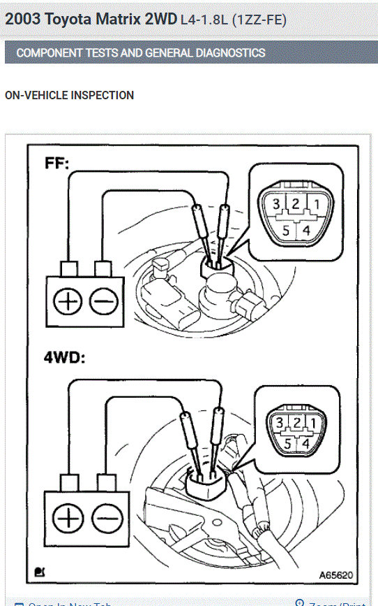

It is centered on cylinder 1 now. The P0171 indicates a rich fuel mixture. Are you certain the fuel pressure isn't high? If I recall, you didn't test fuel pressure yet and a leak down. That is what I recommend at this point.
Here is a link that shows in general how it's done:
I attached the directions specific to this vehicle below. They include the manufacturer's fuel pressure specifications.

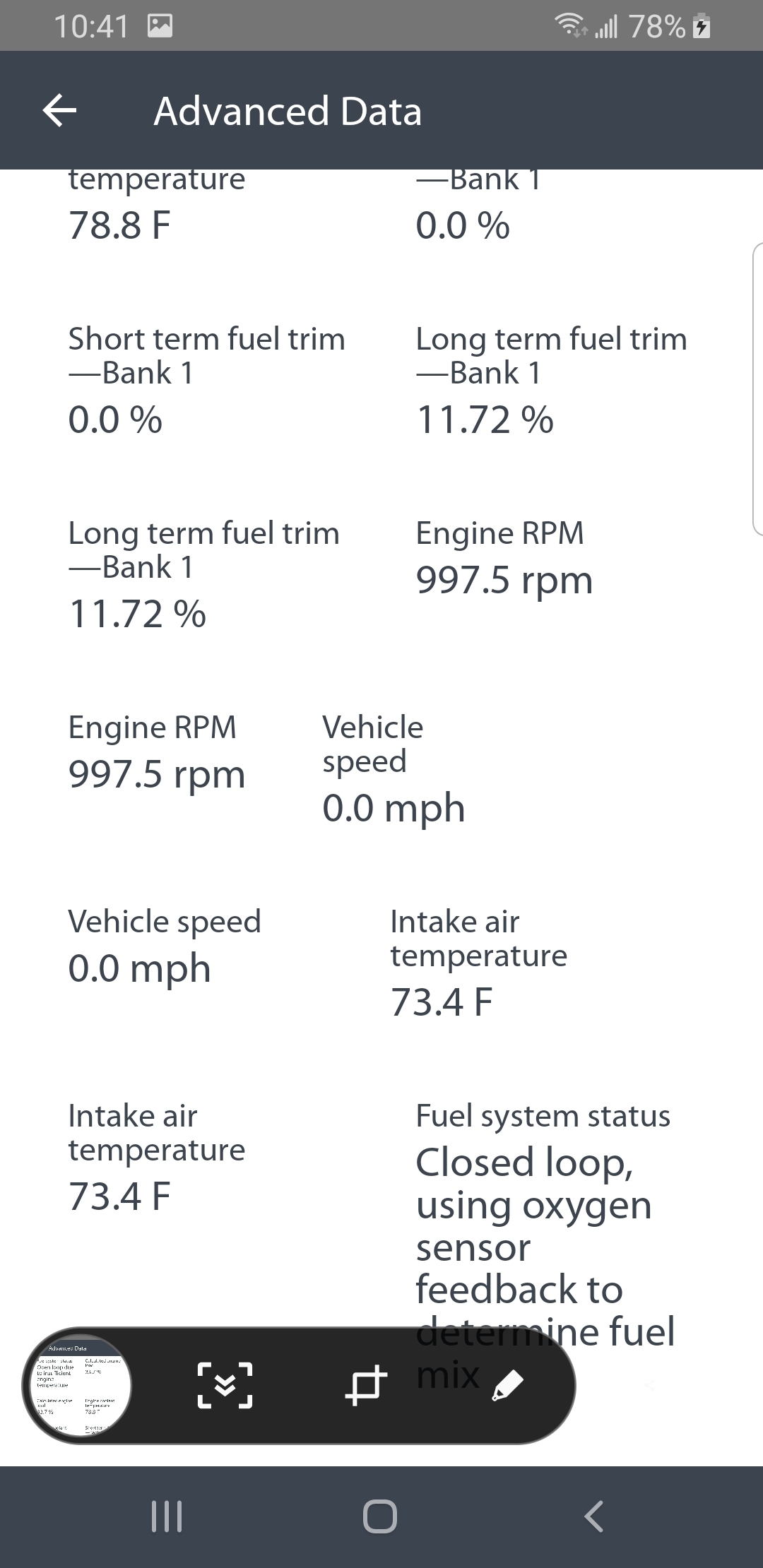

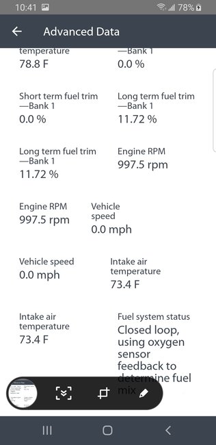

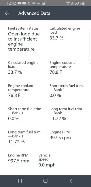

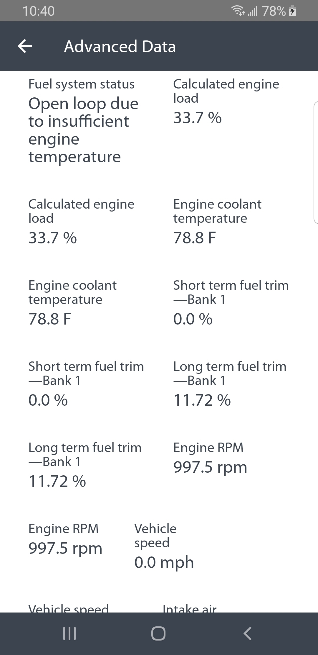

Here's the freeze frame data from this morning...

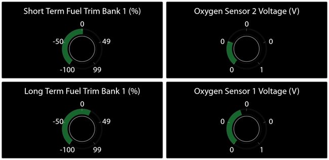

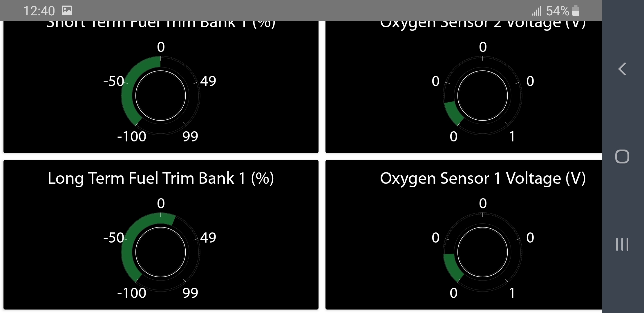

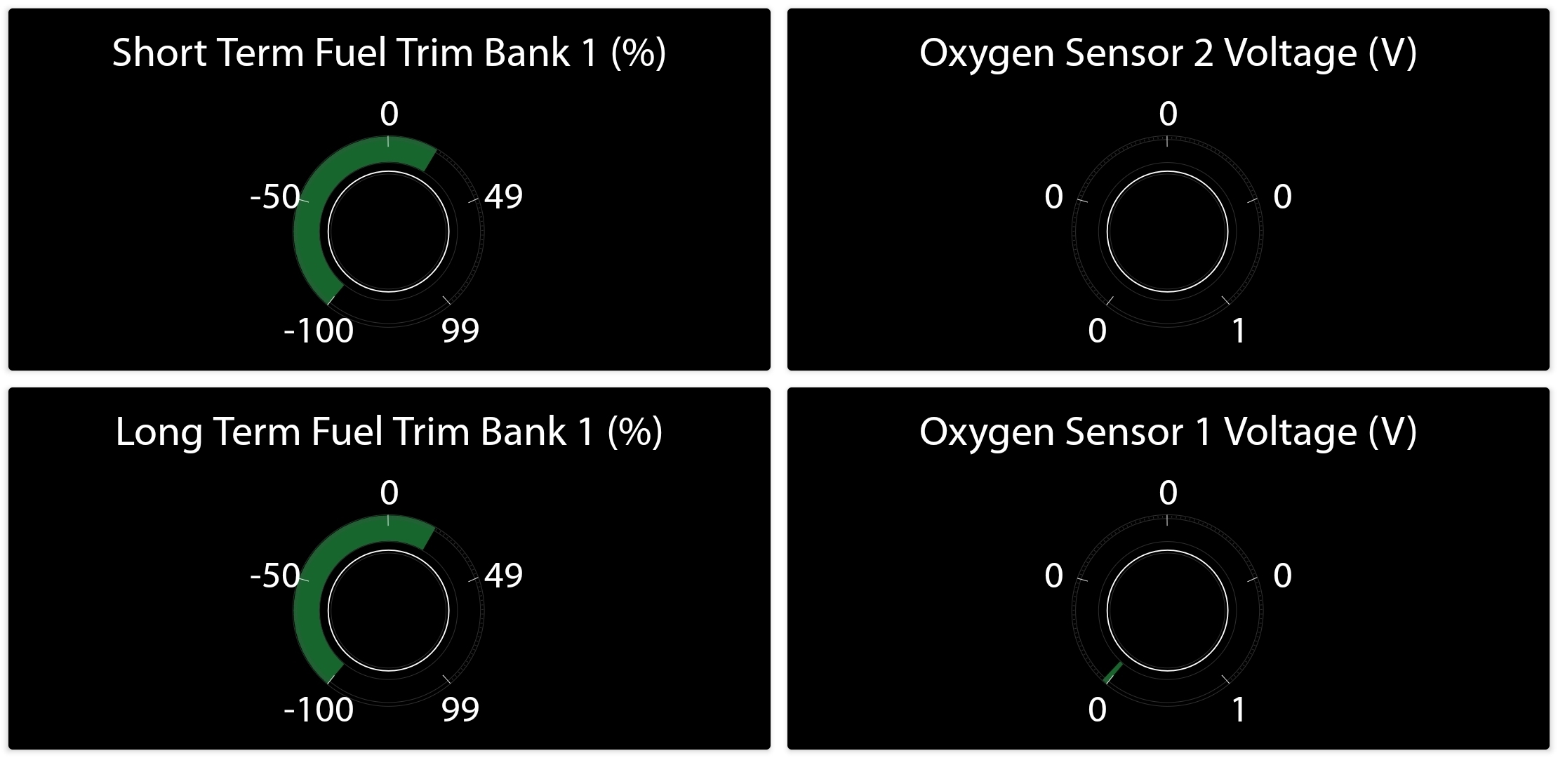

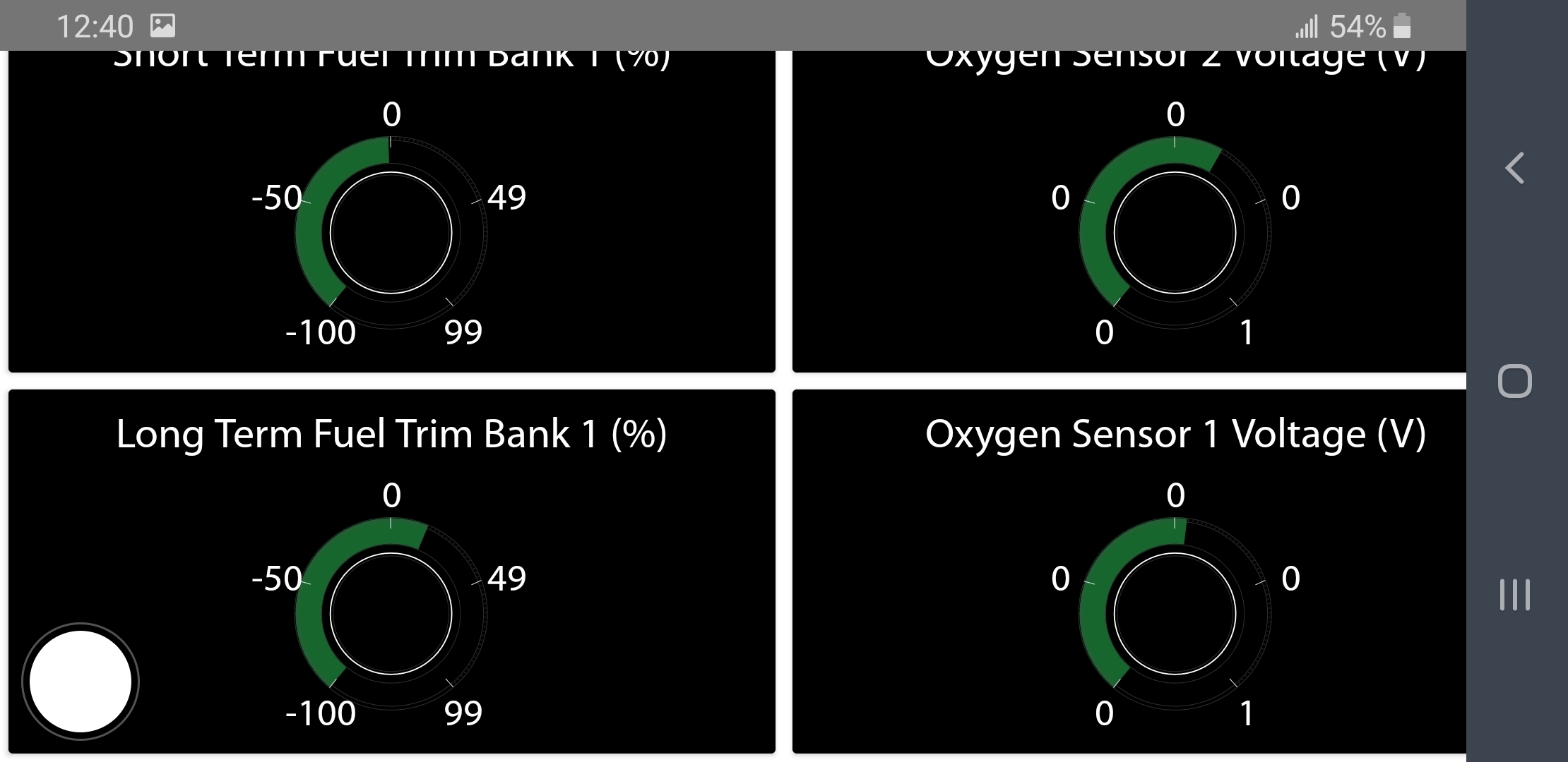

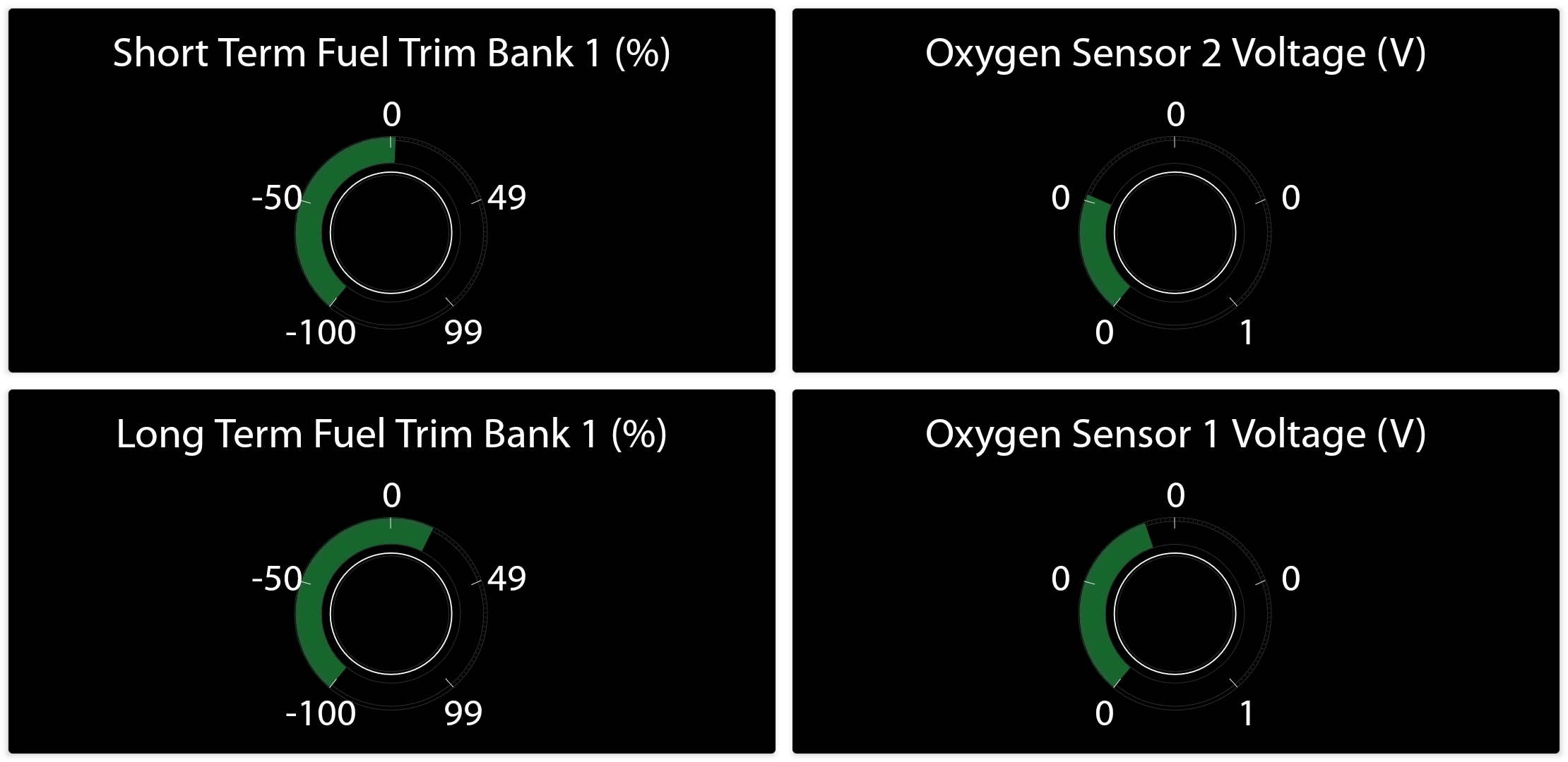

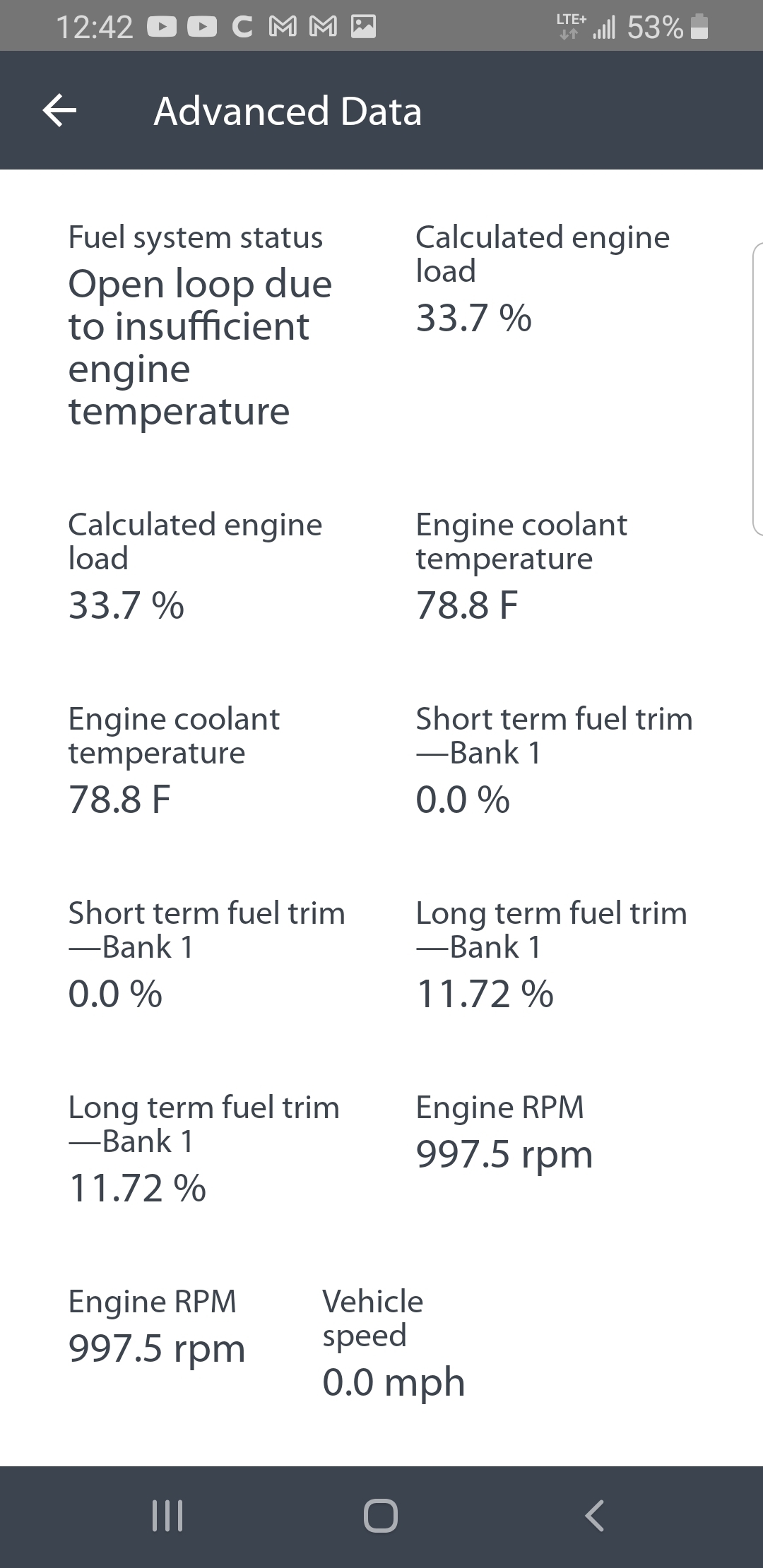

Here's the live data from today along with the freezeframe again hope this helps. 1st pic is at idle 2nd under load about 10 MPH 3rd at 35 MPH 4th at 40 MPH.
Sep 9, 2021 at 1:33 PM
Every pic shows -100 on the trims. The PCM is trying to eliminate the amount of fuel entering the engine. It's running very rich.
I have a question because I'm not familiar with your scanner. All the O2 voltages are in the 0 range. Normal voltages will be between .1v (lean) and .9v (rich). Do the voltages on the scanner vary or do they stay constant? Was the engine at operating temp?
An O2 sensor's voltage should cycle normally with constant frequency. An O2 sensor stuck at a fixed voltage (0 is what I see) is an indication of an open O2 circuit or lack of O2 sensor ground.

They only moved when I accelerated that gas pedal.
Sep 9, 2021 at 5:09 PM
JAKESJ408
  • 13 POSTS
Yes engine was at operating temperature when I took the screen shots of the live data.. I'm using "Fixd" as my live data source.

If there is no variation in voltage at an idle, it sounds like we have bad O2 sensors. It should show some variation in voltage at idle.

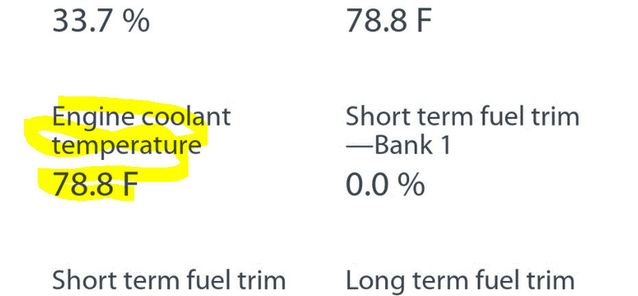

Next, and the reason I asked about the engine temp when tested, is because the last pic above indicates the engine coolant temp at 78.8° F. If the engine is warmed up and that is what it is signaling, the computer is compensating a rich fuel mixture when the engine is much hotter than it thinks. Thus, the rich fuel mixture.

That freeze frame is when the car first started and the code was thrown the engine was just warming up.
Sep 9, 2021 at 5:20 PM
Okay, that makes sense. At this point, we need to check the sensors. If they are not changing voltage signals at all, I have a feeling they could be the problem.
